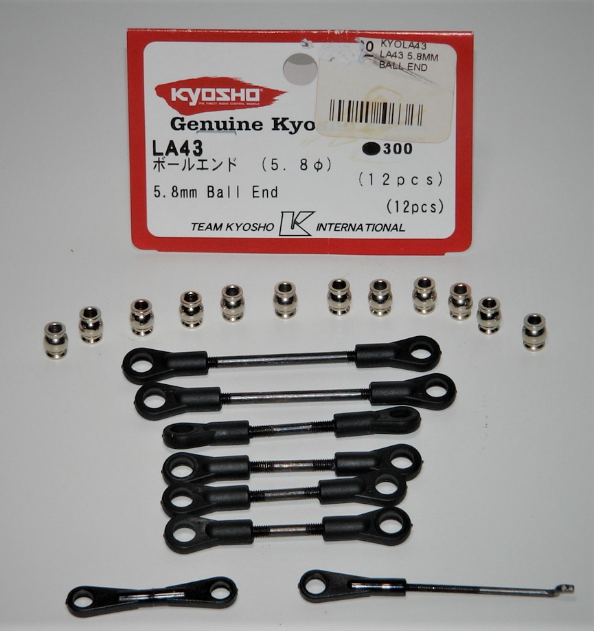

At any rate, new tie rod ends. Ordered a week ago :(
And I had some stainless 5.8mm rod end balls so they will be used.

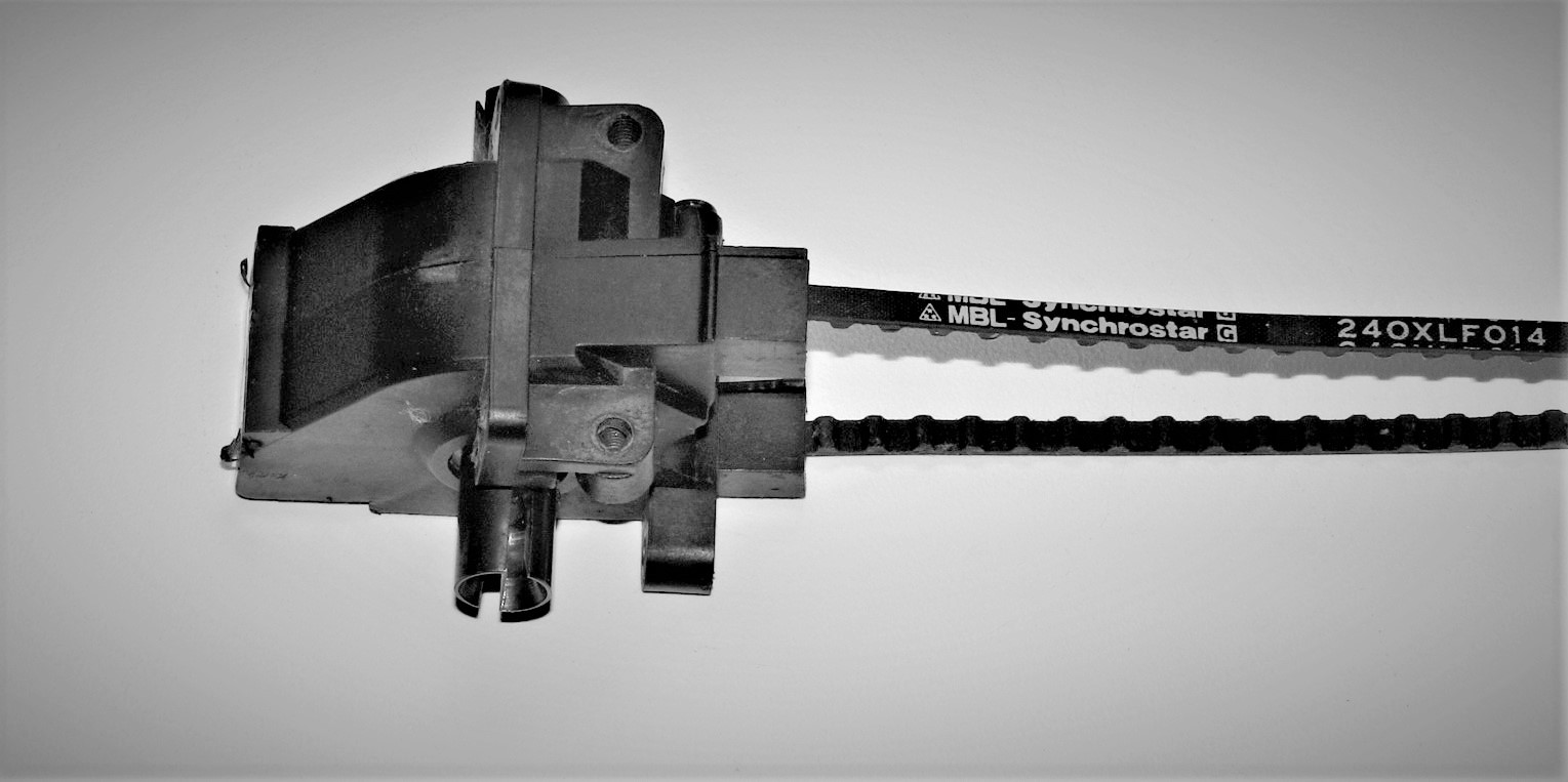

Put together the front diff with new gears. The gear set was actually cheap, so why not replace.
Cleaned and lubed the bearings first.
Then shimmed the side gears till there was little play with the pinions. Next adjusted the end play of the side gears to a minimum .
Then spun the heck out of one of the side gears with a Dremel while holding the other side gear in place. Reversed the process for the other side.
That seated the diff gears pretty good and almost made the action smooth. Cleaned , re-greased, re-oiled, installed the belt and screwed it together.
A small victory but one thing that always bothered me was a car running around sounding like a bucket of loose bolts.
The belt appears to be in fairly good shape and from what I understand is the better of the 2 belts that were available.

Wow...that's a lot of work to build the front diff. :shock: I never had the impression those were a major problem...and none of my Optimas, original/restored or modded, sounded like a bucket of loose bolts when running...especially not the belt-converted ones, that actually run pretty quietly. The chain-driven ones have the dinstinctive chain whine, but that's normal.
