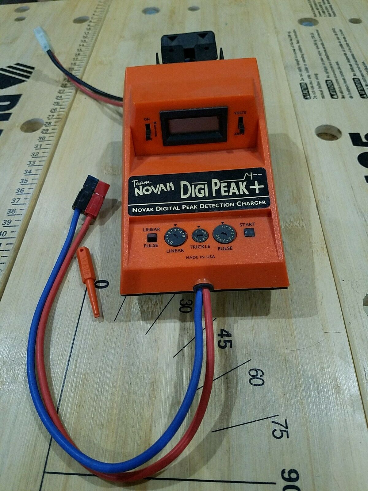

So, I'm reaching out for some help/input/experience from the group! All I know is Nicads and finding them in good condition seems like digging for dinosaur bones. I'm assuming the vintage electronics eliminate the Lipos and I'm fine with that for now...might move on to them later. My gear=1/10th On-Road pan car, Novak 410-M1c ESC, Novak NER-2x receiver, Futaba S-132h servo (once I find one or two..lol!) and Twister and Revtech modified brushed motors (13t thru 19t). Will be running only on prepared indoor/outdoor, carpet/asphalt, can am/oval tracks with run times similar to race conditions back in my days (ie. 6-cell 4/5 minutes). Prefer saddle pack style. I've added a pic of my charger...good deal at only $17 so no loss if I want/need to change/upgrade later . Any help/experience and insight on batteries to run would be greatly appreciated! Thanks!

You won’t find performance Sub C cells anymore, nor name brand even. You can source some generics off Amazon or eBay fairly reasonably but you know the numbers are a lie. I have had decent luck with Tenergy batteries from hobby king, and they have a 7.2v stick pack rated 4200mah for $18, and you can see the cells which at least in the old days meant there’s a good chance the way they are assembled you can “open” the shotgun tube and the cells can be reconfigured side to side. Saves time for sure. Worst case scenario you would need to solder them up into a saddle pack. For the money I don’t think you can beat it. Now for the bad news. The digipeak won’t peak em. You will want a more modern charger for nimh. I say more modern because lipo is king now, and even nimh seems ancient. A cheap ac/dc charger will run you $45 but will also allow you to charge lipo in the future as well as everything else

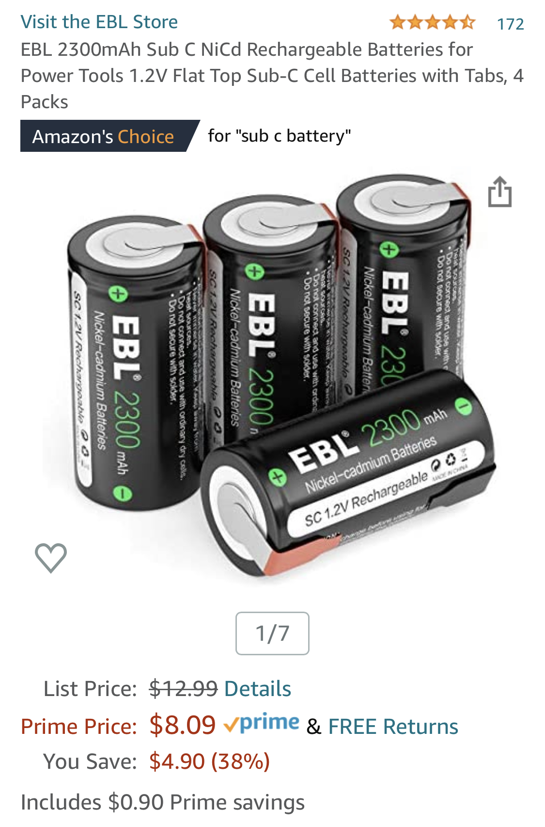

If you are set on using that charger, Amazon does have some loose sub c nicad cells. I’m pretty shocked actually.

Thanks GoMach....I've seen Tenergy and EBL sub C nicads in google searches. Been leaning towards buying a couple old sanyo nicad packs and buying some individual Tenergy and/or EBL cells to wire up and play around with. I enjoy wiring my own saddle packs anyway. It would be nice to give the old DigiPeak something to do and see if it still works...at least get my $17 out of it

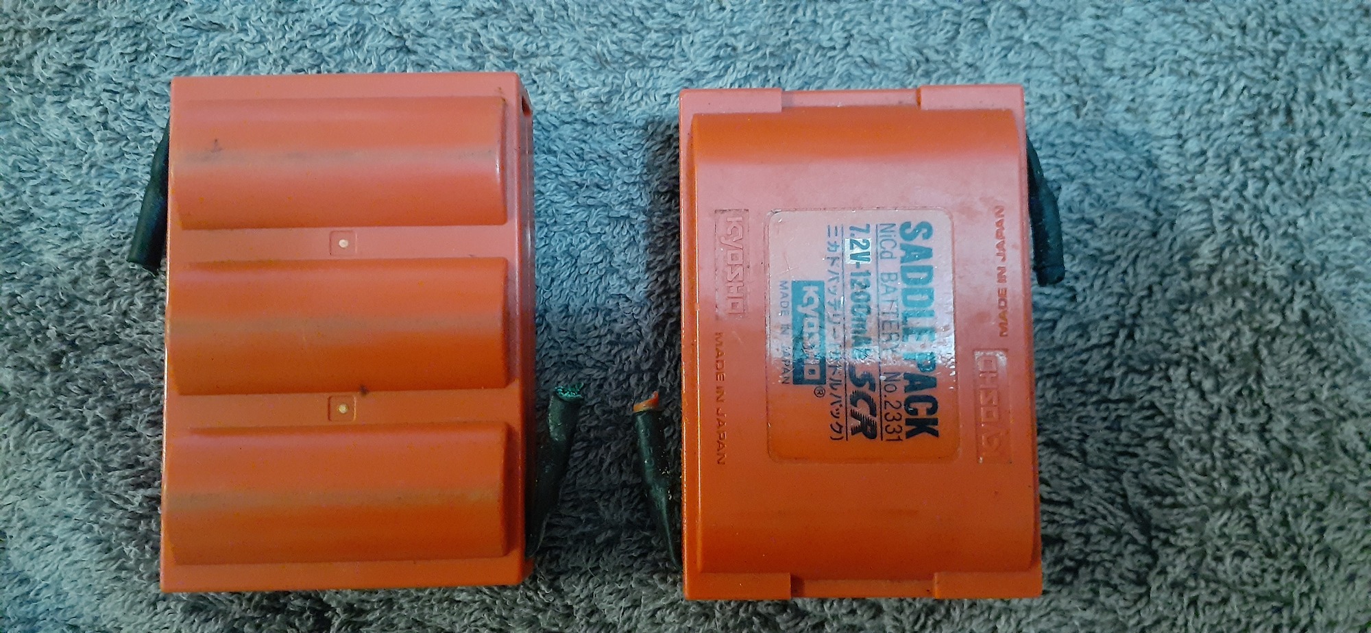

found these factory SCR saddle packs, pretty rare now.
I think i got them with my mates optima mid TOMS conversion kit way back in the 80's
They had yellow sce versions come out later as well but ive never seen one in person.
Cells are long gone internally, so will either repack with NiMh or preferably retrofit LiPo saddles inside the case
