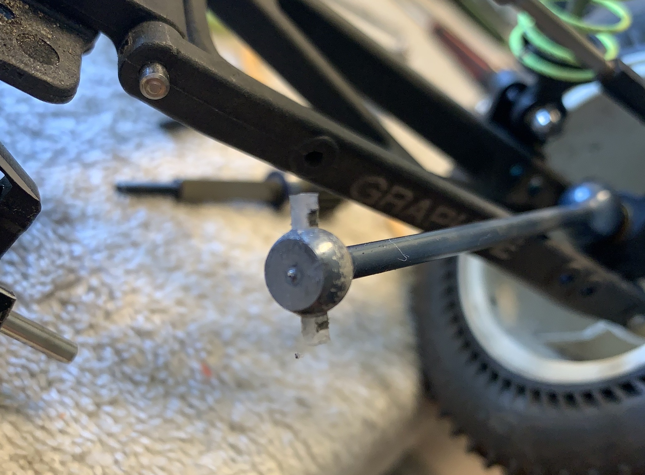

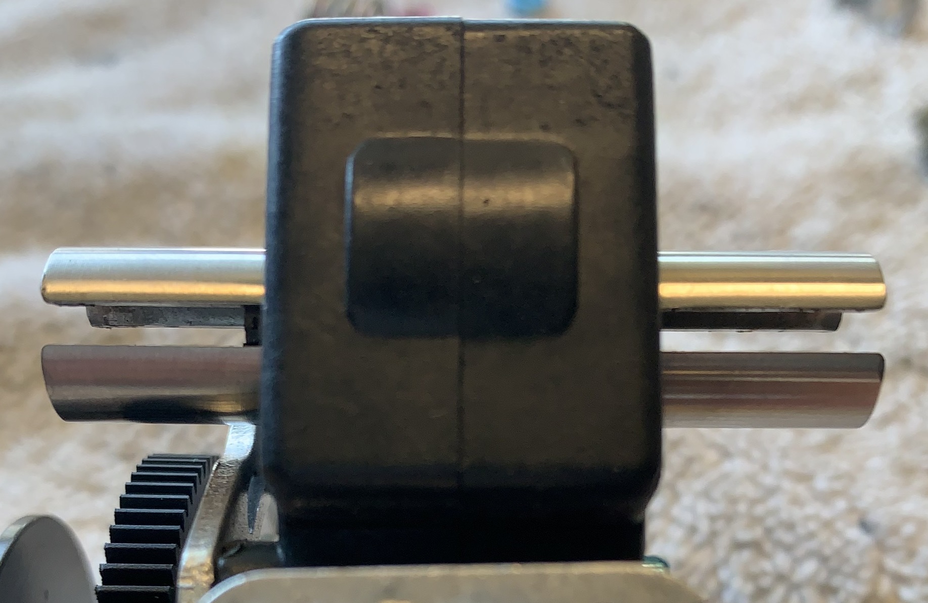

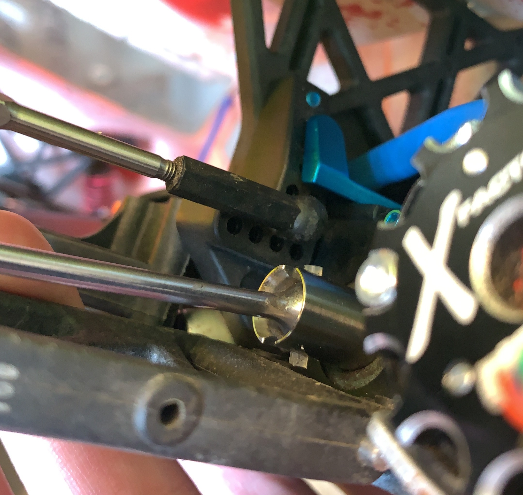

I am running MIP Aluminum CVD bones and Barracuda Titanium outdrives for minimum rotating mass. This is the lowest mass possible with a XXT setup. The MIP outdrives are steel and weigh more than the Barracudas.
To keep my Titanium Diff Outdrives from wearing, I chose to use a trick I read about from "back in the day".
1. Push the dogbone pins out using a bicycle chain breaker.
2. Chase the hole with a 3/32" drill bit at very low speed.
3. Cut a 1 inch piece of .095" Weed Whacker/Trimmer line.
4. Put a bit of CA glue on the line and slide it into the dogbone, let dry.
5. Then you cut the line down to fit. Too easy.
I have run this setup now for three full track days(2 hours track time), with no wear to the Titanium outdrives. I pulled the trimmer line out using a pliers, and redid everything above without issue. Ready for the track

Yes It is Nylon. The idea is that is doesn't hold up. You replace it just like MIP Pucks when they wear. I could experiment with stiffer plastics, but this is so easy and CHEAP to do.Coelacanth wrote: ↑Fri Mar 26, 2021 12:40 pm Isn't weed whacker line nylon? I wonder how that would hold up compared to titanium or steel? My guess is not too well, because you're always needing to feed fresh line through your weed whacker, just whacking grass.

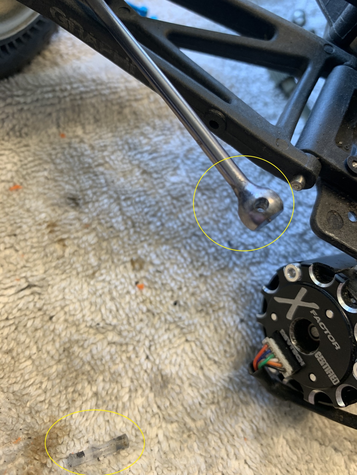

I've been running this at the track every Friday afternoon. I have gone four track days(40 minute run times each) and still using the same weed trimmer line without issue. It's at the point of having the same amount of slop as the metal pins. I love not having any backlash in the drive train, so I'll be replacing them again soon.

Update on the Nylon pins.
I've been running the same nylon pins for over a month, 5 track days x 40(2 batts @20min each) min track times = 200 minutes, no signs of them failing.
These ARE better than MIP pucks in my opinion. I'm going to do this mod to my other runner XX(T/4)s.
