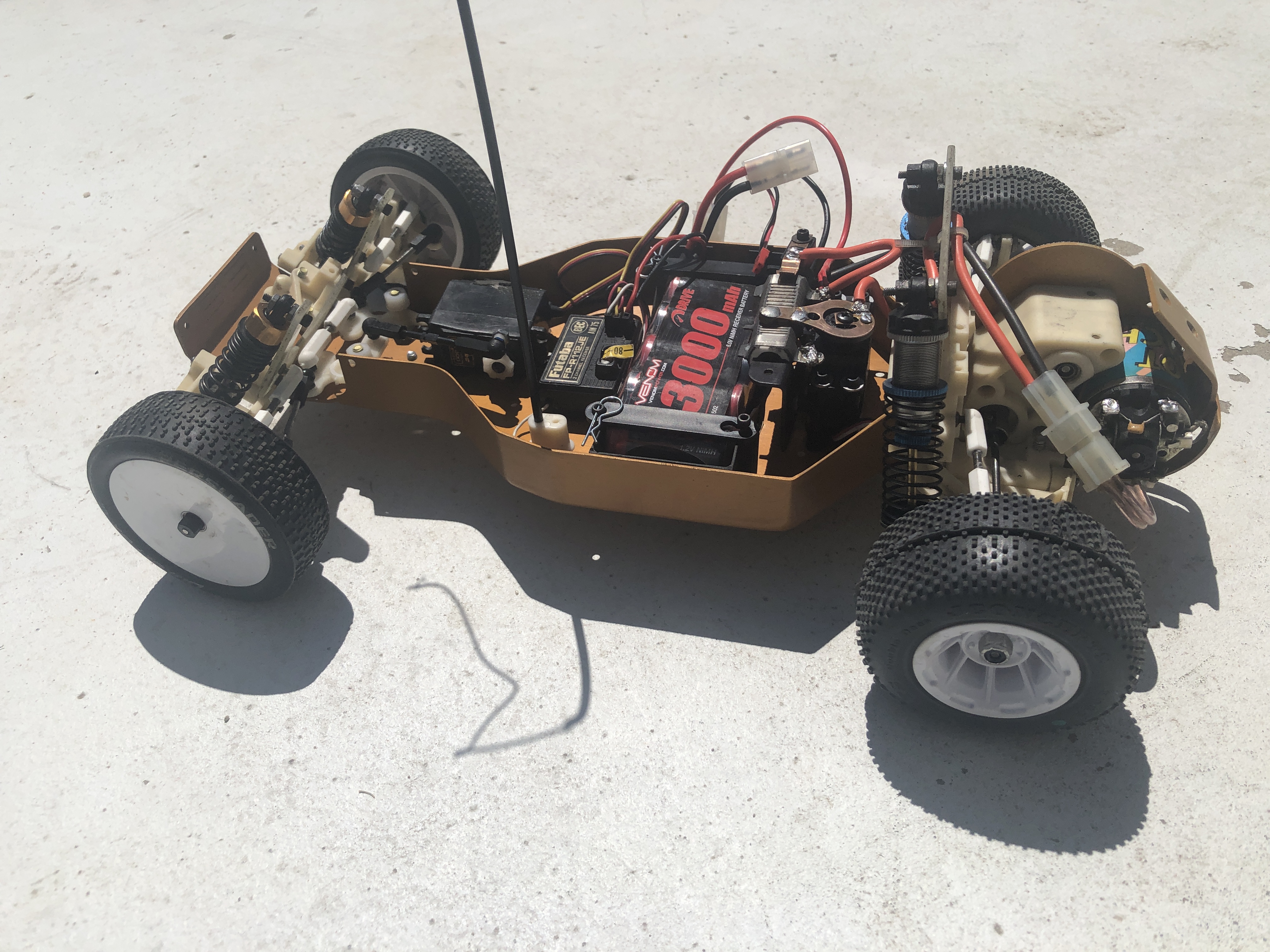

I just put together my second rc10 6 gear. My first was 3 decades ago.
I wanted to go original as I could. If money wasn’t an object I would have had an original MSC, bushings and the full body kit with driver and stickers, but all of that would have really increased the cost of the build.
It’s really a nice car to drive even with the mechanical
speed controller.
It still needs bearing for the front wheels, shocks, e-clips ,nose braces and A stamp wing tubes .
After my first project I think I am going to build and get things running ASAP before i go out and make multiple part orders.

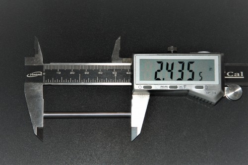

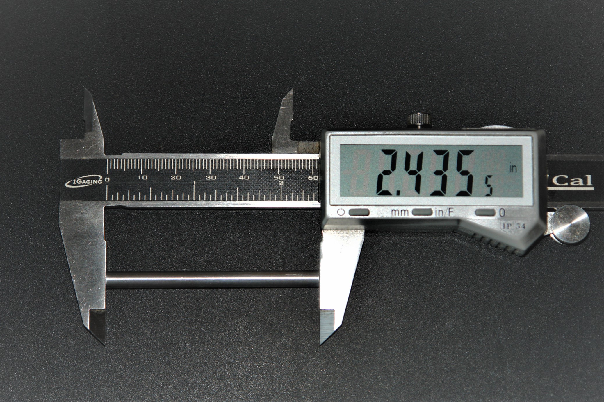

What is the length supposed to be for A stamp bulkhead wing tubes?
It’s way longer than the team car tubes for sure.
speed controller.

The same length wing tubes don't fit some bodies as well as others. I always cut them to whatever length fits the body best.
I see that you don't have nose tubes either. I prefer to make them shorter than the originals, leaving extra room around the servo and bellcranks.
I use K&S 83060 tubing to make mine (tapping it can be frustrating).
If you decide to buy the JConcepts nose and wing tubes, be aware that the wing tubes are the short versions and they aren't drilled through. They are tapped at each end (4-40) but are fairly easy to drill for the wire to pass through. I actually used a set with a early bulkhead by using 4-40 cap screws on the bottom to adjust the length and then glued them in place (required).

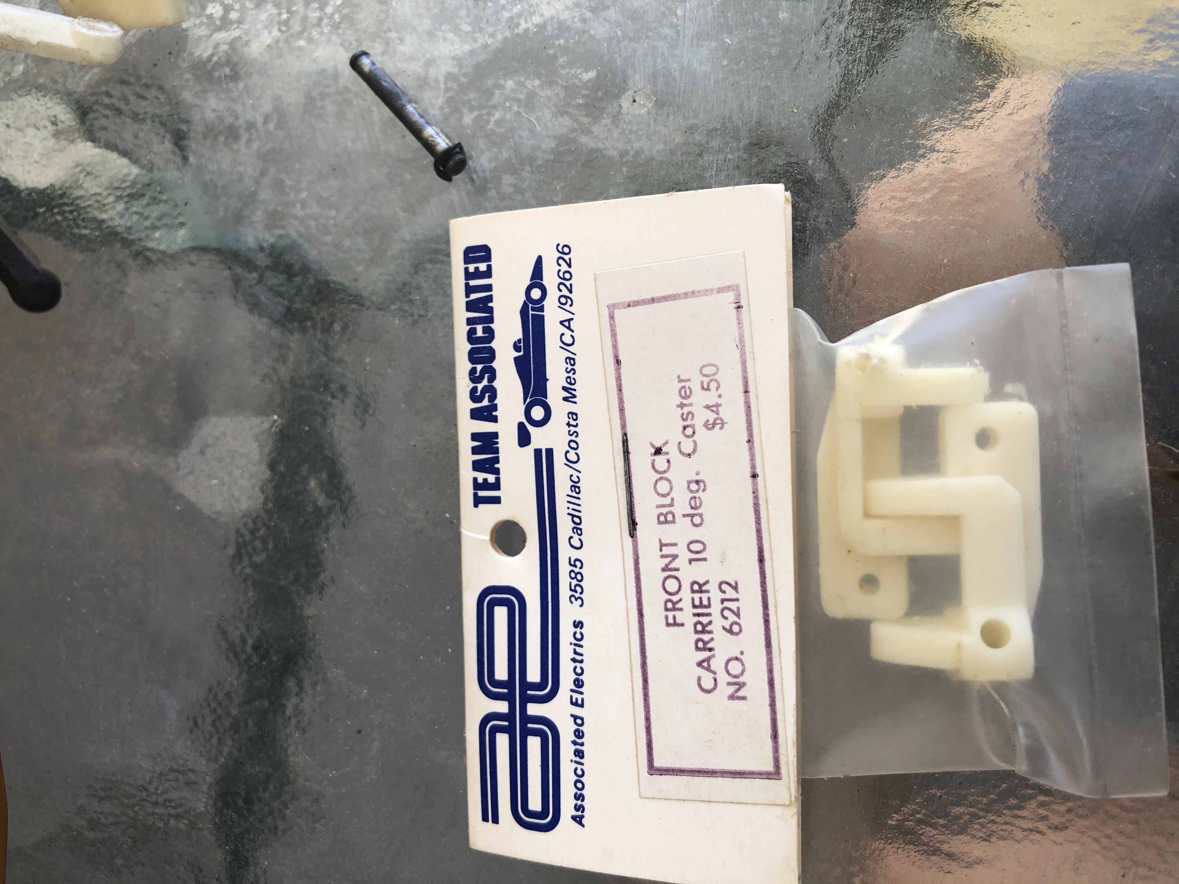

For absolutely no good reason I feel just a little bad for opening NIP parts.
