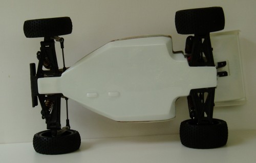

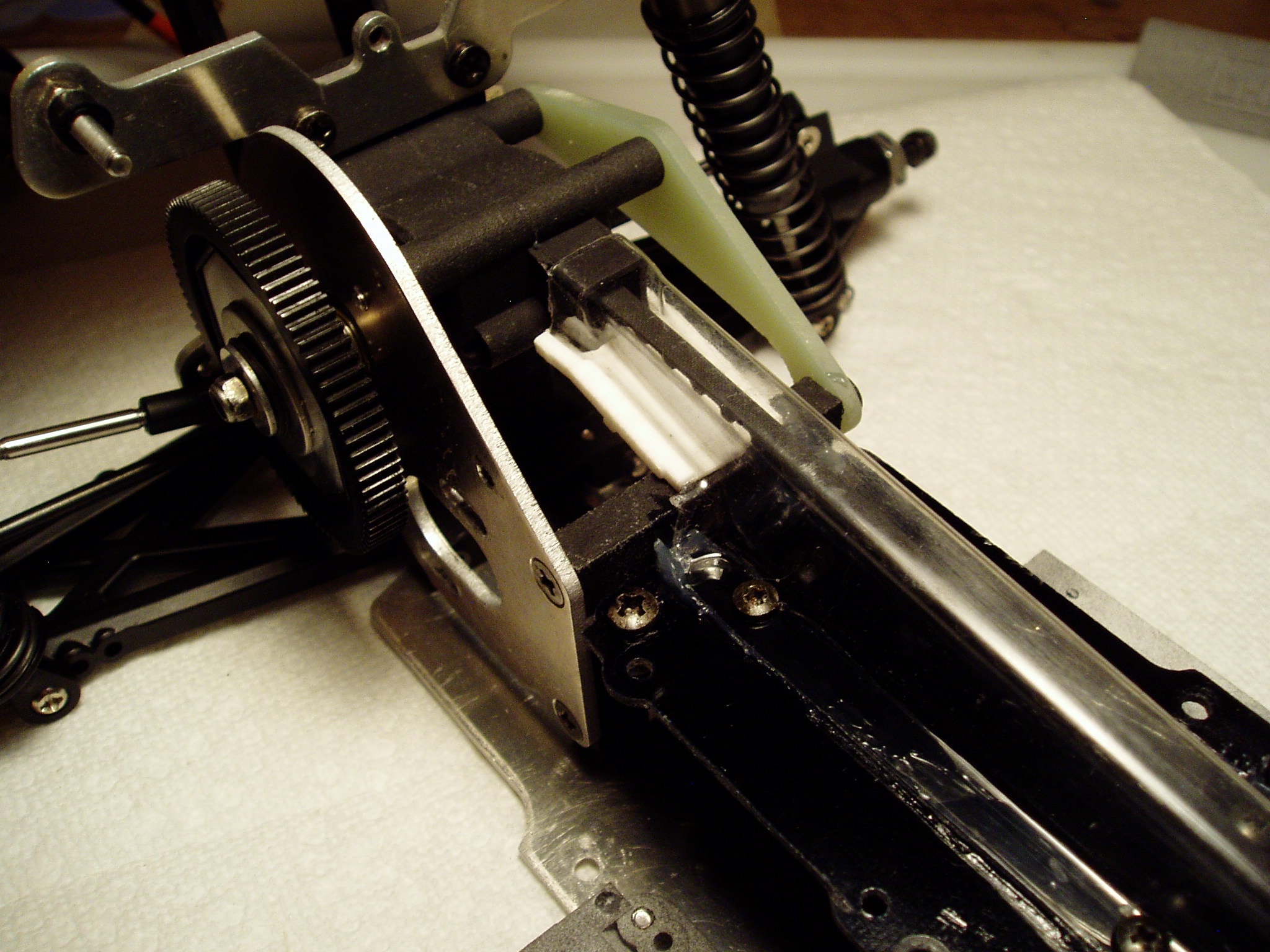

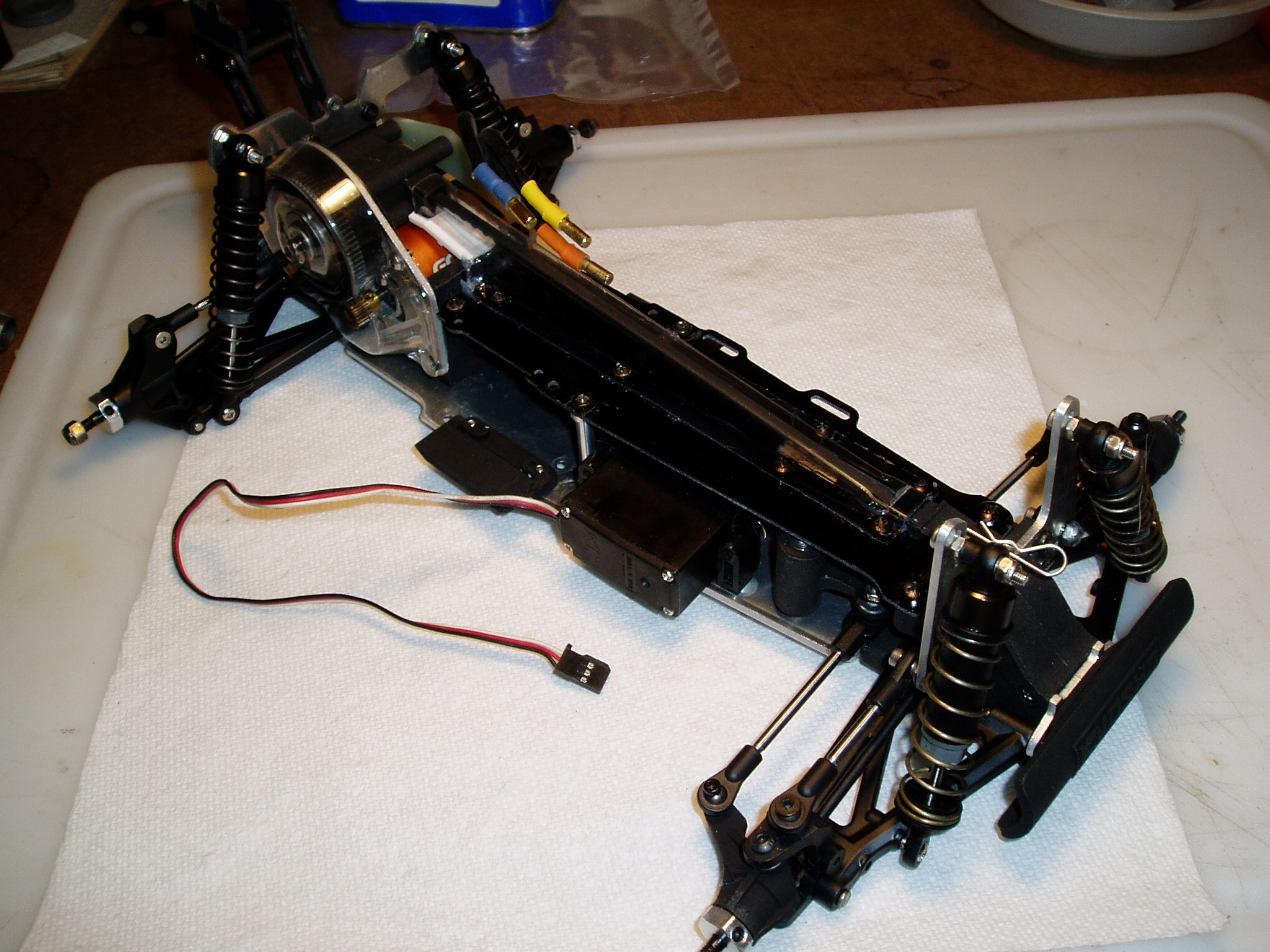

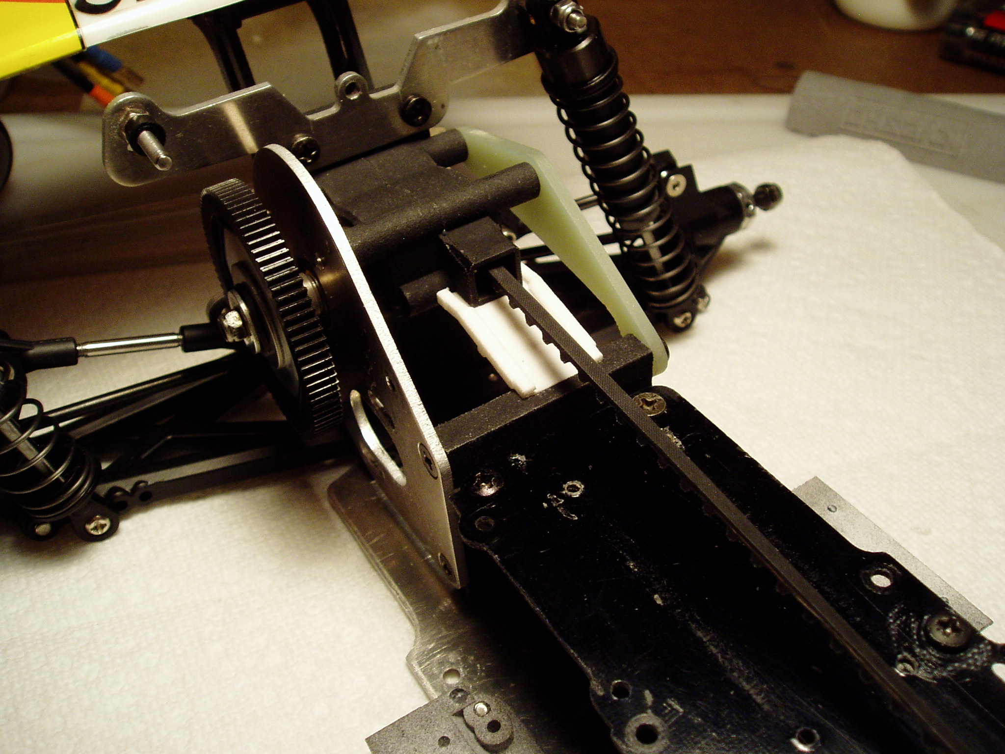

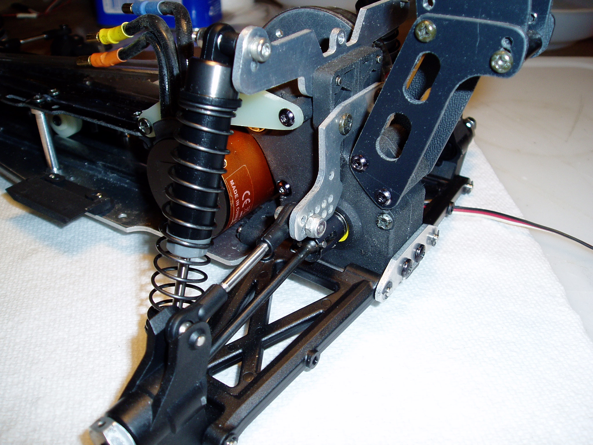

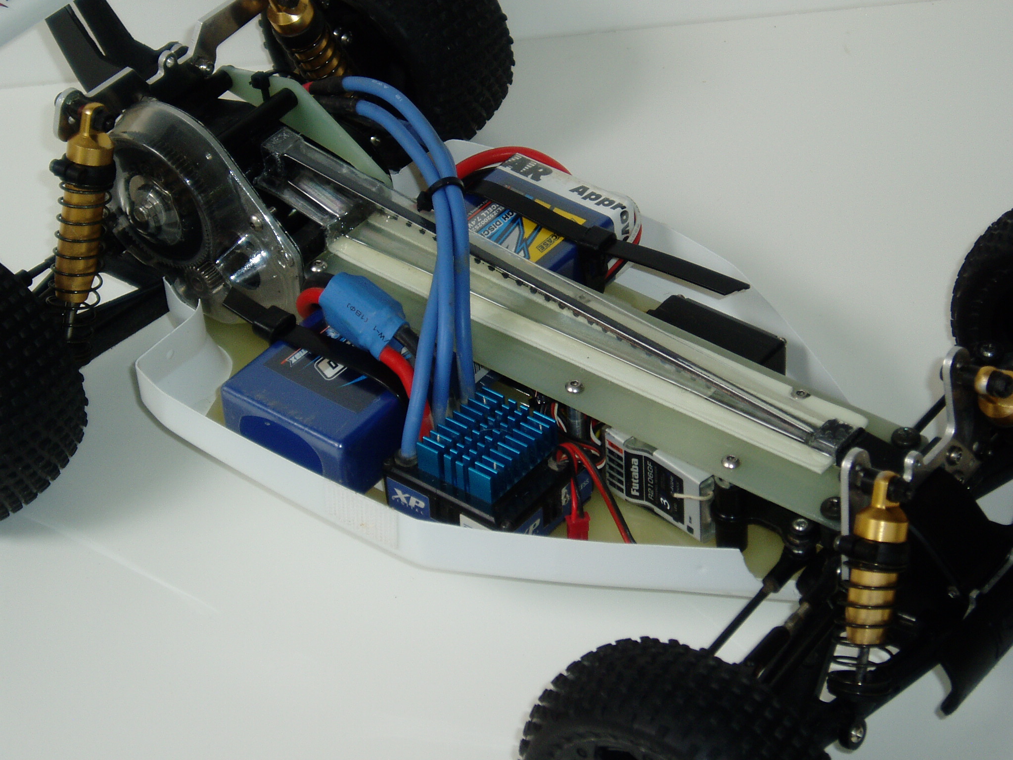

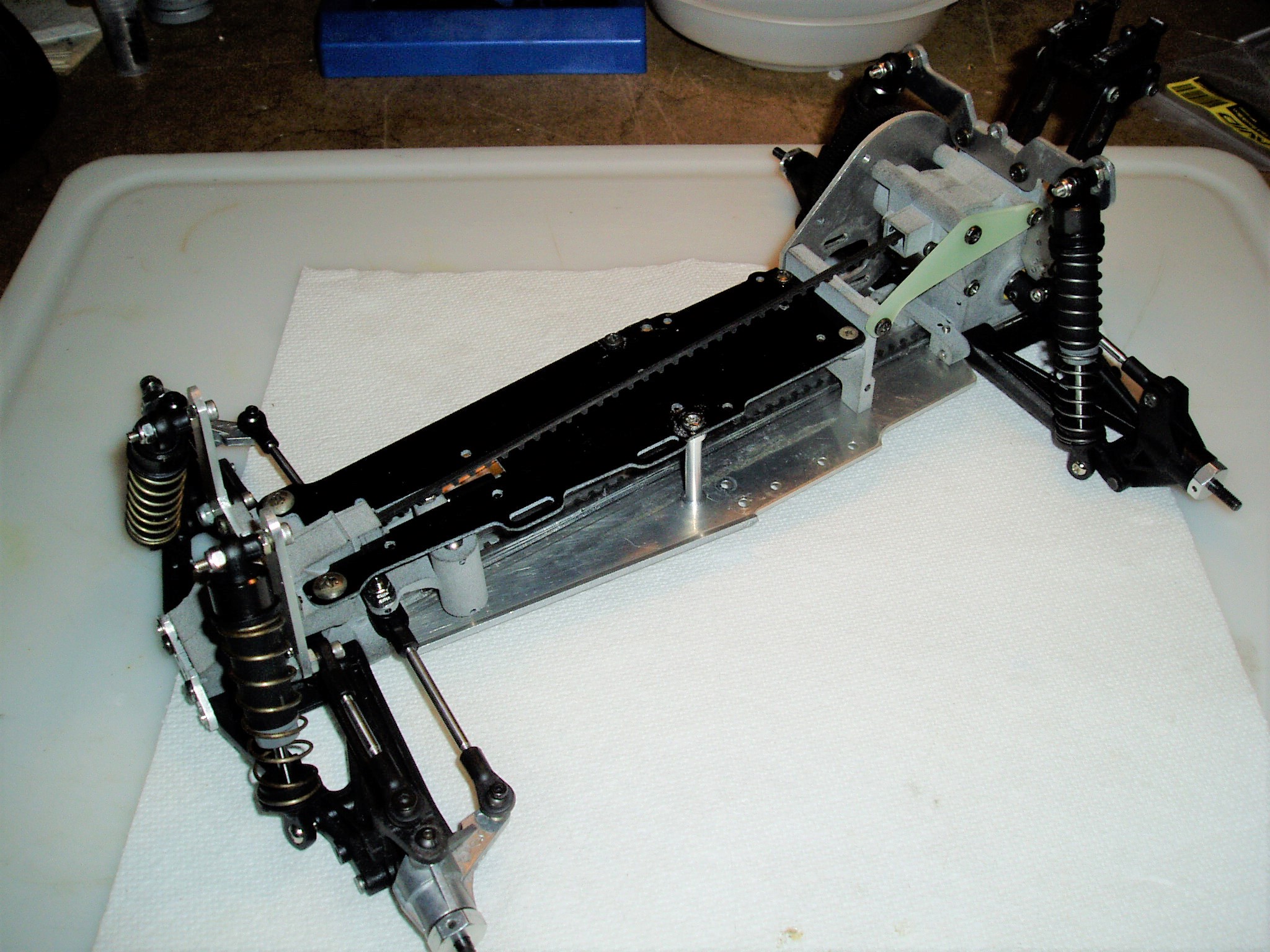

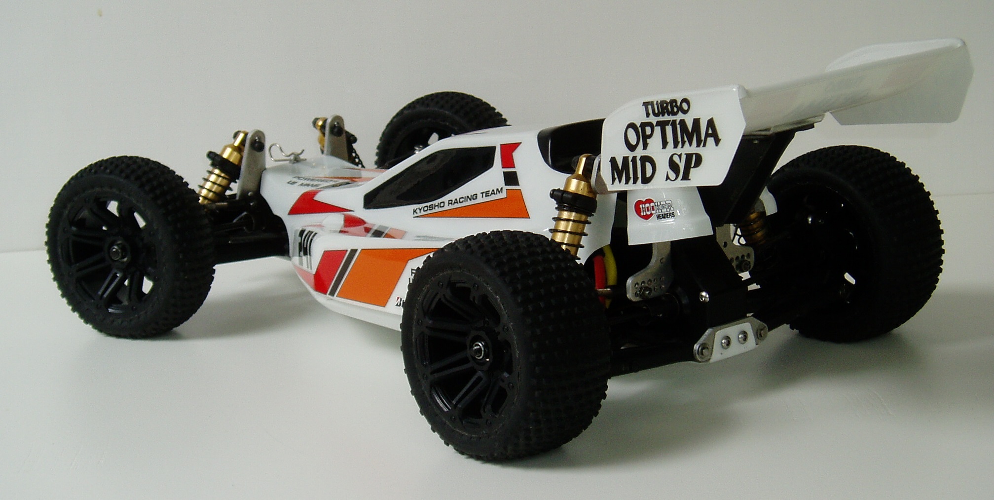

I still need to wire a switch to the ESC but otherwise the car is finished. The electronics are basically the same as before except I’ve replaced the XP SC450-BL ESC (45 amp) with an SC900-BL (90 amp).
In addition to the extended wheelbase and rear hub carriers from the re-release, I’ve replaced the front ball dif with a spool with one-way bearings. I have this arrangement on my CAT and I really like how it performs. We’ll see if this car reacts similarly to this change.

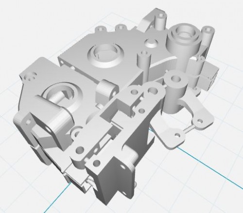

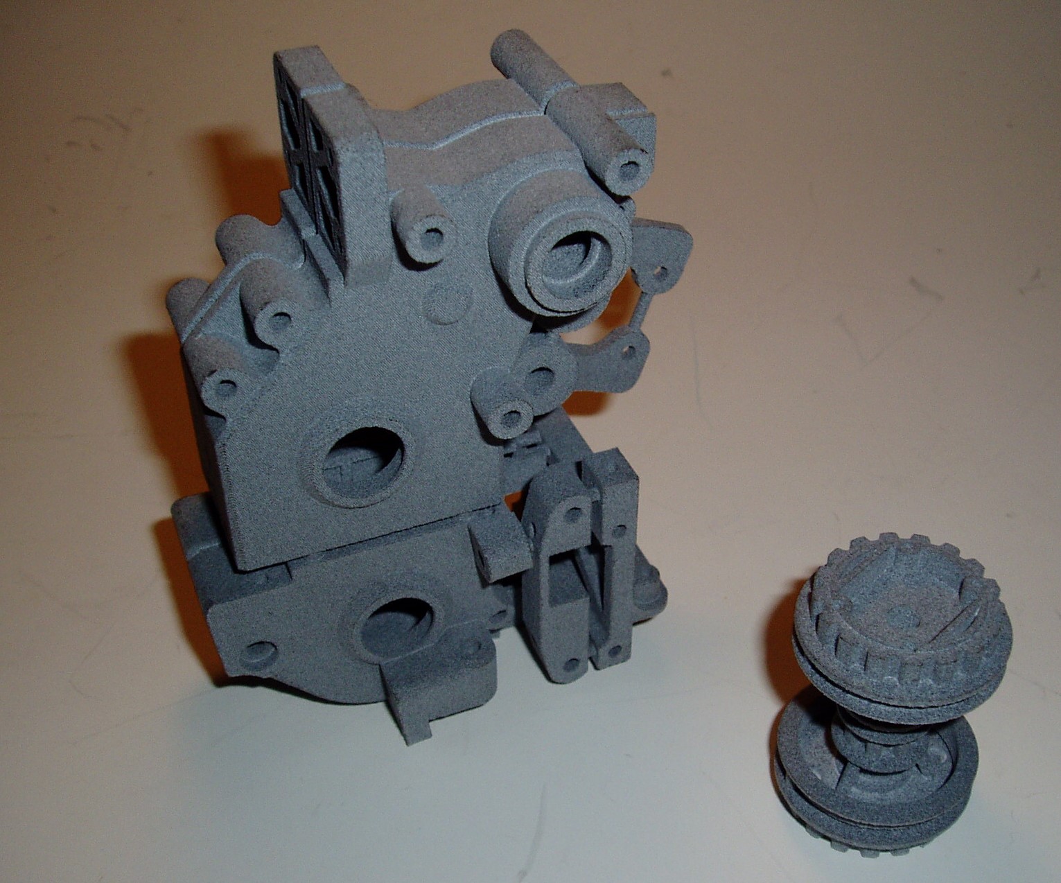

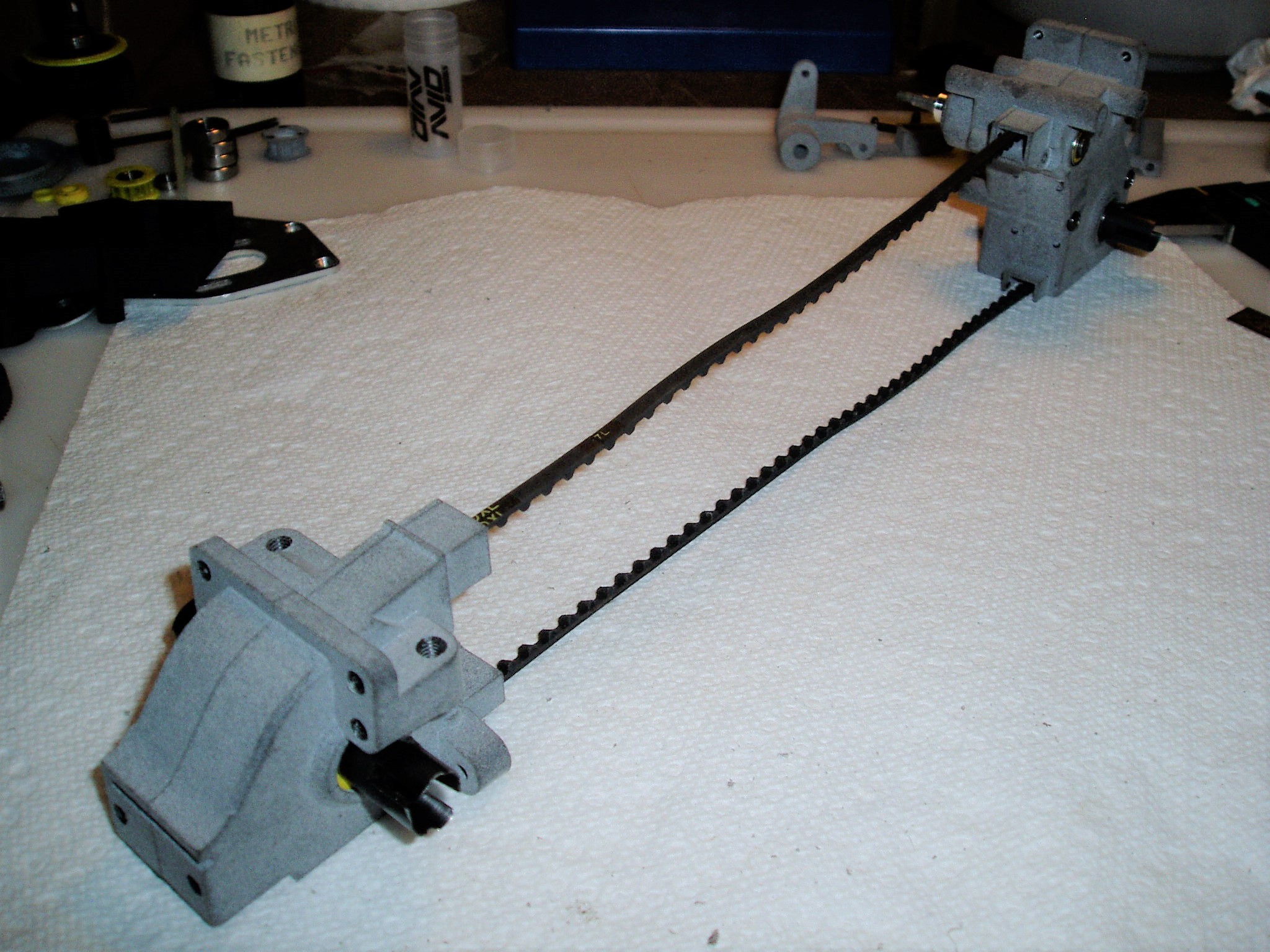

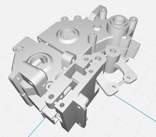

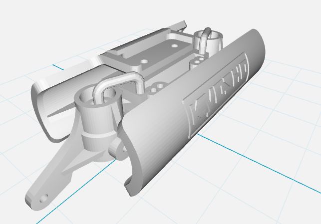

The plan this time is to build another runner car and I've just uploaded some part designs for printing -- for the first time. To date, every part I've gotten from printing services has been someone else's design so I'm new to the process. We'll see how this goes but so far, so good.
The first item on the order is a ball of Mid parts...

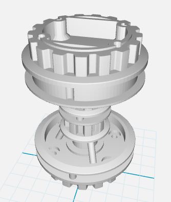

... and a stack of Mid belt sprockets that are designed to work with earlier chain drive diff cases. I had a set of the early diffs in a box so I want to try to use them for my Mid runner.
It has taken me only two attempts to fully satisfy the printer's design requirements. After the first attempt, Yurii contacted me about walls that were a bit too thin so I've had to correct and re-submit. I've just received confirmation that designs have been accepted, the parts are being printed and will go out on August 12th.
These parts are designed to run but if I have durability issues, my plan is to repair them and swap them with parts from a shelf car.
I'm fairly confident that Kyosho is working on a re-release for the Mid but who knows when it will become available and I'm tired of waiting. Many of the suspension parts from the re-re Optima will fit the Mid; the parts I'm having printed are unique to the Mid. The shaft sets for Mid transmissions are still readily available NOS from ebay and are surprisingly cheap.

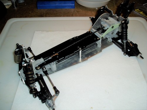

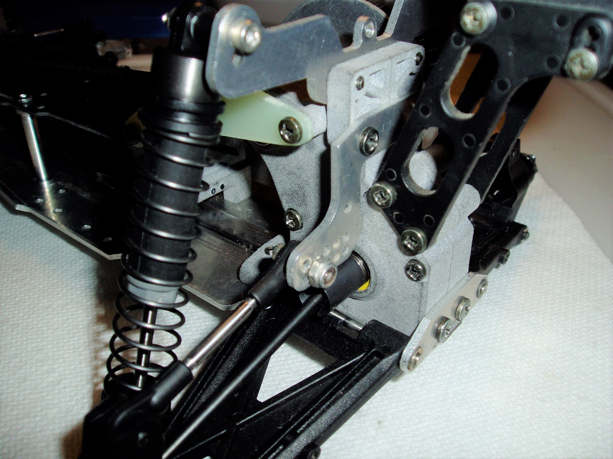

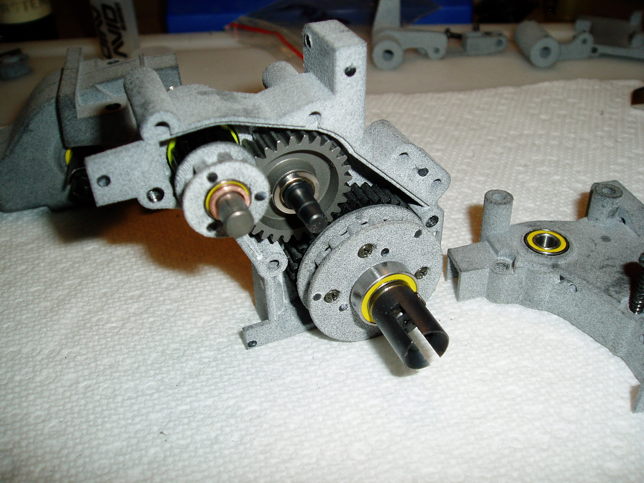

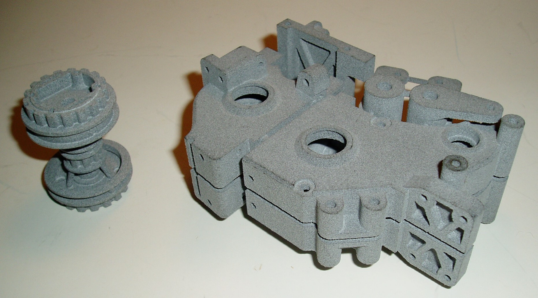

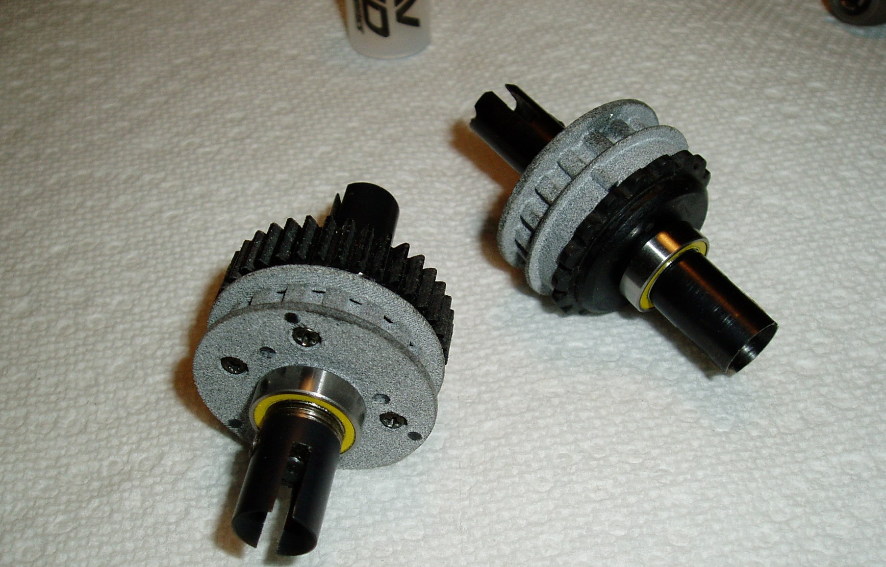

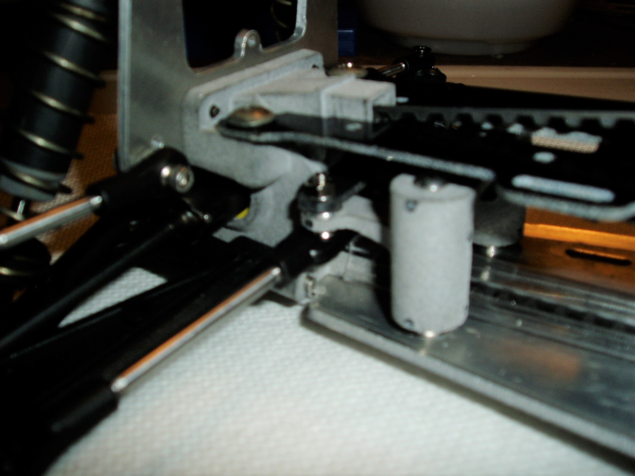

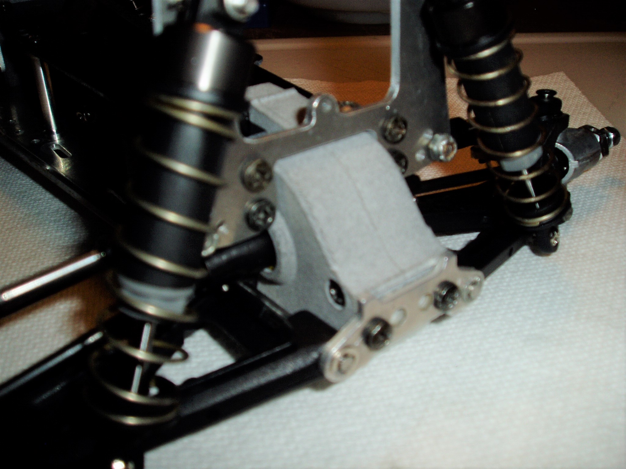

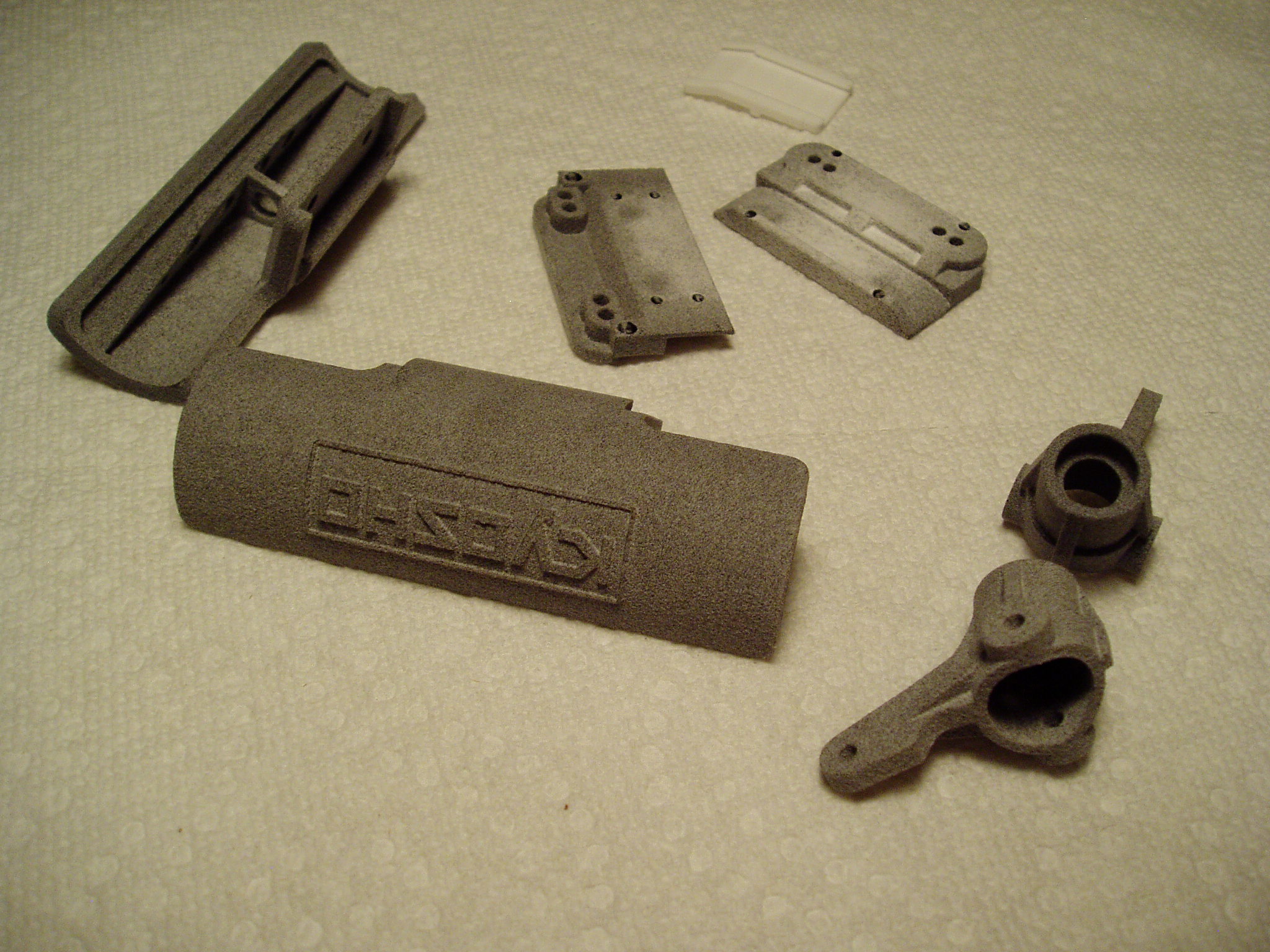

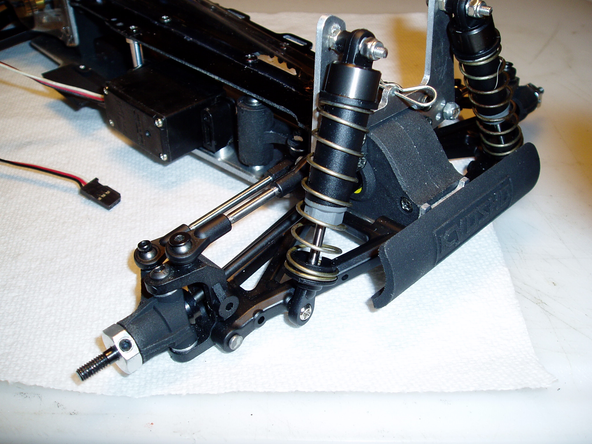

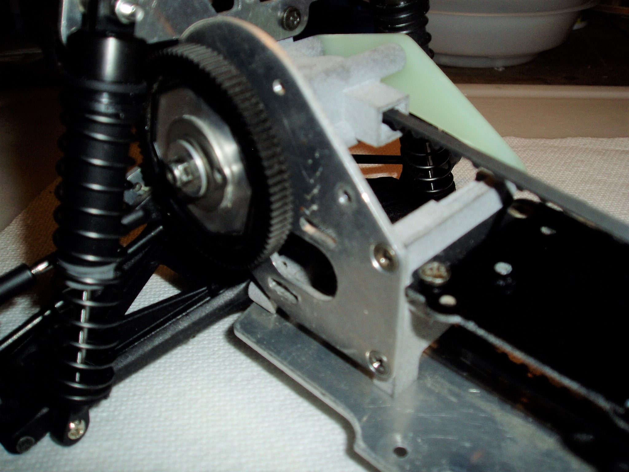

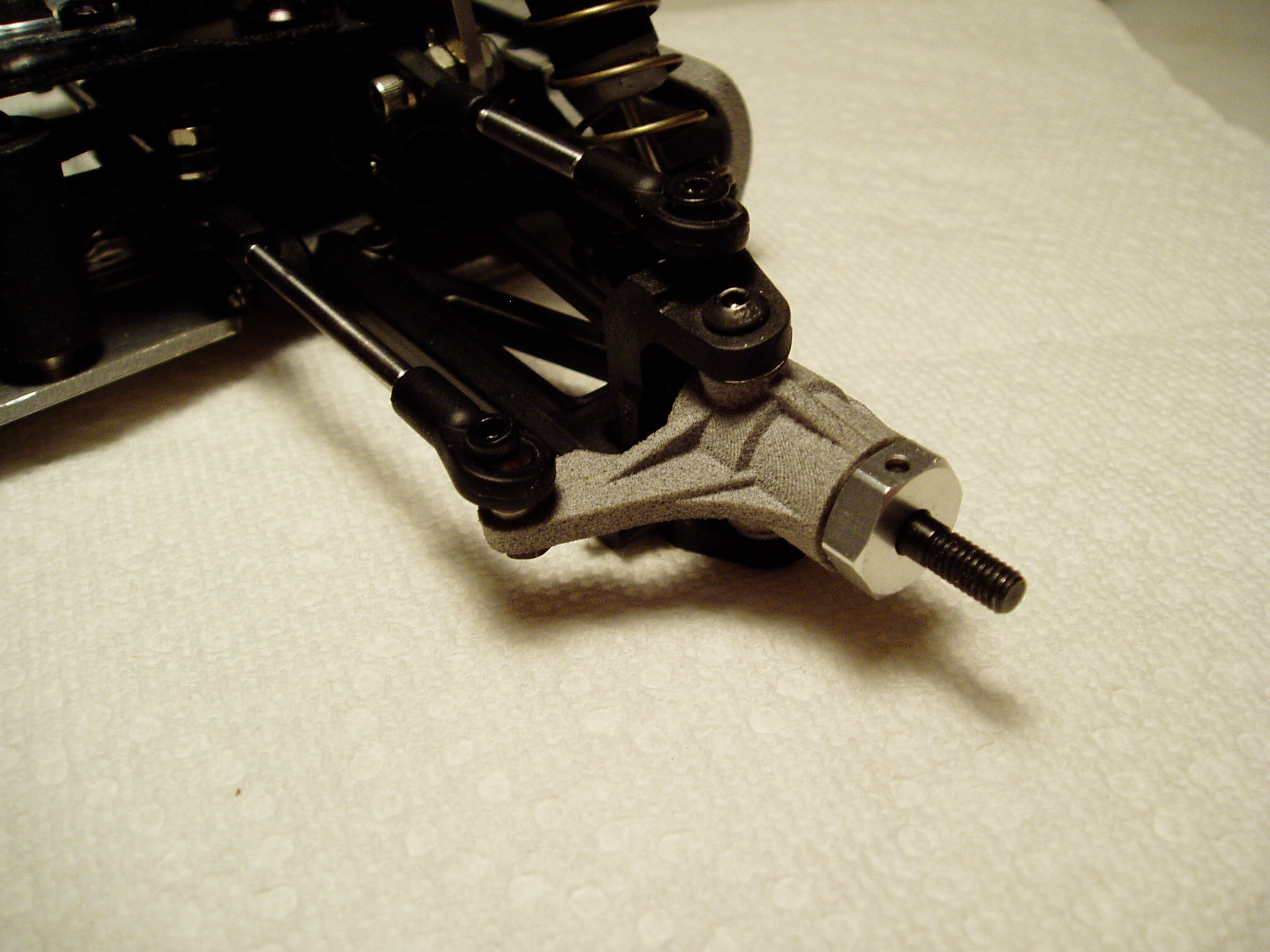

The parts arrive a couple weeks ago and I've spent some time over the weekend getting them separated, inspected, cleaned and the holes tapped.
Here are some photos taken during the trial fit.
Everything aligned and fit together very well, I didn't need to fight to get any of the screws to line up. The gear mesh is just about perfect - I was worried about that.
However, I did find that the bearings fit a little too tight. Not knowing which way to go with the design (i.e. will the material expand during the printing process and by how much, etc.) , I modeled the bearing bores to exactly match the bearing OD. I think perhaps that grainy surface texture has effectively added material and this explains the tight bearing fit.
Anyway, I was planning to make a special reamer to resize the bores but I found that a few minutes spent with a sharp xacto knife was enough smooth the surface and allow the bearings to snugly press-fit into place.
Like the bearing bores, the screw holes were a little undersize as well. Before running an M3 tap through them, I probably should have drilled them first but I just went ahead forced the tap through. I had no problems getting the holes tapped - this material is extremely dense and tough.

Great achievement ! Generally with 3d printed parts holes tend to shrink a little , with home FDM printers I tend to increase the diameter by 0.2.- 0.3 mm so where I'd drill a 2.5mm for tapping an M3 thread with printing I'd make a 2.7mm hole for an M3 thread , if I'm making a hole for an m3 to freely slide through I'd go to 3.5mm of course for sintered powder printing like Pro shops then the tolerances may be different but the concept is the same "holes close up a bit" , people tend to expect to re-drill holes on printed parts , it's nice when you don't need to but you mostly do

MarkyDents wrote: ↑Sun Aug 29, 2021 5:11 pm This makes me feel lazy![]()
Really is very impressive, I like the material they are printed in…. Looks very factory prototype like![]()
Thank you!
The gray/green color is only on the surface, beneath the surface the material is black.
Anyway, I agree about the material looking very unique and prototypical however I've found that it stains very easily and I believe after only a few minutes run time, it will begin to look really bad.
So, I've gone ahead and painted everything flat black to seal the surface and unify the color.
I guess one could apply a clear coat and preserve the color while sealing the surface but I didn't think of that until after I'd already painted the parts black.

Thank you Dadio.Dadio wrote: ↑Sun Aug 29, 2021 5:09 pm Great achievement ! Generally with 3d printed parts holes tend to shrink a little , with home FDM printers I tend to increase the diameter by 0.2.- 0.3 mm so where I'd drill a 2.5mm for tapping an M3 thread with printing I'd make a 2.7mm hole for an M3 thread , if I'm making a hole for an m3 to freely slide through I'd go to 3.5mm of course for sintered powder printing like Pro shops then the tolerances may be different but the concept is the same "holes close up a bit" , people tend to expect to re-drill holes on printed parts , it's nice when you don't need to but you mostly do![]()
This is exactly the kind of feedback and advice I was looking for. For the next set of parts, I will adjust the hole sizes accordingly.
As I mentioned previously, this was my first time having parts of my own design printed and I am very happy with the results.
This definitely won't be the last time I will use a printing service. It was relatively hassle free, the price was reasonable and it was very fast. I think was less than 15 days from upload to having parts arrive at my door step. I'm hooked.

The prints from Pro shops can be porous and stain easily , some shops offer a colouring service or yes painting them or sealing them in clear coat works just as well .

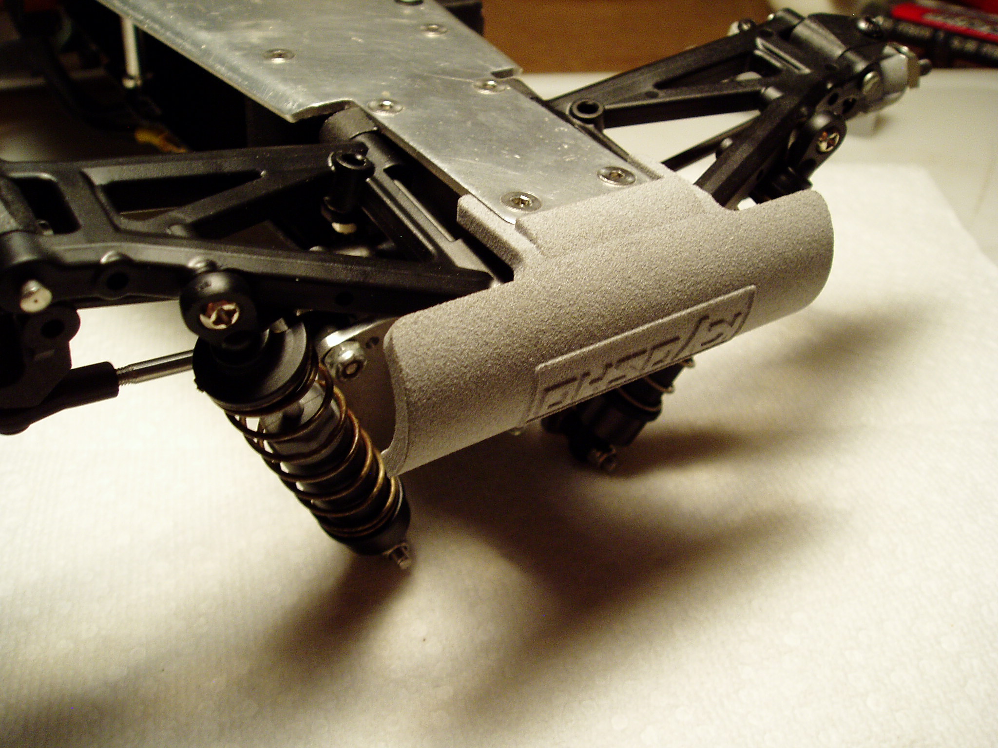

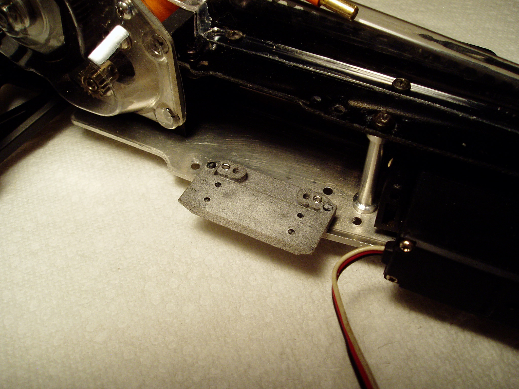

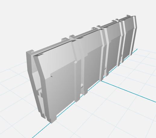

A couple new prints on order:
Bumpers, knuckles and battery mounts with flat tops so they accept a lipo.
And a gang of 8 belt covers that fit above the motor. The original part rarely comes up for sale and they are super expensive when they do. These 8 will cost me 13 bucks.
And that's really it for the Mid. Once these arrive, I'll have enough parts to finish the current runner build and re-assemble an SE that's been sitting in a box for a while.

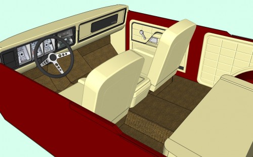

Next up is an interior for the Bronco. I have designed it for sheet styrene but I think I'll go back and re-design the dash, door and interior panels for 3d print.
I have completed the main tub from styrene and it was easy to cut and assemble. I have the dash parts cut from styrene but many of the parts are so tiny that it has been nearly impossible for me to assemble. Combining build techniques and materials is one way to achieve the highest level of detail and ease of assembly and at the lowest cost. If I'd had the tub printed, it would have been super expensive. Styrene is cheap.
I'm going to carve the seats from blocks of PVC - I think they'll look great after painting.

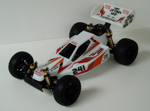

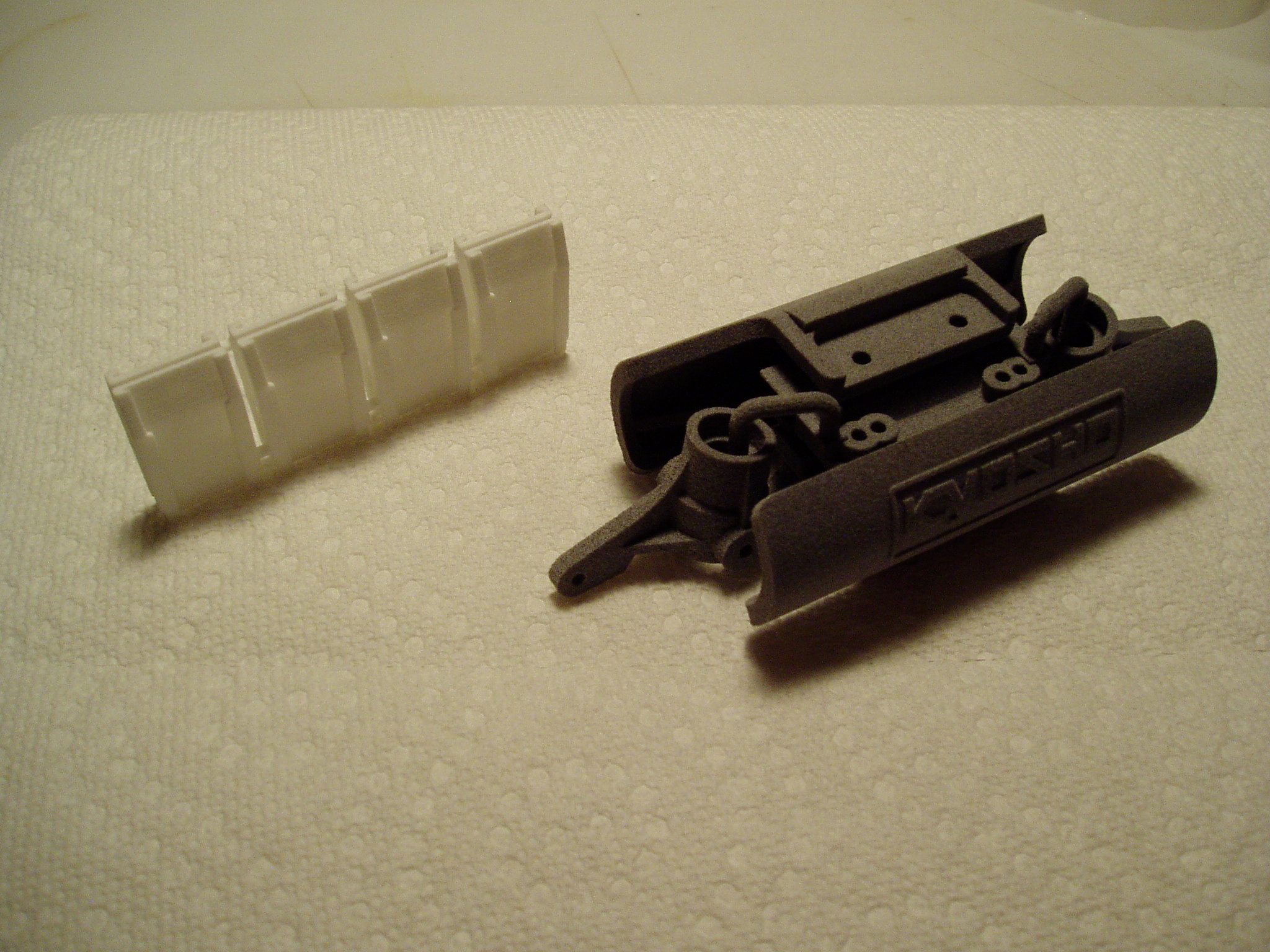

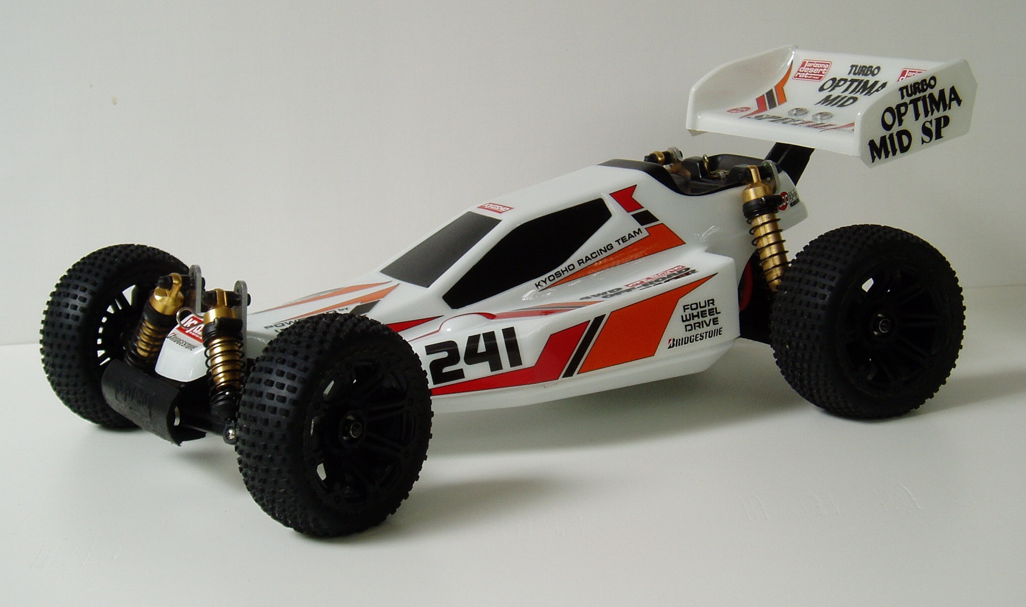

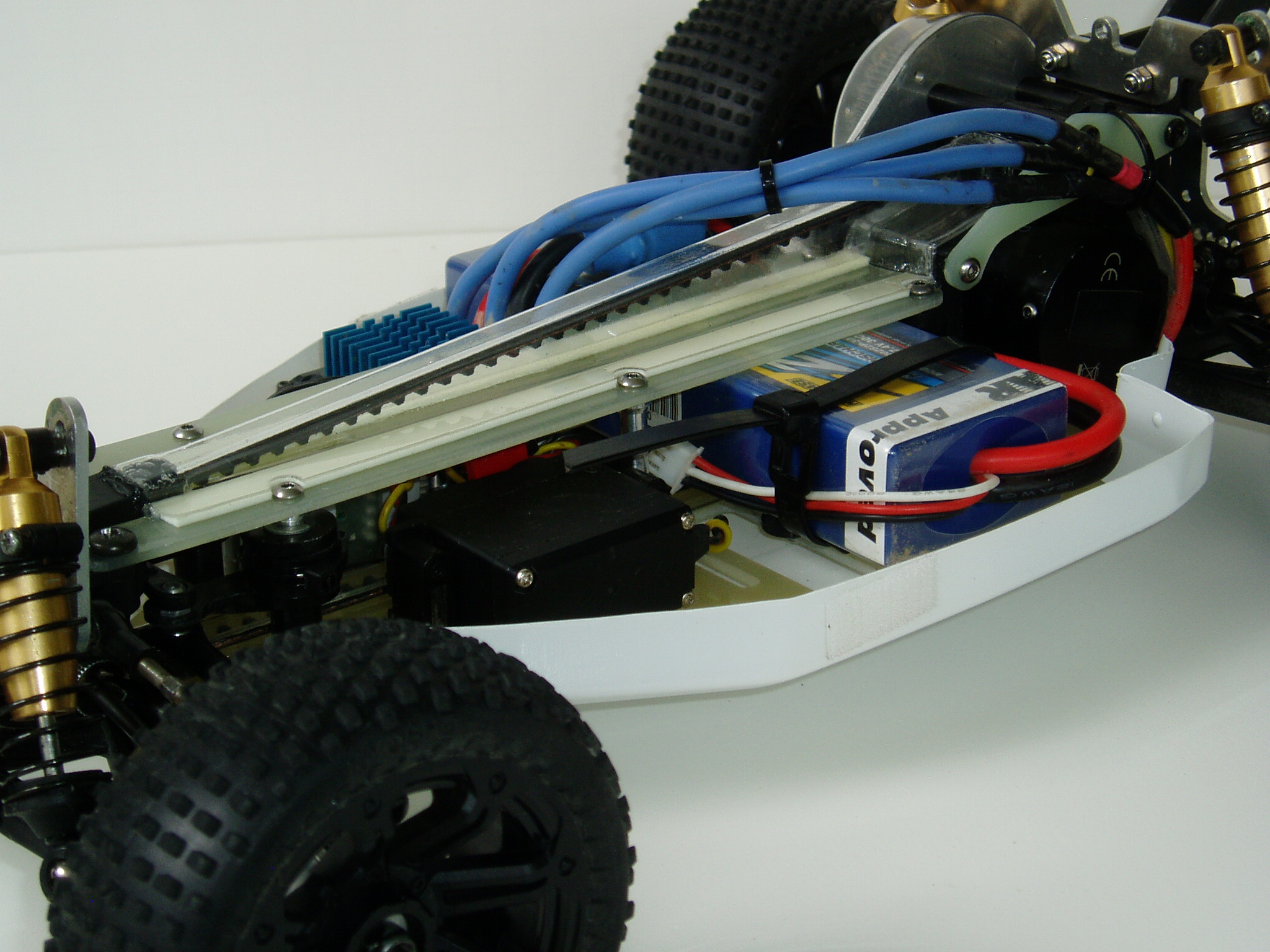

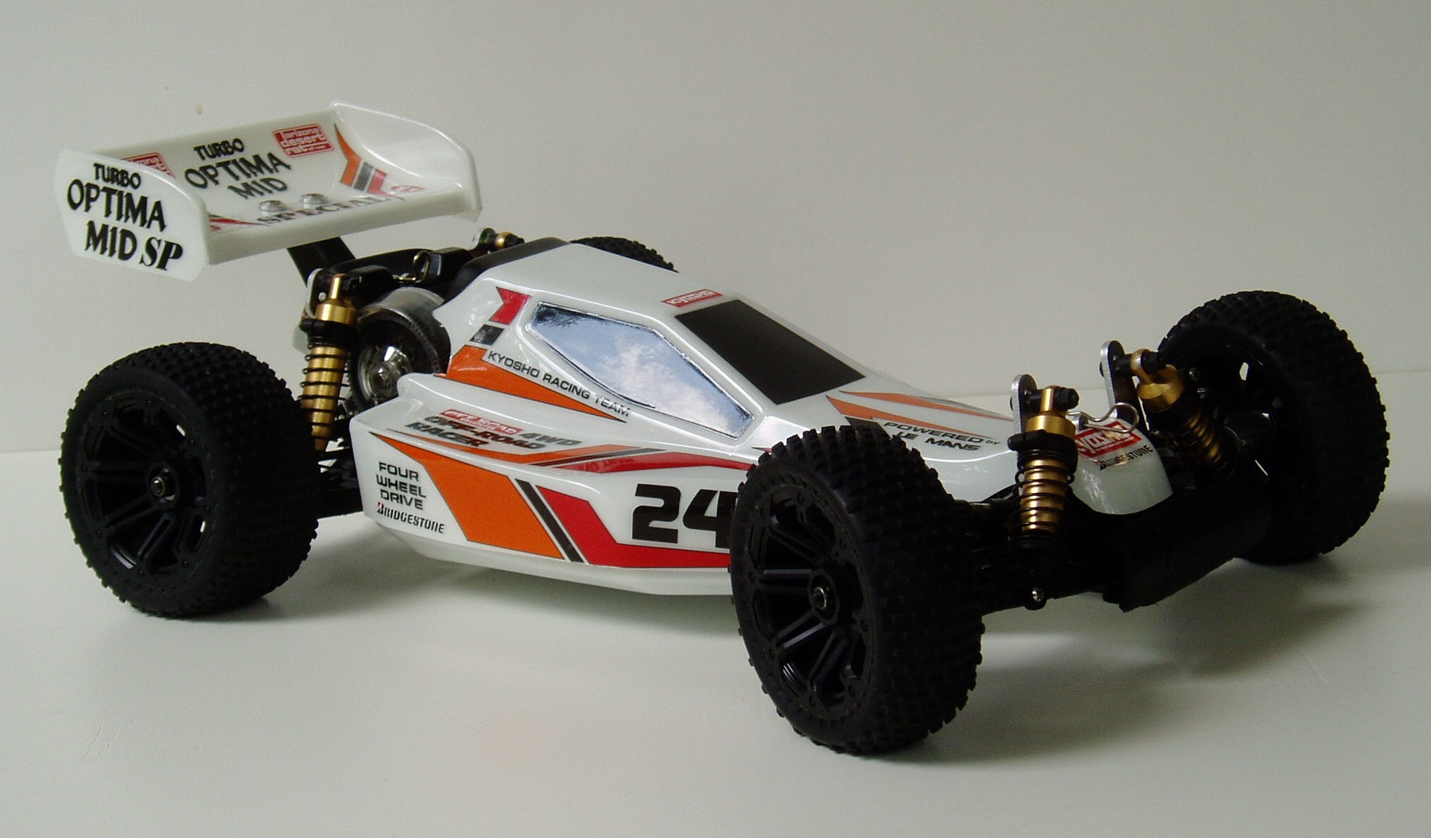

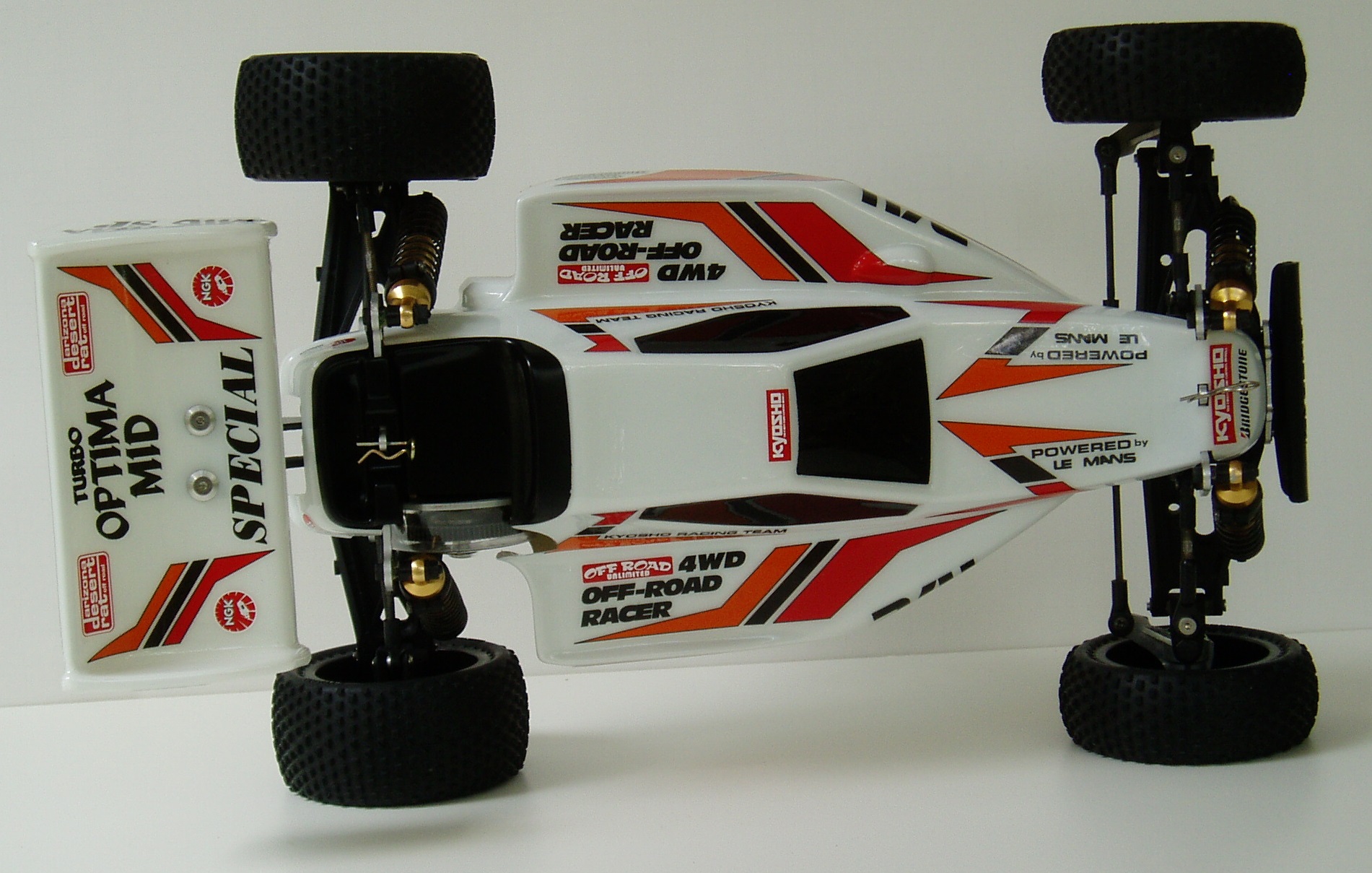

The last batch of printed parts have arrived and, as before, everything looks very good.
The only fitment problem came with the belt cover. Apparently, I’ve made the grooves that receive the lexan cover too narrow so the two parts wouldn’t come together. I was able to open the gap with some sandpaper.
Some final photos before adding the ESC and Rx, body and wing.
With that, this project has reached its end as I really don’t have plans to build or modify another Mid.
In addition to this car, I have two SE’s (one of them will be wearing a new TBG Turbo Optima Mid body shell and wing with MCI decals) and that LWB TOMS tribute car I built a few years ago. That’s enough for me.
If Kyosho is planning to re-release the Mid, one obstacle they will need to overcome are the belt covers. I don’t believe that in today’s RC world, adding thread lock to “seal” the lexan covers to the chassis plate is going to be acceptable. They’ll need to develop a smarter and more effective method for keeping dirt out of the drive train.

Re: Optima Mid Runner Budget Build to LWB conversion
Hi Doug
For a moment there I thought you shifted gears without using the clutch
At first it looked as though you replaced all the printed parts with OEM.
On closer inspection, I see that you dyed your printed parts black.
So I guess I'm sayin' it looks real good!
I'd be interested on a parts durability update maybe.
BTW what type of printing did you choose?
And is that small belt cover at the top of the trans one of those hose clamp mods or something else? It looks white and I've not seen a white colored clamp.

Thank you Chuck.
Actually, I’ve simply painted the parts flat black. Without fully understanding the thermal properties for the printing material, I didn’t want to risk overheating the parts in dye only to watch them dissolve. The material is already black and fully opaque below the surface similar to the OE molded nylon parts so maybe they would only need a few minutes in dye to color the surfaces – I don’t know. Anyway, painting the parts seemed like the safest path. By the way, the slight grainy surface texture reminds me of sand castings.
As for durability, I guess we shall see. Most of the parts include very subtle design changes meant to increase their strength – they’re not exact copies of the molded part. The exception being the knuckles; they are nearly exact copies of Kyosho’s die cast metal parts so if anything breaks, it will likely be the knuckles. However, this material is extremely tough so maybe there’s some hope. If they do fail, I can always go back and enhance their strength by increasing thicknesses, adding gussets, etc. Admittedly, my little backyard track isn’t the best venue for durability testing – assuming I can void the trees and corner posts on the deck.
The print material is HP’s Multi Jet Fusion polyamide from i.Materize. I could have chosen Shapeways (they offer MJF plastic) but i.Materize is cheaper and they can accept Sketchup models in their native format. Shapeways won’t accept Sketchup models without first being translated to a generic 3d model format (DAE, OBJ, STL, X3D, X3DB, X3DV, WRL, 3MF, STEP, STP).
For the belt cover, while using the rubber insulator sleeve from a clamp is an excellent idea and should work great, I wanted to test a printed version of the original part first. The material I’ve chosen here is Selective Laser Sintering polyamide because its greater flexibility and ability to capture very fine details make it better suited to this part. Also, high strength really wasn’t a requirement for this part; SLS isn’t as strong as MJF. By the way, the Bronco interior parts I wrote about earlier will also be printed from SLS polyamide for the same reasons.
It could be a while before I’m able to hit the track with this one (too many projects underway at the moment) but I will definitely provide updates.
