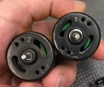

The brush end bell looks like a Trinity, the can also looks just like a Trinity monster horsepower in finish.

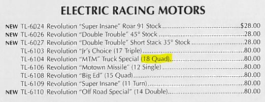

Note the Superstock 28T v 27T change in these two adverts:-

One thing I forgot to mention is that they carried on selling the Dry magnet range after the Wets were introduced into the line-up, as you can see from that last advert.

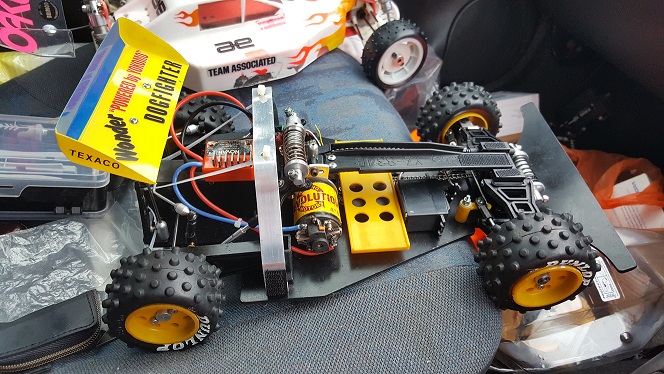

I recently bought a car that has a Revolution motor installed, and this thread has been mighty helpful. Once I get into that project, It'll be neat to get a better understanding of which version it is.

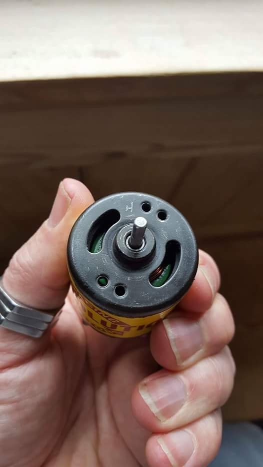

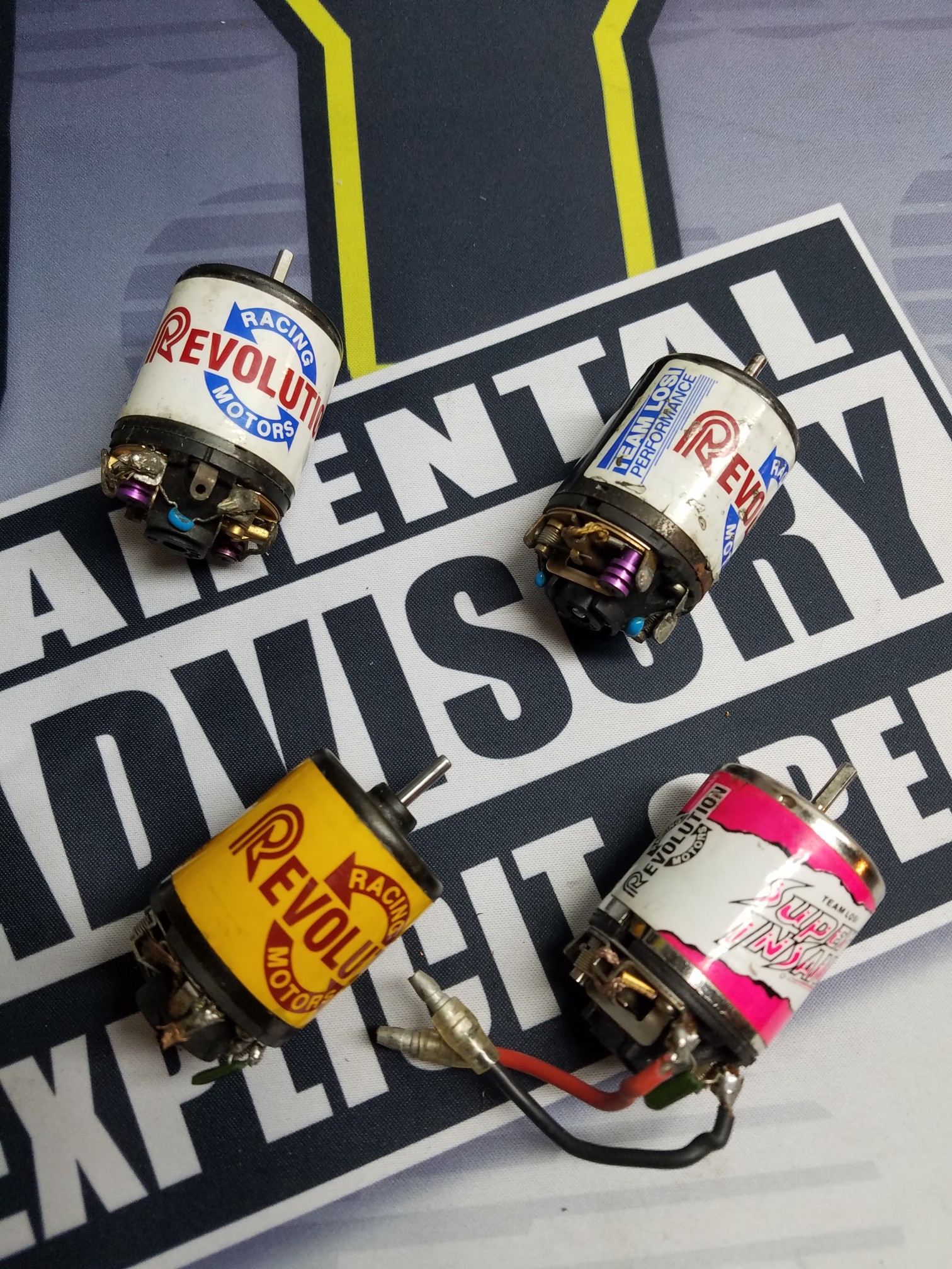

Here are a pair of Revolution Insane 15Doubles.... one of which I have purchased very recently. Note the 'I' etchings. Obviously these are in the Dry Magnet early non gold fin Yokomo format. I have wanted one of these since around 1988!

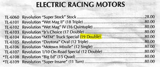

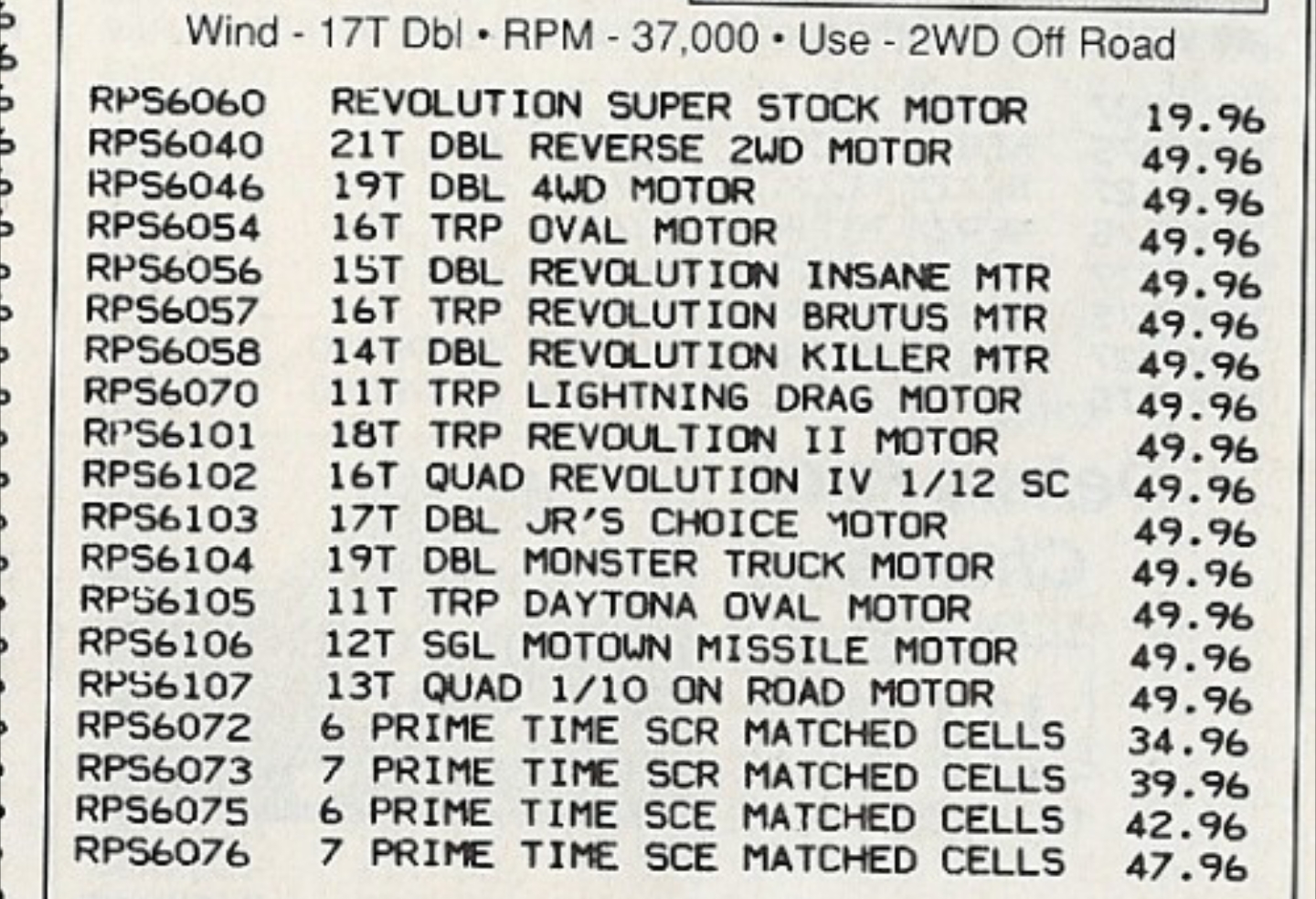

Another period listing here, showing how the winds possibly changed slightly across the range over time.
6054 is listed as a 16Triple here, whereas it is a 17Triple in the earlier advert i posted.
6102 the WetMag VI is a 16Quad here but is a 16Quin above.

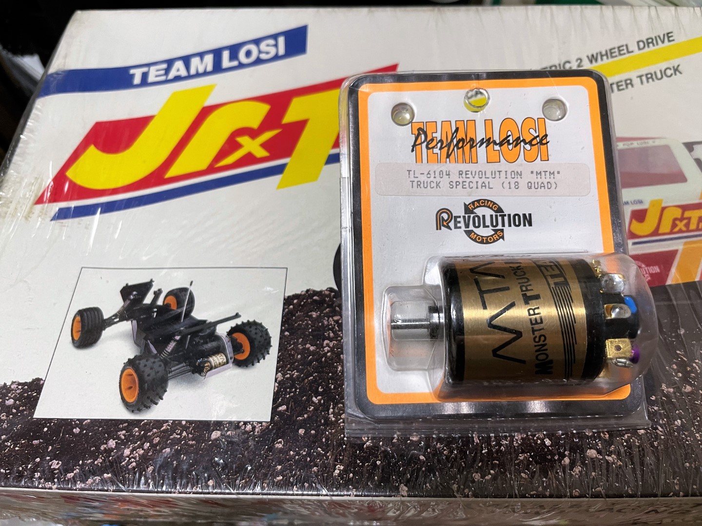

That was posted in the Vintage Brushed Motor Reference Guide thread which caused a debate about the same Revolution MTM motors having different winds. For example some claimed the Monster Truck Motor came in two different winds, while others claimed it never did. I can confirm that it did in fact come in either 19x2 Or 18x4 as I've seen them new in the package with both.

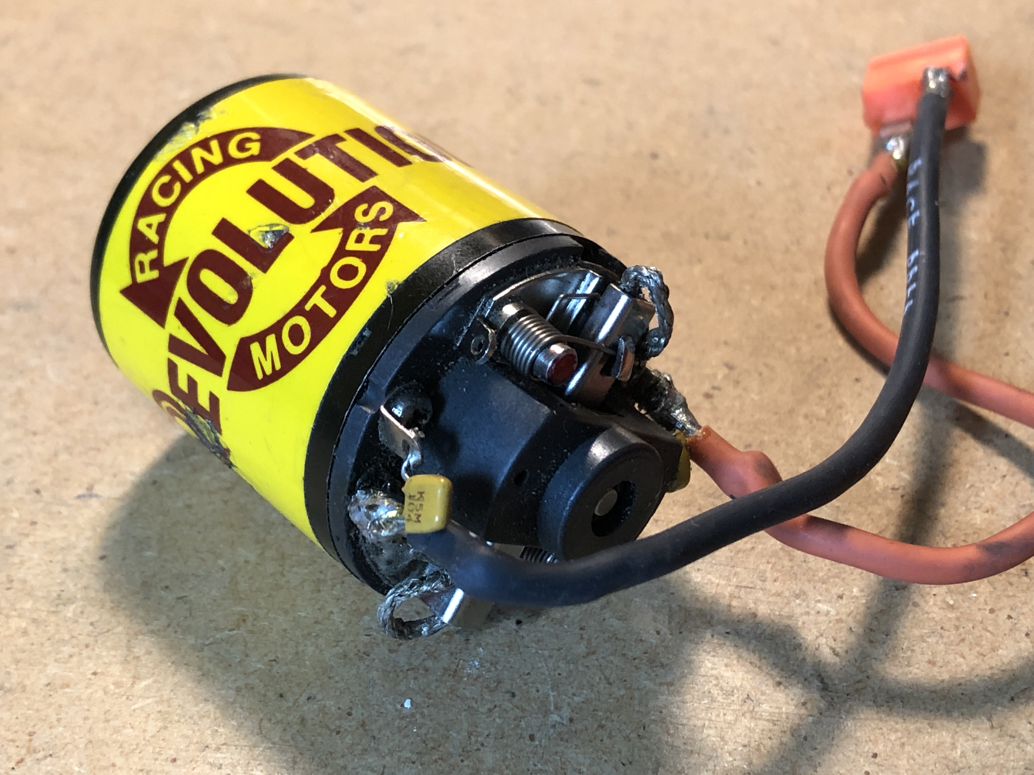

Not all had the etchings either. I am trying to make sure any I purchase do have them (although easy for sellers to add I suppose).... My first original 17Triple that I bought way back when didn't have any etchings, that much I do know.

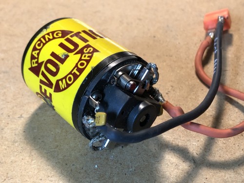

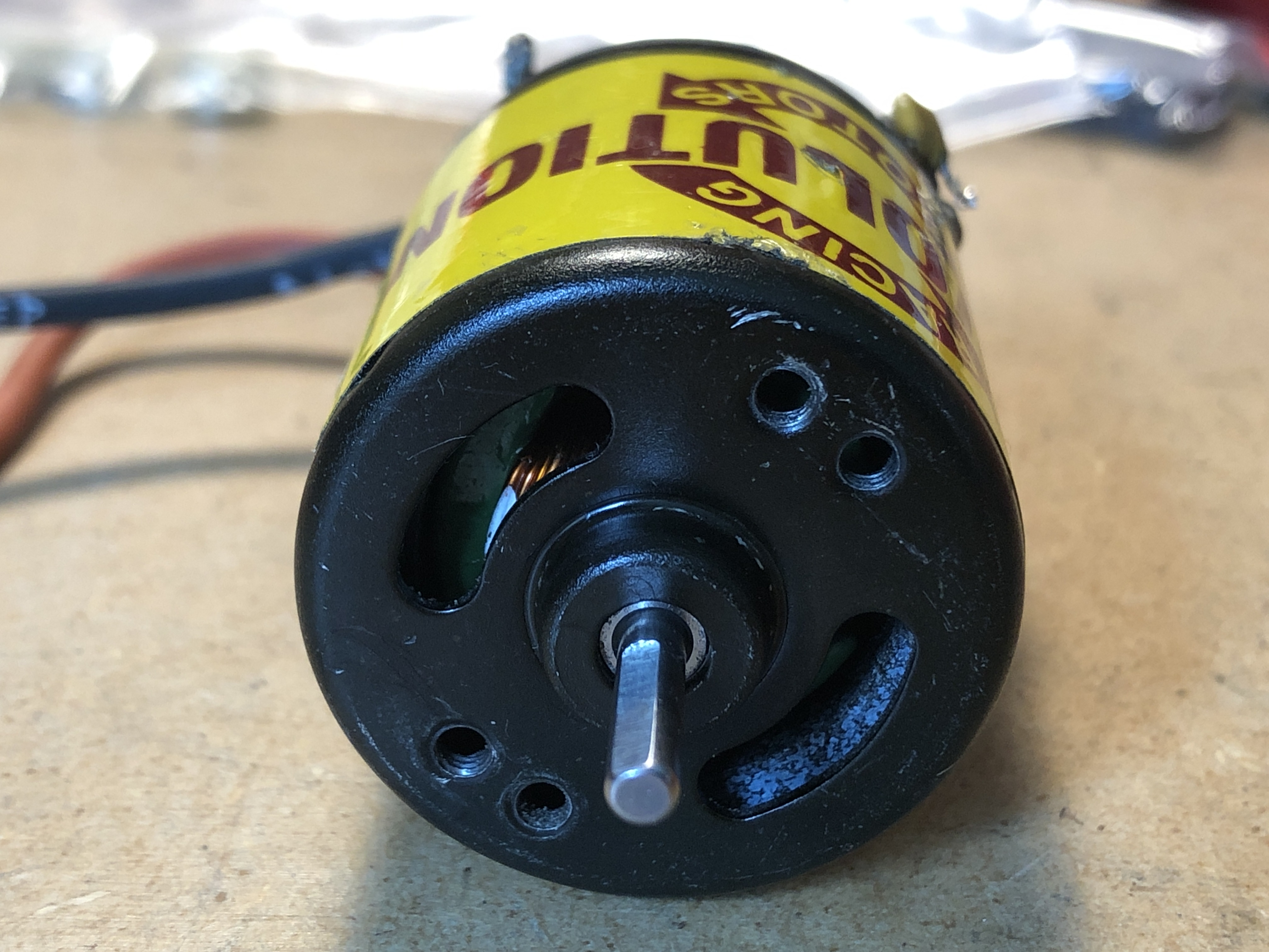

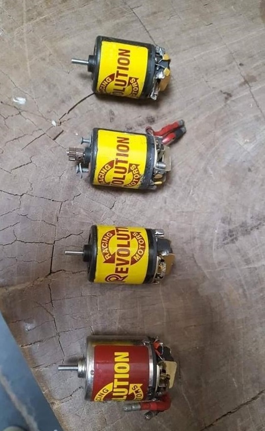

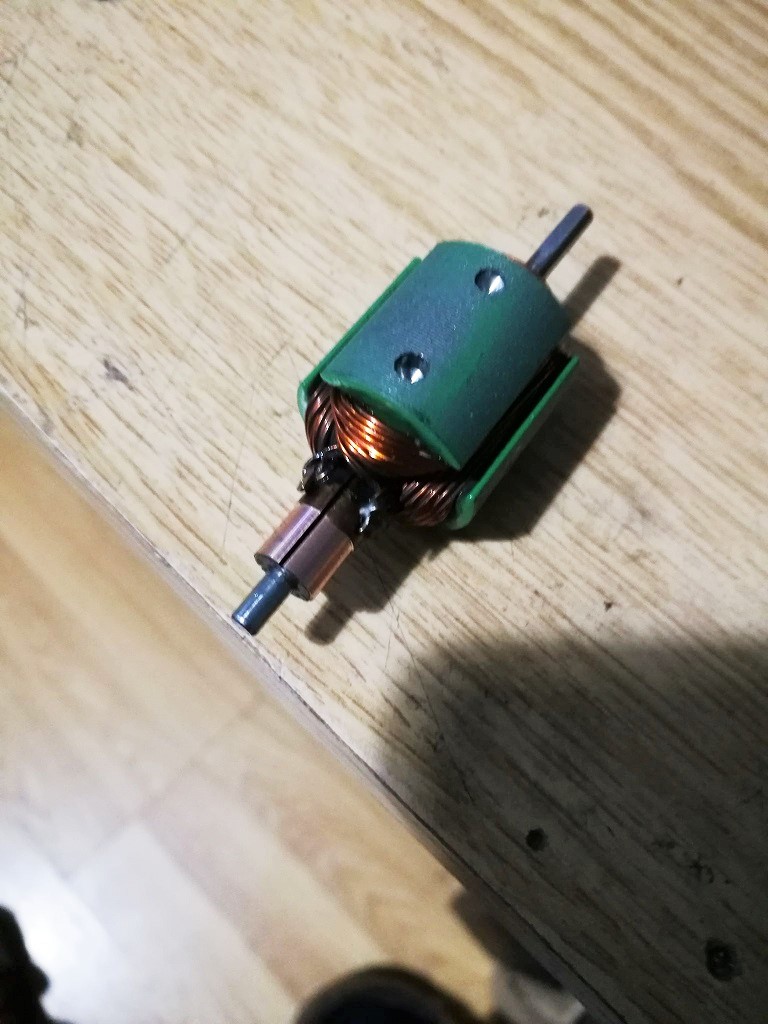

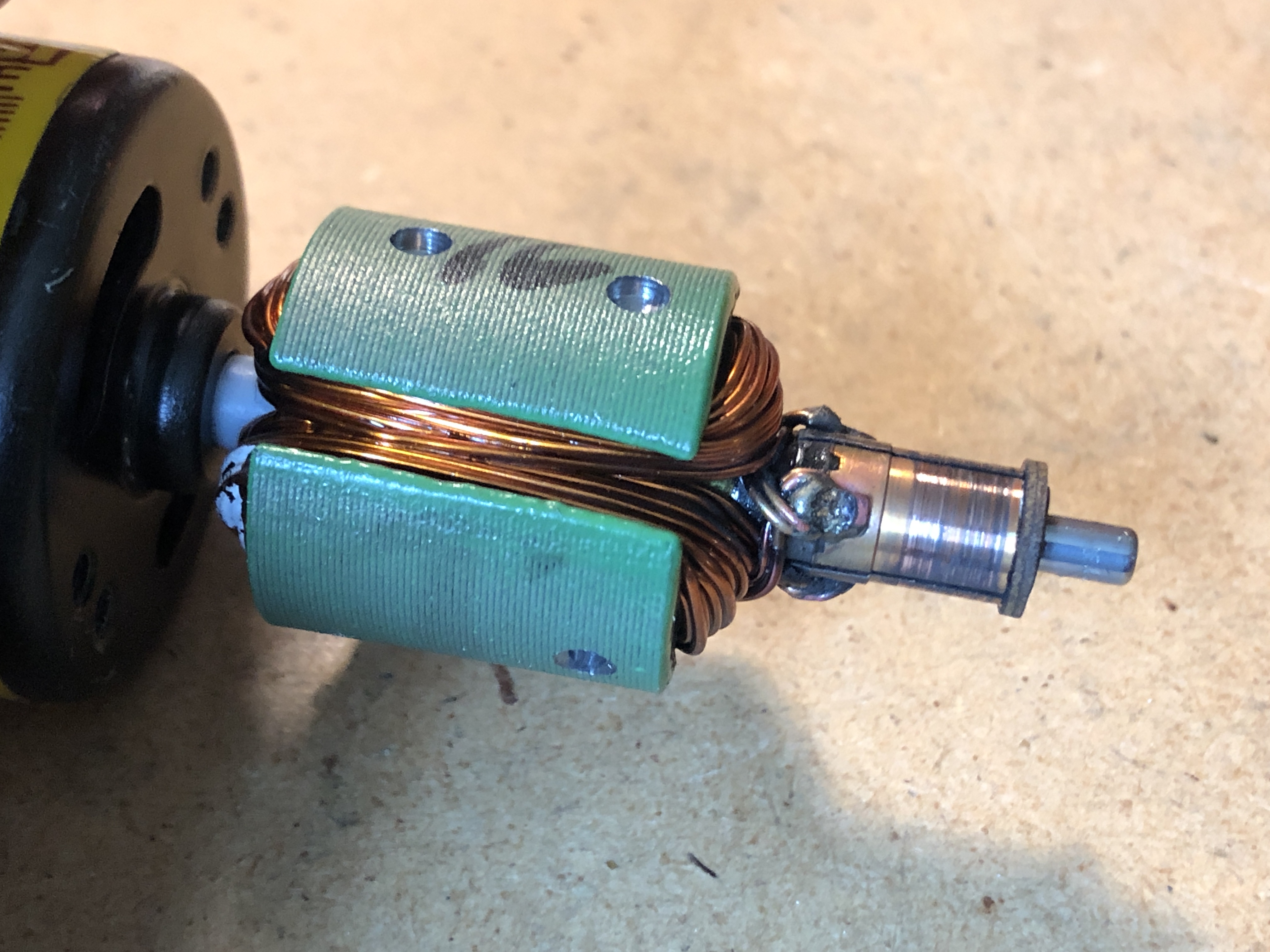

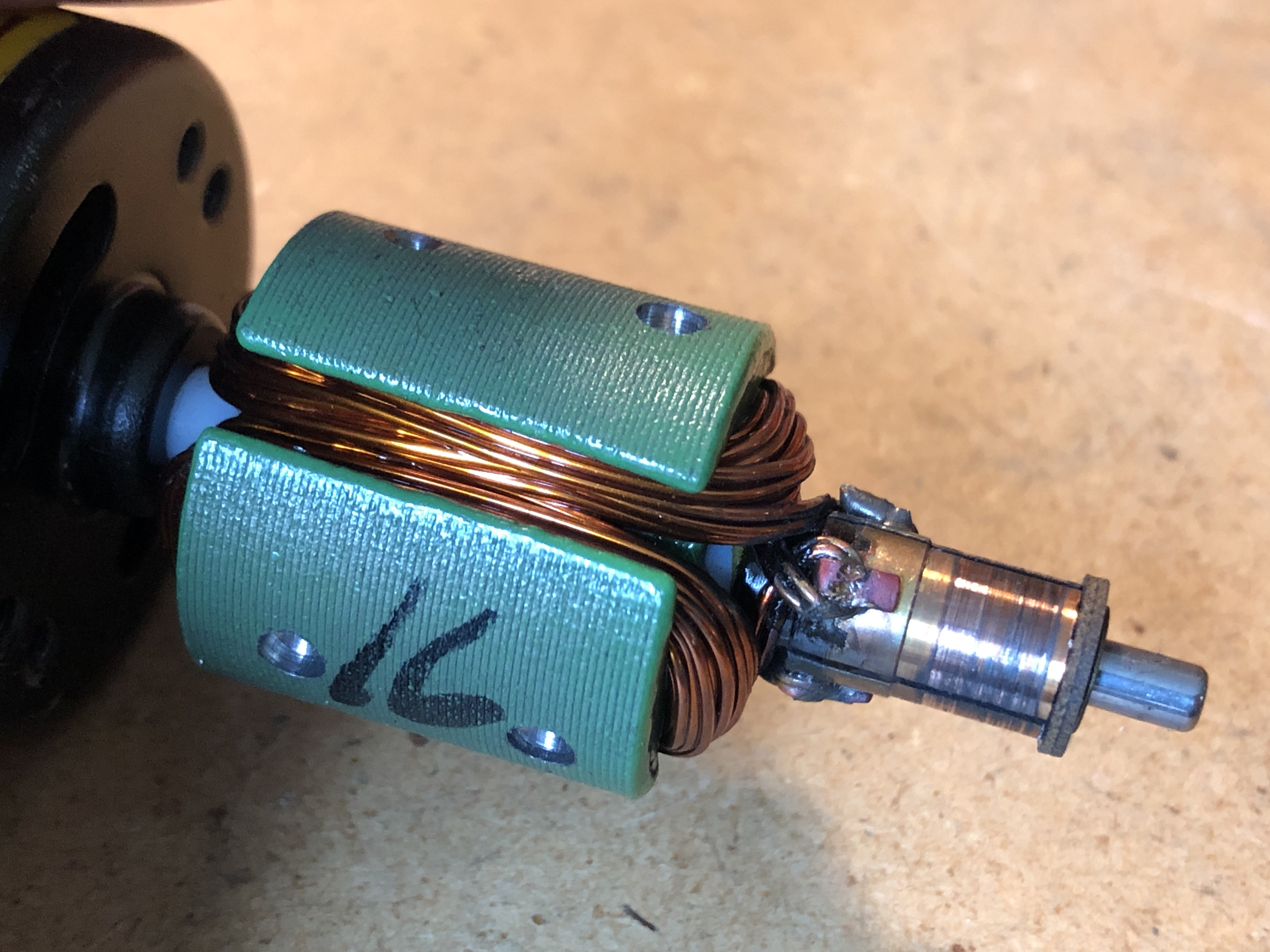

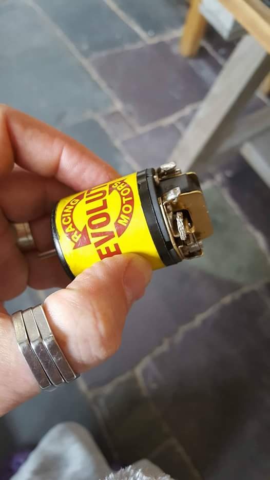

I could use some help identifying a motor I recently acquired -- it's a modified yellow label, the armature looks like it's marked "16", and it's a double wind. No markings on the can face. From info above (thanks dinglem!) I conclude it's dry magnet can, but I don't see the 16x2 armature combination listed anywhere for modified Revolution... I would have expected it to be original based on the other items I acquired from same source, but don't know the history so the armature could have been replaced. Maybe I'm misreading the 16??? Has anyone seen a 16x2 Revolution combination elsewhere?
TIA for any thoughts!

The 17x3 Oval and the 19T (I think double) were the first Revolution production motors.
Before them I got a 16x3 and a 18x3 prototype motor, right for our Nationals.
The 18x3 was not working for me.
The 16x3 was one of my fastest motors ever. When the armature burnt later, I replaced this motor with a Brutus production motor.
Same wind but a tiny bit slower than the prototype.
I later had the Insane also, but for me this wind was never as fast as the Brutus.
The Brutus was my favorite motor for a long time, if you got the cells to last.
The 17x3 Oval was my next best choice for those guys who didn´t have the Uber cells.
A lot of guys at my racing club went with this motor and were very happy.
Other guys who didn´t have the same driving skills were happy with the 19T.
I think at that time you hardly could find any other motor at my buddies. Just Revolution motors.

You are correct. It appears the Jr's choice came in a double and triple wind.Lowgear wrote: ↑Thu Sep 23, 2021 3:00 am That was posted in the Vintage Brushed Motor Reference Guide thread which caused a debate about the same Revolution MTM motors having different winds. For example some claimed the Monster Truck Motor came in two different winds, while others claimed it never did. I can confirm that it did in fact come in either 19x2 Or 18x4 as I've seen them new in the package with both.
