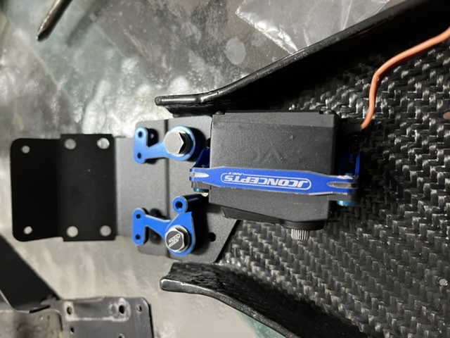

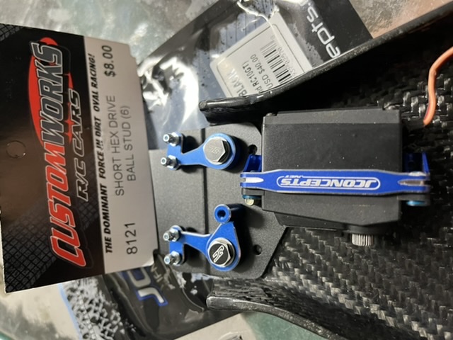

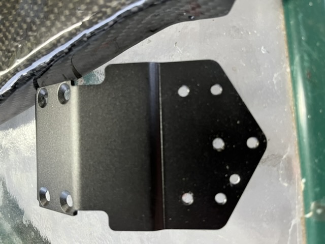

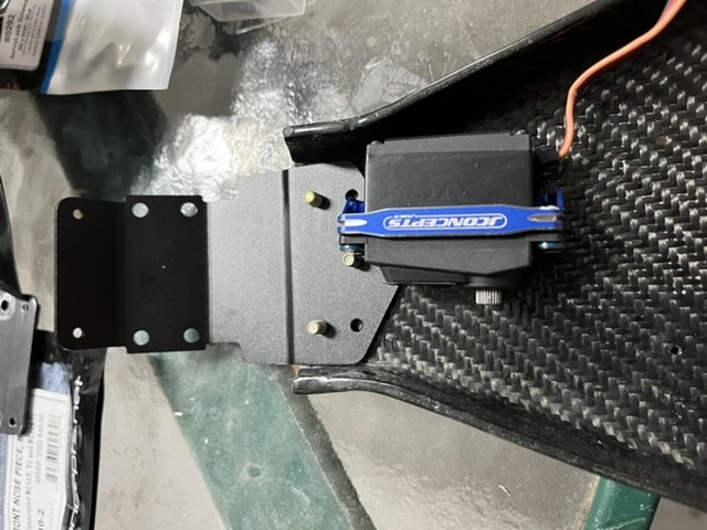

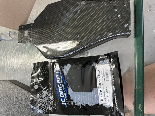

Now that my carbon fiber tub is finished and fully cured I am starting on rebuilding this guy. The tub isn’t perfect it thicker than the stock tub and I had to make some changes.
I am pretty happy that I can just go and buy a new plate. The nose plates I had were warped. The plate doesn’t have the t2 servo mounting hole pre drilled.that was an easy fix.
The j concepts b6.2 servo brace has the same offsets as the original servo mounts for the t2. I mounted it up with some 10mm m3 flathead screws. They use the same countersink as the 4-40 hardware.
The chassis thickness caused an issue with the special hardware used for the gt steering. The j-concepts steering rack dropped right in and it’s design allows for the thicker chassis with no issue.

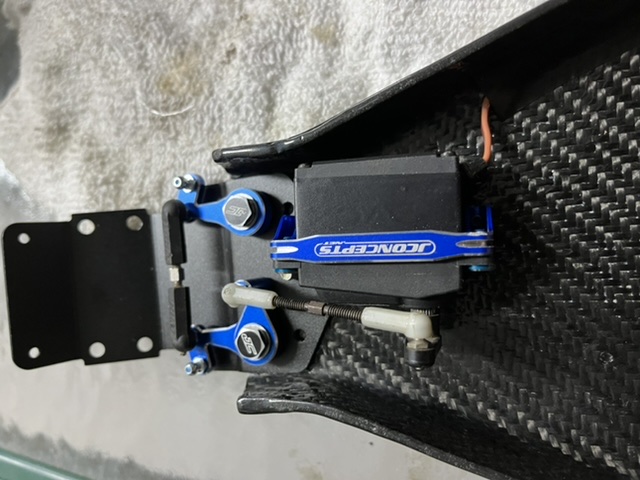

So all the steering parts are test fitted. I have to dig up my center link. I think I also want to find a nicer looking steering link.
Under the tape the servo was upgraded from a futaba 3001 to a Savox 1258. I also secured it down with some 1-up blue servo mount screws.
