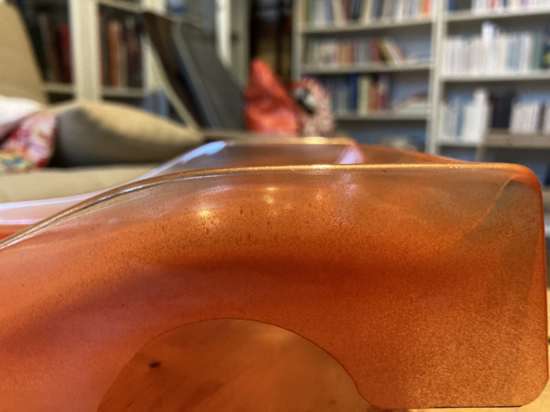

I'm sorry if this is a stupid question. :oops:
I'm painting a 1/12 pancar body with a spray paint and it seems that the paint doesn't go deep in the "lip" formed by the rear wing, leaving it almost transparent.
Do you have any tips to avoid this?

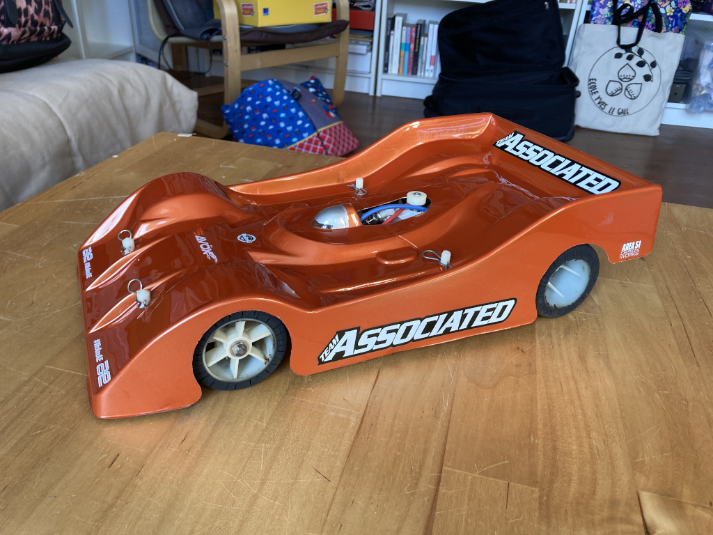

I've had the same issue previously, on a white wing, I painted that area on the outside but recently did a 1/12 pan car body & did as follows: Once the paint is dry enough to put masking tape on it, mask up the whole area where you have full paint coverage just leaving the transparent bits showing. Now pull the side of the body to give better access to the unpainted parts & keep building up the paint with heavy coats as most of it will go on the tape. In the end you should get it mostly covered, heres mine as an example that I did with rattle cans...

Finally, the result is not so bad:
