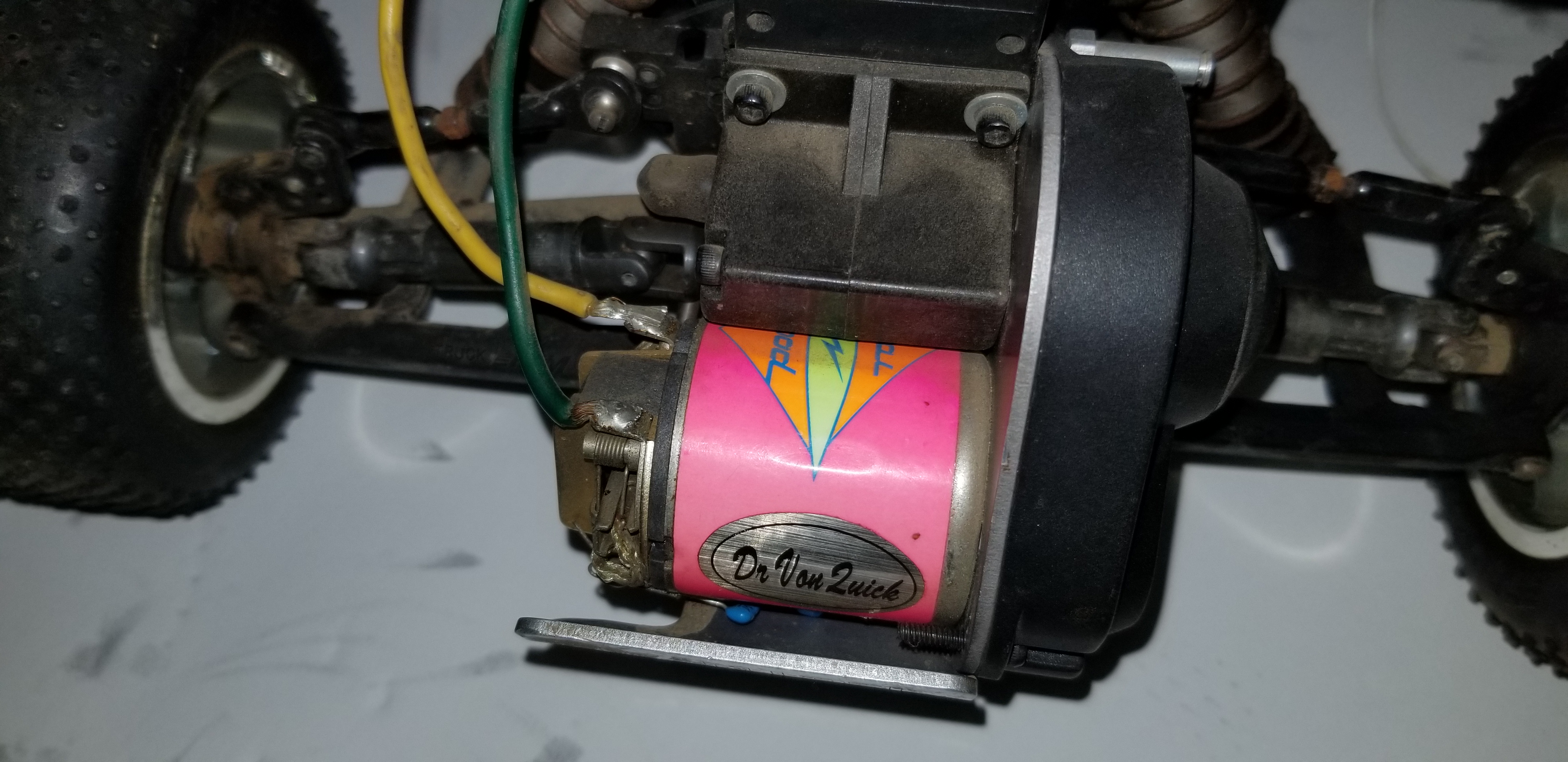

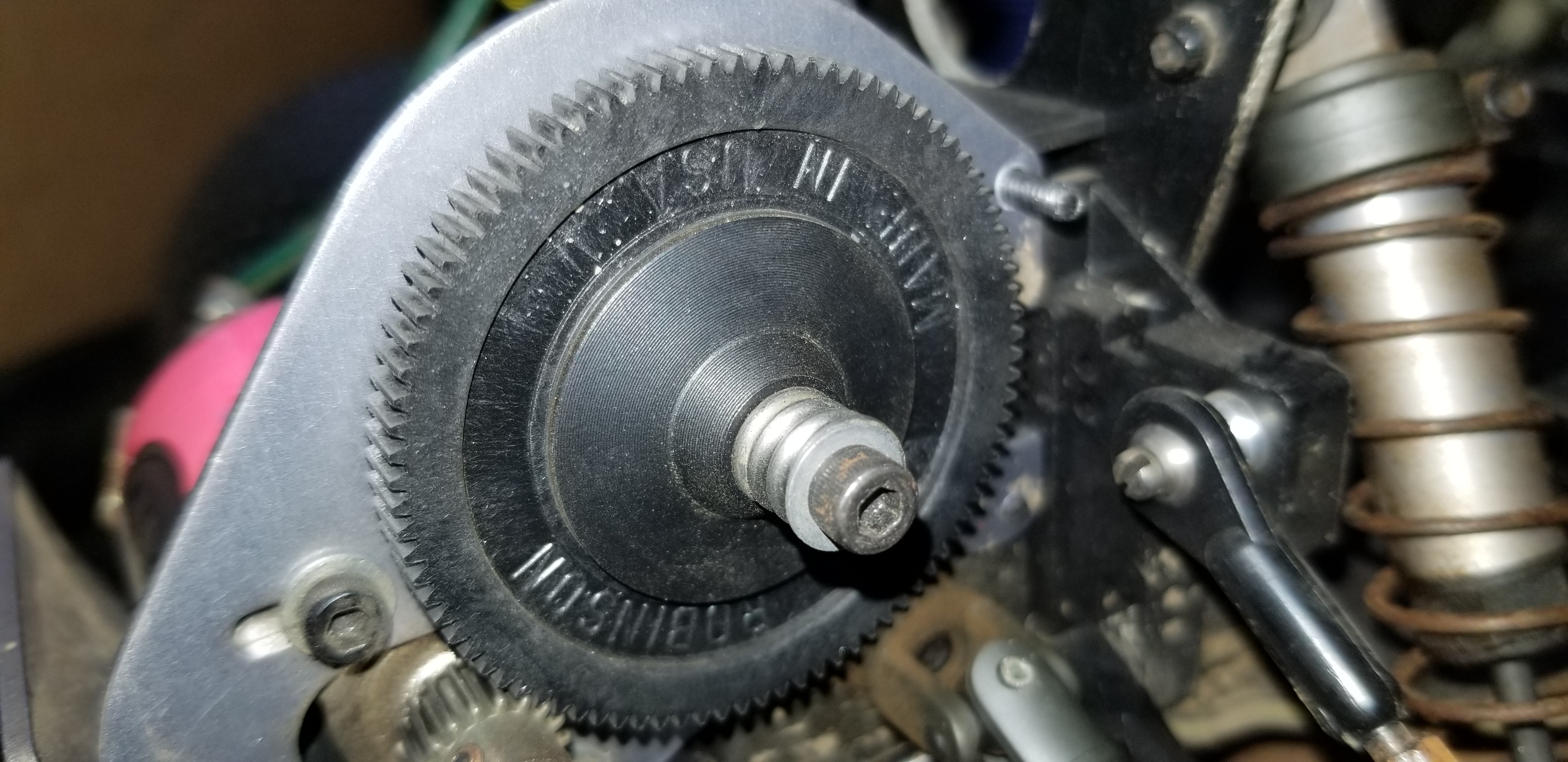

Thanks! It was a "buy it now" and I figured if I hesitated it might be gone lol. It seems to be in really good shape overall. The Pocket Rocket stock motor was a bonus. I had one of those back in the day! It also has RPM steering arms, rear arms and gear cover. And under that gear cover, I found what I believe to be an MIP slipper clutch.

I dont really want to use the rpm bellcranks. Think I'll have any problems with using the original 4-40 screws...
Looks like plenty of meat there since the previous owner only opened up the holes a bit and didnt countersink for the bigger screws.
- Posts: 1999
- Location: Upstate NY
- Been thanked: 12 times
Re: Finally got a JRX-T
That should work. I haven't done it on the ghaphite chassis but MIP made a steering kit that used 4-40 screws through 8-32 countersunk holes for the RC-10GT that I used for years, though that was an aluminum chassis. Just make sure that the base of the cone where the threads start doesn't end up above the surface of the chassis or yo will have difficulty getting it tight enough. If that happens may need to clearance the bottom of the steering posts slightly to compensate.

It doesn't appear to have had any counter sinking done so the 4-40 screw sits flush at the bottom of the chassis. I'm considering filling the hole with JB Weld and re drilling just to be safe. We'll see.
Unfortunately nothing special inside the gear box. Not even the ball bearing diff gear. Is that a worthwhile upgrade?
Also the one other problem I found is one of the screw holes in the motor plate is either stripped or partially stripped do to the transmission screw being a tad too short. I ordered new screws, but any good way of fixing? I've used JB Weld in plastic parts before, but I don't think it would work very well here.
