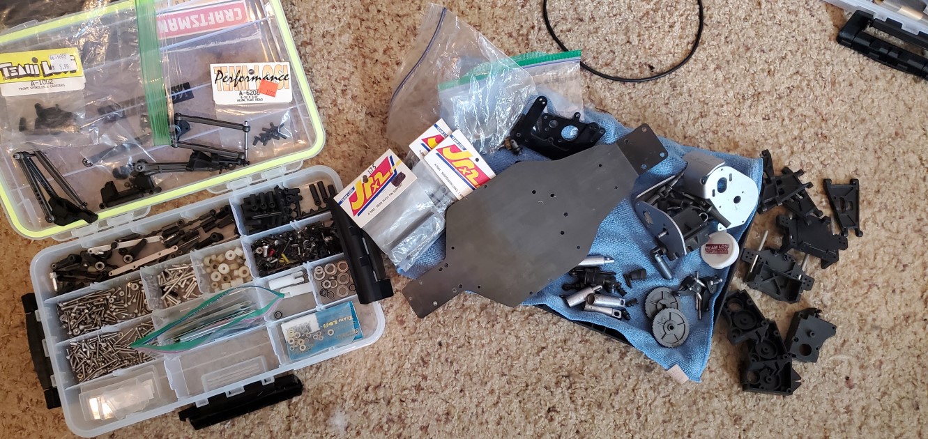

So first pack out this happened, doh! I have extra links but no shock ends so swapped to H arms then JRX-Pro SE front arms. Car felt a whole lot better but I don't think I want to risk my JRX2 on carpet right now, especially considering how rusty I am. Thinking about restoring it to pretty much box stock. However, I also picked up a JRX-Pro and Pro SE, both in various states of disrepair, for extra parts. So, I'm going to build up another JRX car as a runner til I get my hands on a 22 5.0. Stay tuned
James - Losi fanatic
- jwscab
- Posts: 6580
- Location: Chalfont, PA
- Been thanked: 505 times
Re: My JRX2 restore/race build
the 5 link is defintely more suited to rough choppy offroad surfaces, so I can see the H arms being more predictable on carpet. sucks you broke that mount. it's a shame its such a unique thing, I've made aluminum ones in the past for my brothers car.

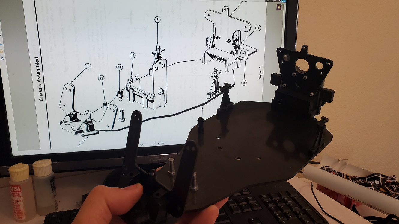

Welp, decided to build up a JRX Pro SE to run on carpet with some parts from my JRX2 and will build the JRX2 box stock with the exception of a few goodies. To add to the fun I'm going to follow the instruction manual I have downloaded. Should be a good time

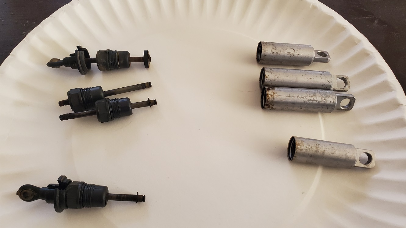

The stock shocks were in pretty sad shape and I ended up swapping out the rear shafts since one had a pretty bad groove in it. The bodies cleaned up pretty well, not perfect but much better than what I started with. Still need a few pieces to get where I want but I'm happy with the progress.
