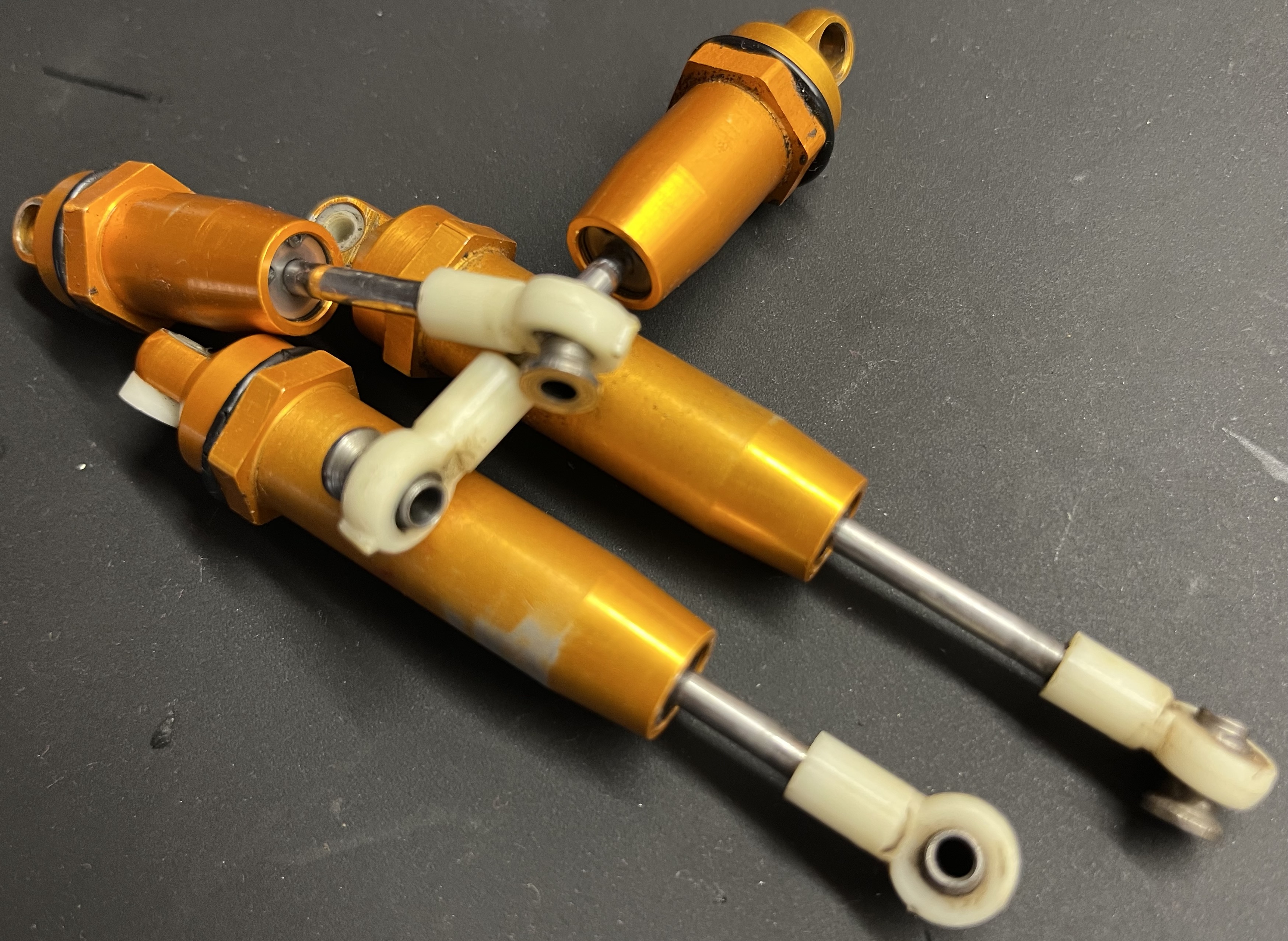

what tool recommendation for servicing shocks, those are small c-clips?

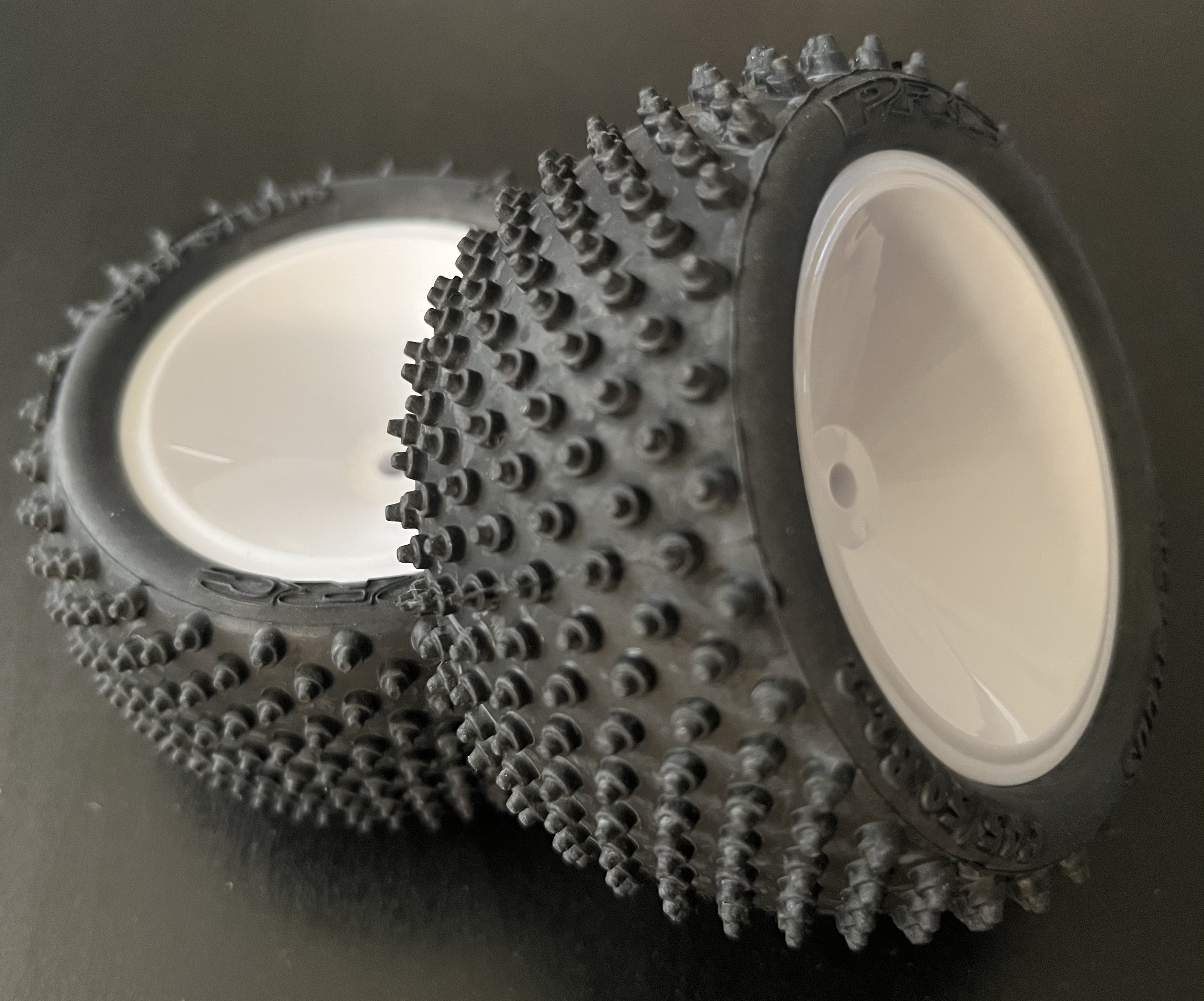

New shoes
Posts: 3808
Has thanked: 2604 times
Been thanked: 2977 times
Re: RC4X4's RC10 Resto runner (basement find)
Ooooo! What kind of tires are those?
Posts: 3535
Has thanked: 268 times
Been thanked: 2094 times
Frankentruck wrote: Thu Apr 21, 2022 7:04 pm Ooooo! What kind of tires are those?
Precision R/C, Step Studs

RC4X4 wrote: Sat Apr 16, 2022 2:06 pm what tool recommendation for servicing shocks, those are small c-clips?
McMaster Carr 57805A32
I have a Novak problem....
Posts: 3535
This is what I have.
https://www.amazon.com/4411J0-Internal-Straight-Retaining-5-75-Inch/dp/B001E5X9YY
Yes you are correct, $15 a pair and $5 for foams

Ok, shifted plans a little, I resourced a B stamp that has stealth trans holes in the chassis. My build will consists of a B stamp chassis, Gt front end, Stealth trans in the back, Jconcepts steering rack, Klein wide suspension arms. Some things will change as I go Im sure but for now Im getting ready for a re-anno.
So a quesiton to the vets, top load or bottom load shocks? Which will I be happier with? I have top load Gt shocks (with plastic caps). I want to use the truck size shocks, but do I hold out for bottom load shocks? Asking because I need all of these parts anodized in one shot, and dont want "regerts". As you can tell this is not a historical museum build, but a user/shelfer.
