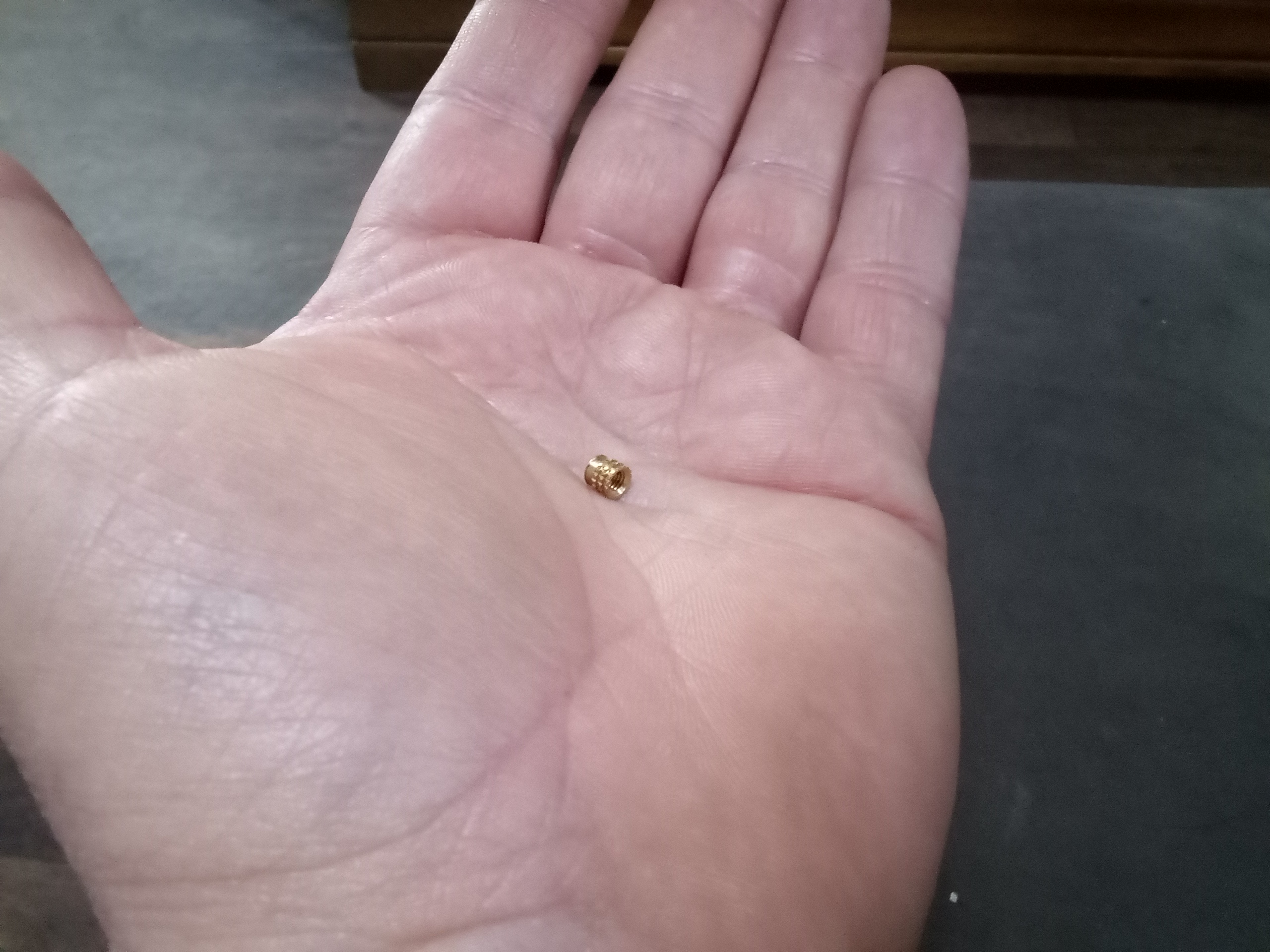

I'd try a thread insert , they are designed to be used as metal thread inserts for plastic parts ,I have some in M3 , you stick them onto the tip of a soldering iron and push them into a plastic hole meeting them into place , they are knurled on the out side to grip , I think if you drilled out the thread to just the right size hole you could press one into the ally .
Alternatively try glueing an M3 nut on the inside of the can
