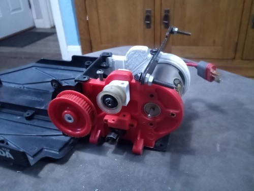

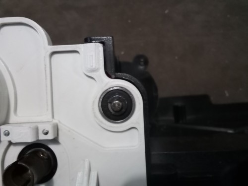

Finished the front and rear transmission housings , a job made more confusing by my warped original chassis , it looks wrong even when it's right :lol: anyway now it's done and I have a chassis model as well I can complete the cage , once off the car and in pieces the cage is like a wet noodle , virtually impossible to measure correctly :!: But now it's going to be way easier :D

It's nice when things fit so well .

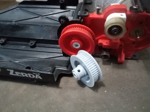

Also modelled this MXL pulley , came out well but it's only resin printer , looks good , engages the belt
perfectly but it's not strong enough to use , good proof part and maybe I'll get a tester printed from Shapeways

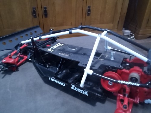

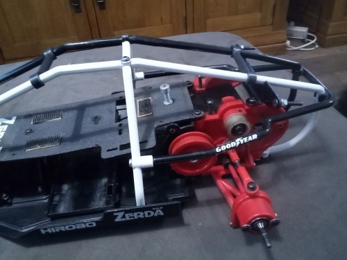

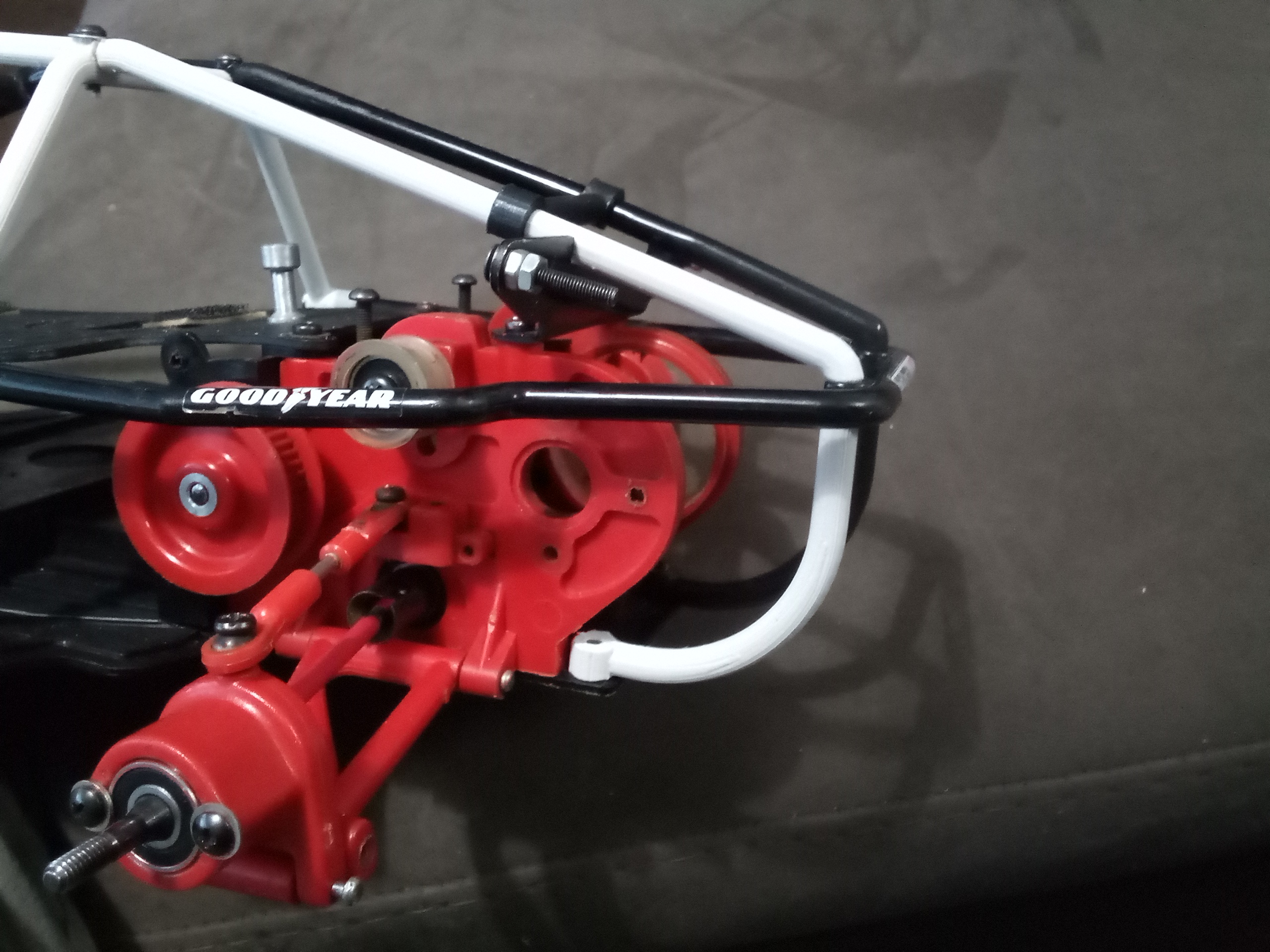

Bit more Zerda , cage sections , took longer than I'd like to admit as the originals are soft as noodles and hard to measure , they fit well now though , the long front to back section is to long to print on my printer so I had to do it in two sections , I modelled the rear section not show hear a while ago and I compared it with these parts in Fusion 360 and they don't fit together but in real life they do because they are so flexible :lol:

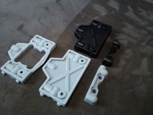

Drew these SG Racing Coyote parts , bulkheads and the top suspension mount , just resin prints as proof parts , will be in my shop soon .
The eagle eyes might spot that the bulkheads are not full thickness , I dropped the prints into the bed to get a flat bottom .

Dadio wrote: Tue May 03, 2022 3:40 pm Bit more Zerda , cage sections , took longer than I'd like to admit as the originals are soft as noodles and hard to measure , they fit well now though , the long front to back section is to long to print on my printer so I had to do it in two sections , I modelled the rear section not show hear a while ago and I compared it with these parts in Fusion 360 and they don't fit together but in real life they do because they are so flexible :lol:
Looking at the instructions of the Nichimo 443 WDS which uses the same bumper as the FWD Nichimo cars, i suspect the engineers were relying on the flexibility of the plastic so that it can mount on both cars. On the Spirit, they put spacers, but they did not bother to put them on the Midships/Exceed :-)... And the flexibility works... Not sure which one was possibly breaking the Bumper faster :-)

I hope you make those Coyote double wheel bearing adapters next! I’ll buy 2 sets..

What I've just done was draw up converted front and rear hubs to take double bearings , thought that might be a better way to go as it does away with the three little screws to retain the bearing or adapter , I can just do adapters if that's what you'd prefer , would be cheaper .

I think I would prefer the adapters, just to keep the car as original as possible with the mods on the subtle/hidden side. Your redesigned hubs sound interesting too..

No problem , I'll draw them up and test print them , not sure I have the three mil wide bearings to test with but I'll have a did around .
