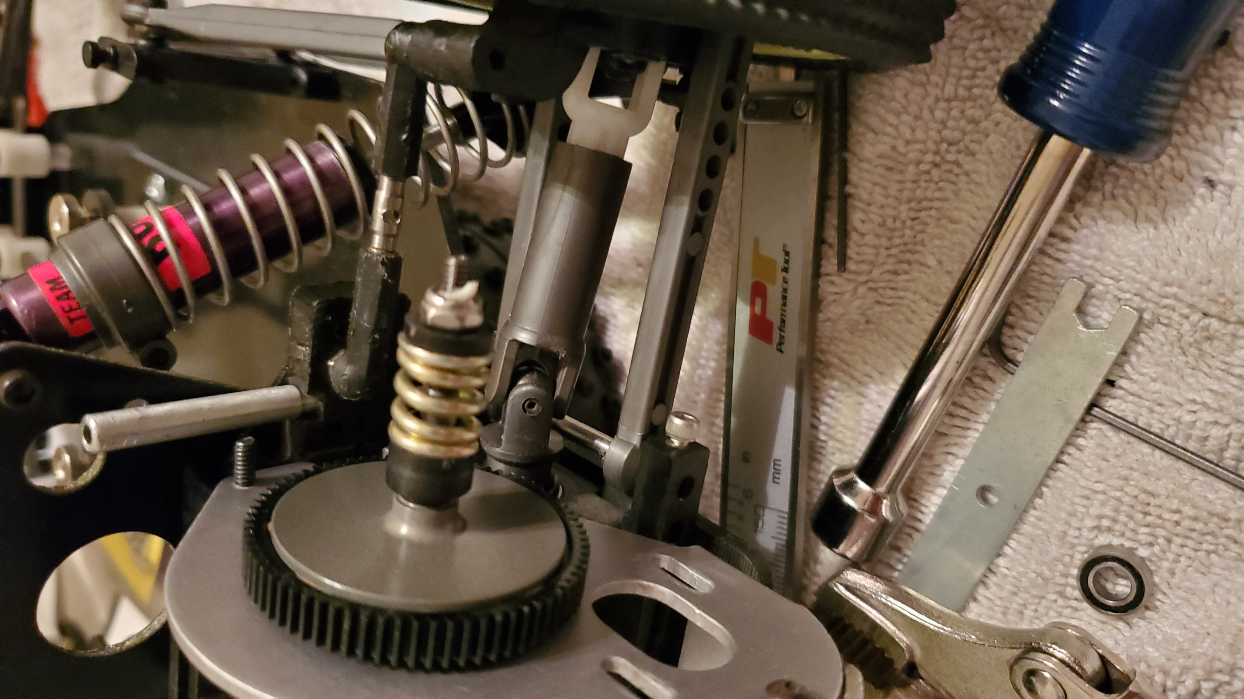

I don’t think you would have any problems running a JRX Pro, it’s a great car. I would just add a Losi slipper or Factory Works Power Clutch and run the diff tight.

A B4 spur and slipper pads are a direct fit, have much more material and are readily available. Ran a 71 tooth spur, 17.5 on carpet and worked great.
