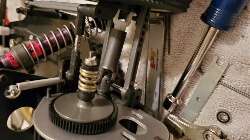

Contrary to much popular internet lore, the LRM transmission holds up just fine to the modern brushless. I have run countless laps on high traction carpet with mine. Sometimes I have a slipper, sometimes I do not. Just do not let the differential slip too much. On the modern high bite tracks anyways I run the diff very tight anyways so slipping is not an issue. Even if class was 13.5T I'd run 17.5T. Plenty fast enough and if you haven't done it in 30 years, a little slower will make you faster anyways.

I don’t think you would have any problems running a JRX Pro, it’s a great car. I would just add a Losi slipper or Factory Works Power Clutch and run the diff tight.

A B4 spur and slipper pads are a direct fit, have much more material and are readily available. Ran a 71 tooth spur, 17.5 on carpet and worked great.
