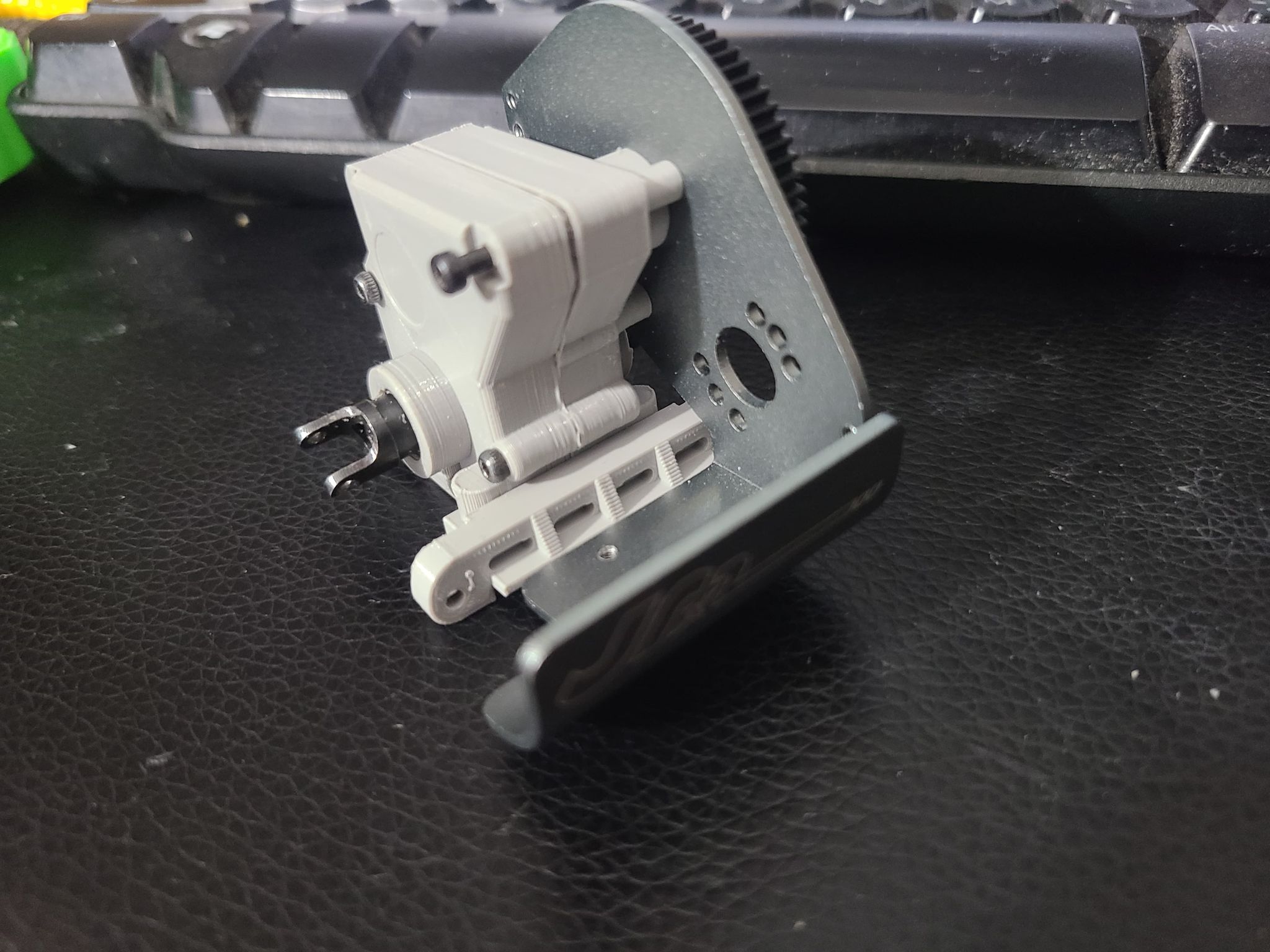

scoobyrs25 wrote: Fri Jul 22, 2022 10:30 am Does the MIP top shaft and slipper work?
Anything that fits in the stock transmission should fit in this, this is a direct replacement for the stock case. :)

Just thought I would park this here heh.

clm wrote: Fri Jul 22, 2022 10:58 am
It was a general question, not specifically about your case. ;) I know the diff doesn't work due to the different axles.

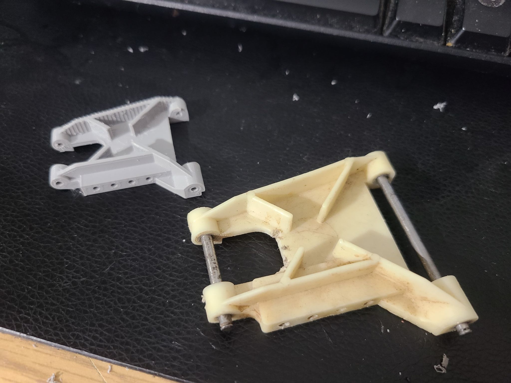

I am going to start printing some H arms tonight however!

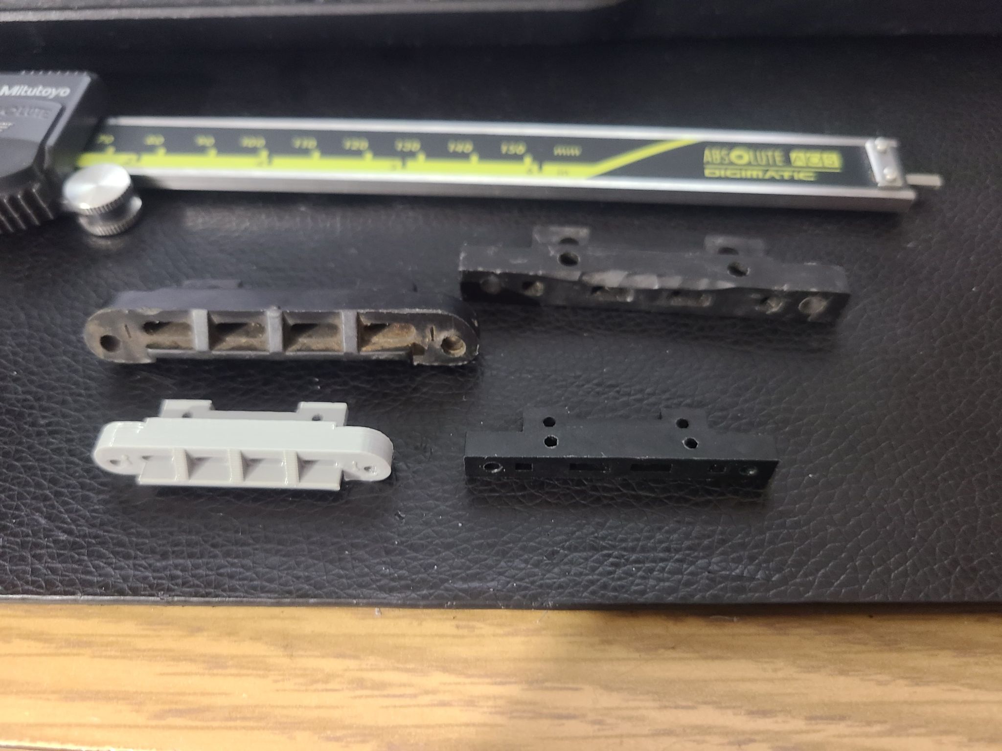

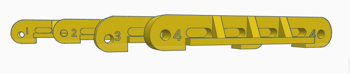

Working on another missing piece for replicating other models.. I have 1 and 2 modeled already, still need to do 3 and 4.

The files have been uploaded, I have tried to replicate the precision of the rear toe blocks as close as I possibly can, #1 would be the 'stock' one to use as a stock build with the H arms. I would (and have) oriented them with the numbers facing up when printing with a hot .2 nozzle.
Rear Toe Blocks: https://cults3d.com/en/3d-model/game/losi-a2016-rear-pivot-support-set-for-mini-jrx2

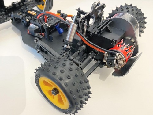

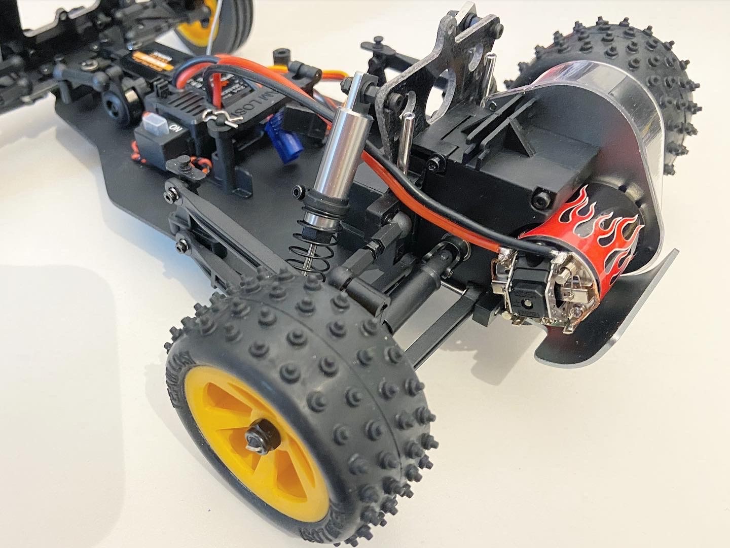

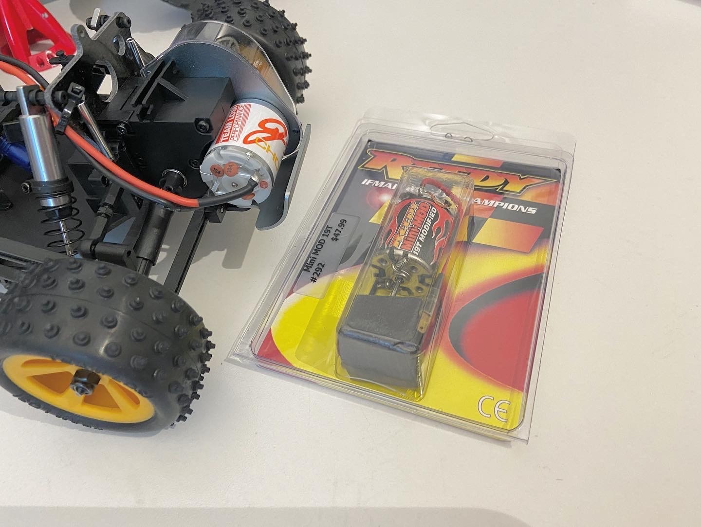

So I couldent resist.
I bought the red one, Figured as it's my first ever Losi!..
I have a few mods in mind.
Swapping the wheel nuts for white nylone.
Thinking of painting the receiver/esc case orange.
Try to source mini-T 1.0 springs.
I've ordered JRX2 decals and panel decals in 1/16 scale from MCI. We'll see how they fit.
Ordered 1,5 mm Kydex for a front bumper.
will order 1,3 mm piano wire for proper wing mount.
And the Reedy Mini Mod 19T. Looks so much better with a open end-bell. I know it's not a Losi or Trinity motor, but i got a good deal on it.

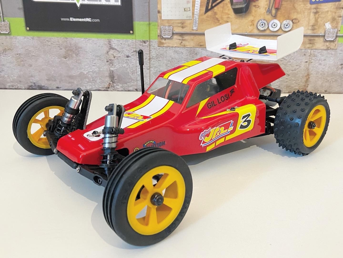

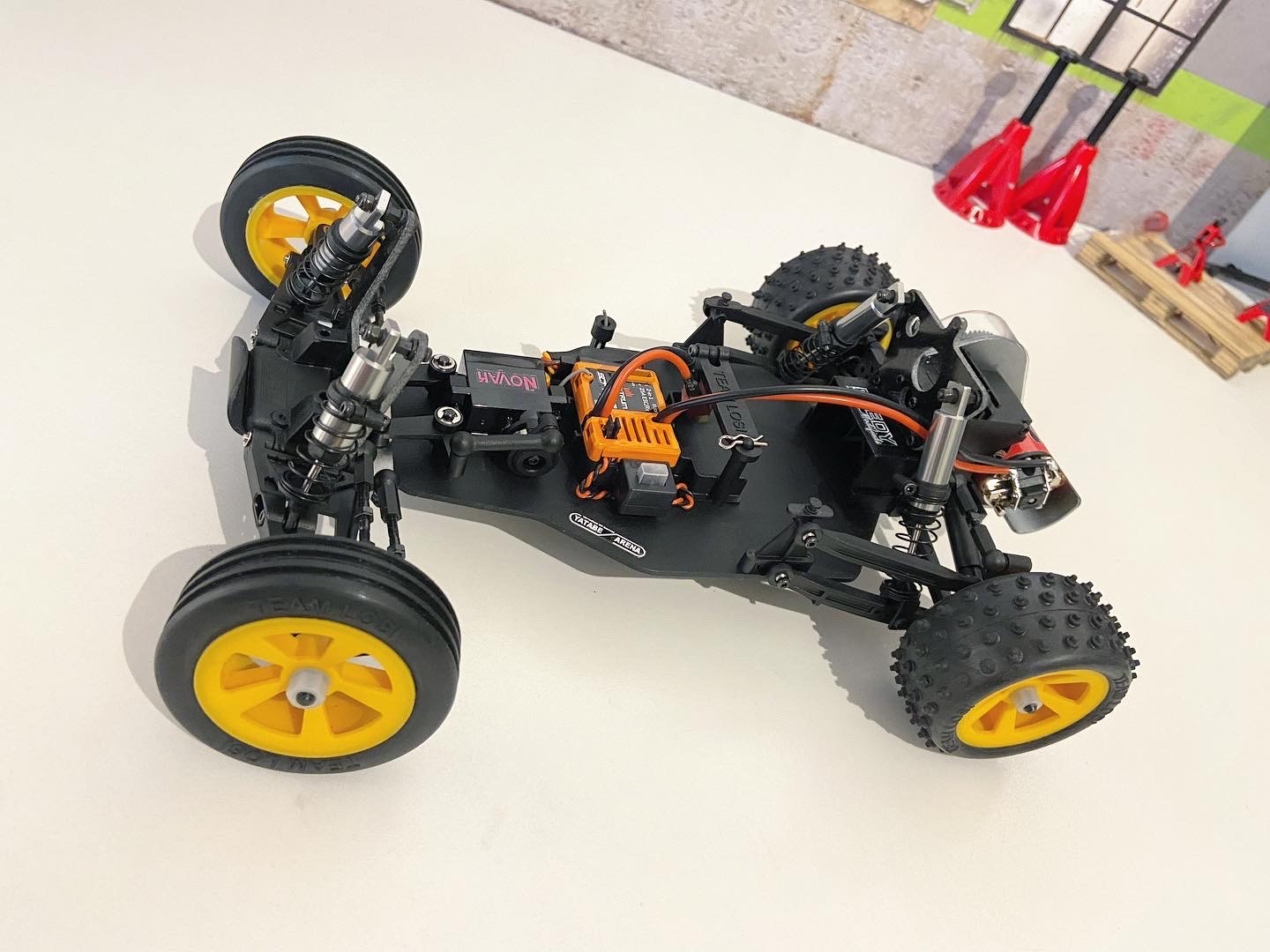

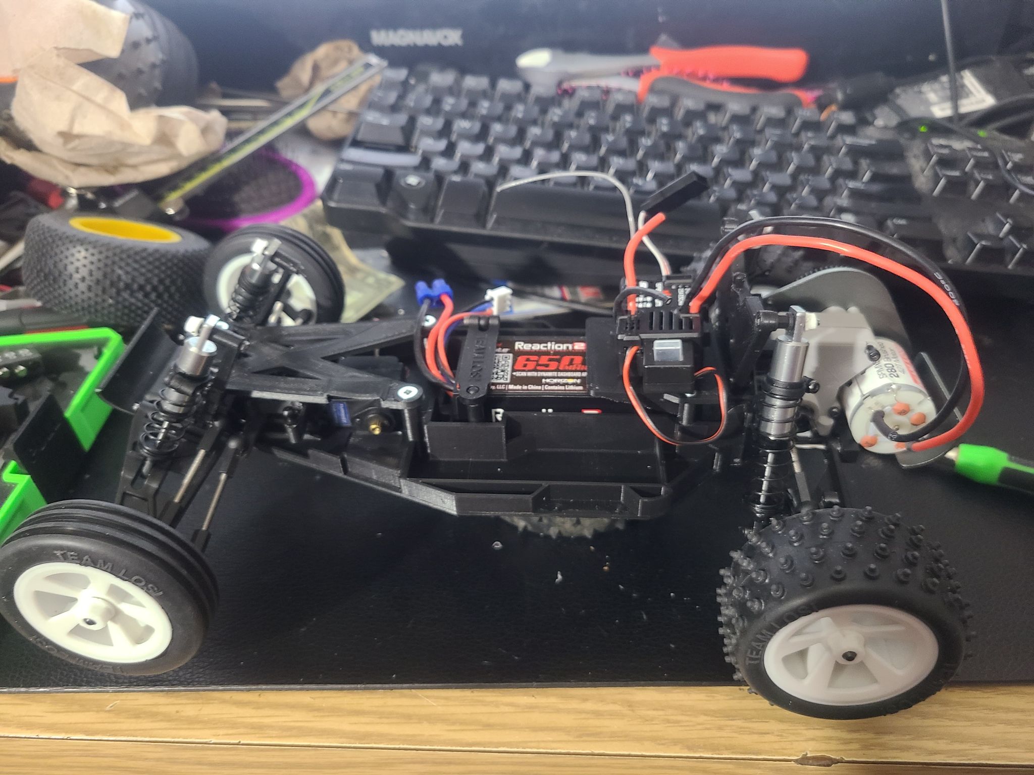

Update on the 1/16 scale Team Losi JRX2.
Painted the rx/esc orange. Was not able to swap the negative motor wire to a blue one as the rx/esc is filled with epoxy.
Deans conector.
Fabricated a front bumper out of 1.5 millimeter Kydex.
White nylon wheel nuts.
And a couple of stickers.
I figure the chassis is done. Moving on to body and wing

Great work Chris! I hadn't seen this post but I originally planned on making a replica of my first Truck: an LXT with a JRX chassis, Looks like you beat me to the punch with making the models though! I guess I shouldn't have procrastinated on picking up the Mini JRX2. I may pick up a few more of these later to do different variants too. My first R/C was a used JRX Pro SE which i might want to replicate later but I unfortunately don't own that car anymore.
I am going to shift my model focus to some cosmetics for now. Like a dummy Hydra-drive to cover up the outside slipper assembly.
That and figuring out ways to tighten up the front. Seems Losi uses undersized hinge pins so there's a lot of slop up front especially at the castor blocks. Already fixed a bunch of slop in the steering by using a bunch of shims on the belcranks and tighten up the rear a bit shims as well.
