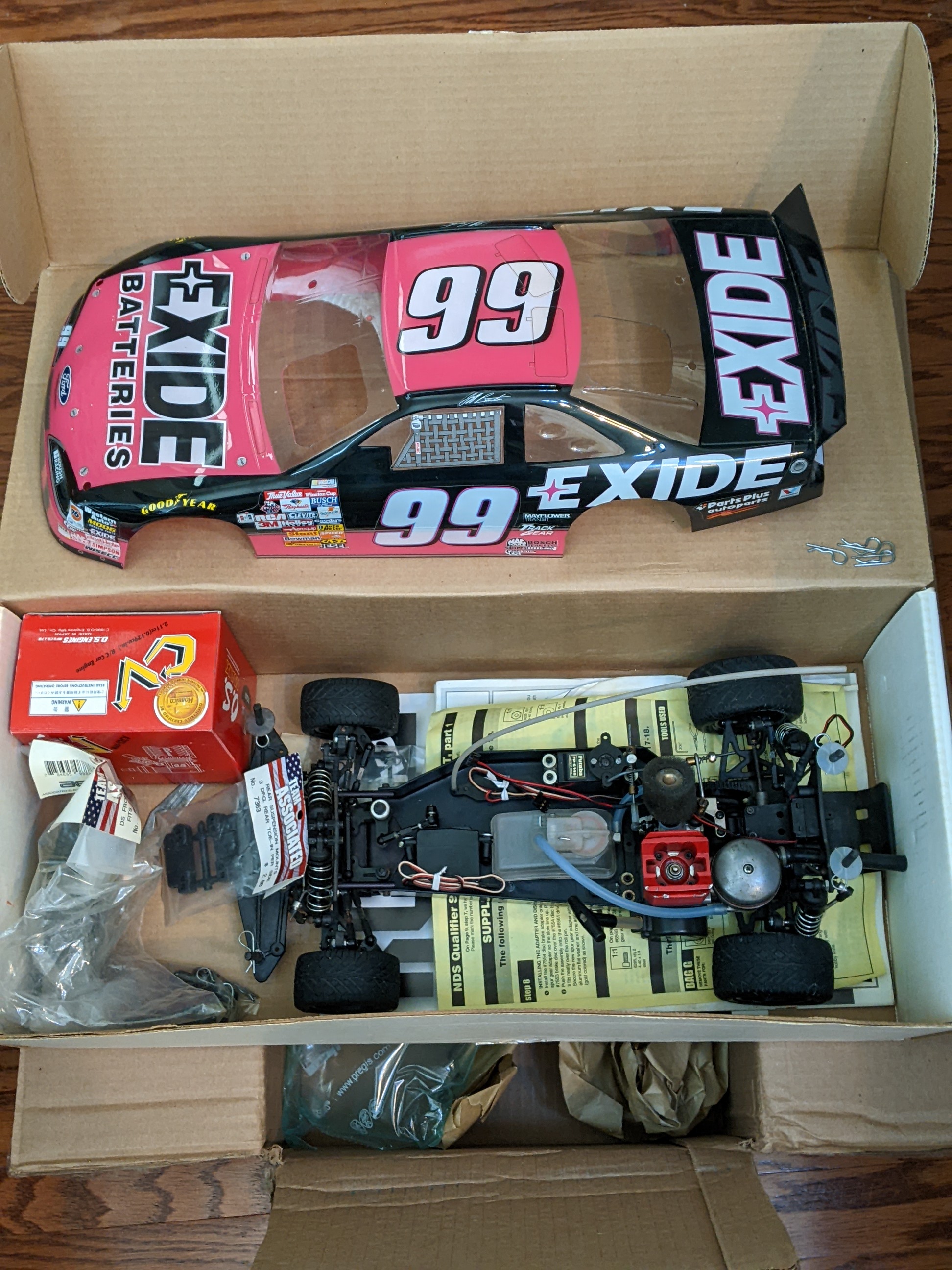

Moo ahh, ah ah ahhh.... The future electric DS has arrived. The Exide Batteries decals seem like fitting foreshadowing of the future.

It's not like I'll be cutting, grinding, etc, just part swapping. If I come across a good deal on an electric DS, then the nitro probably stays nitro. But that Exide body is kinda egging me on to electrify.
