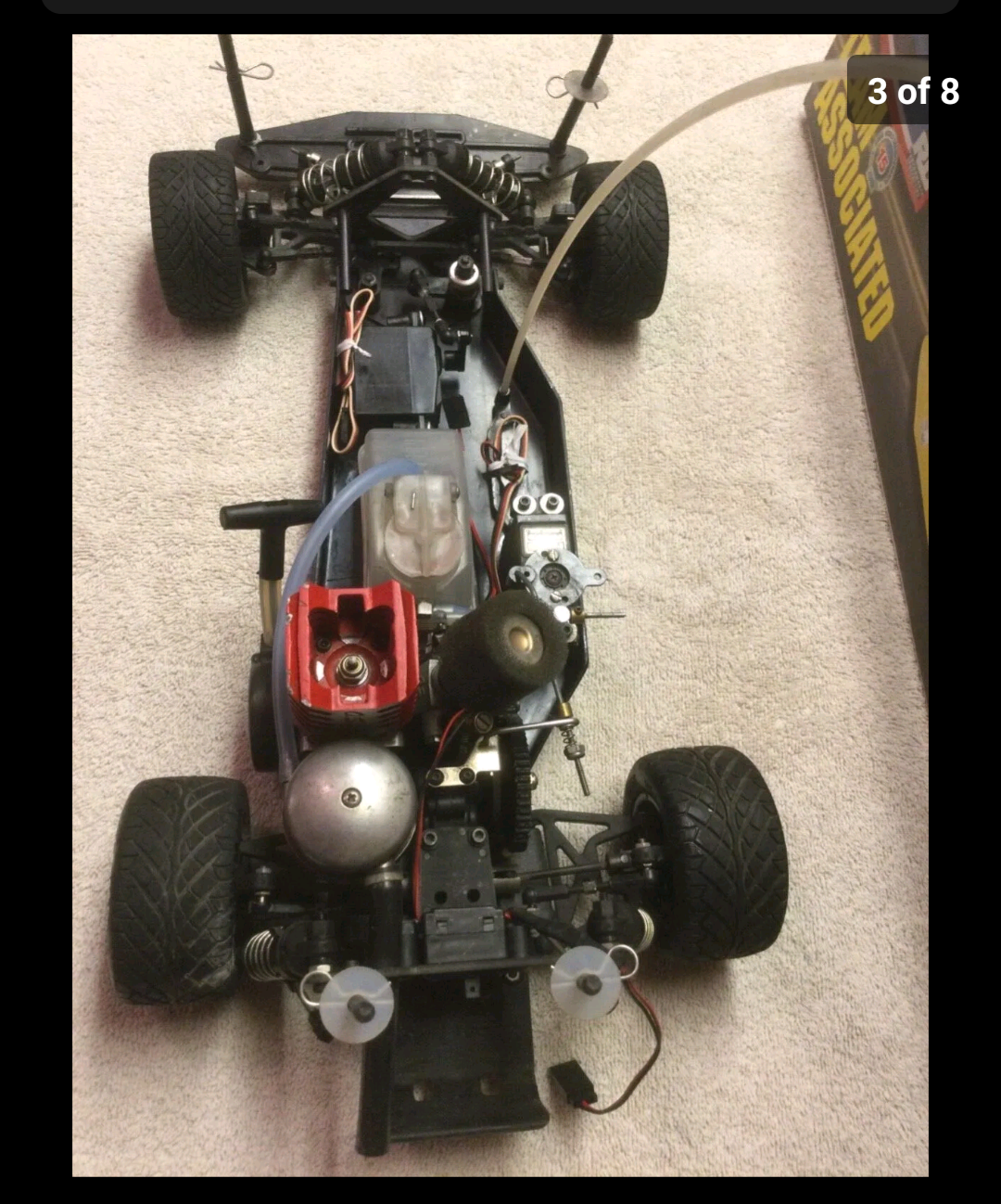

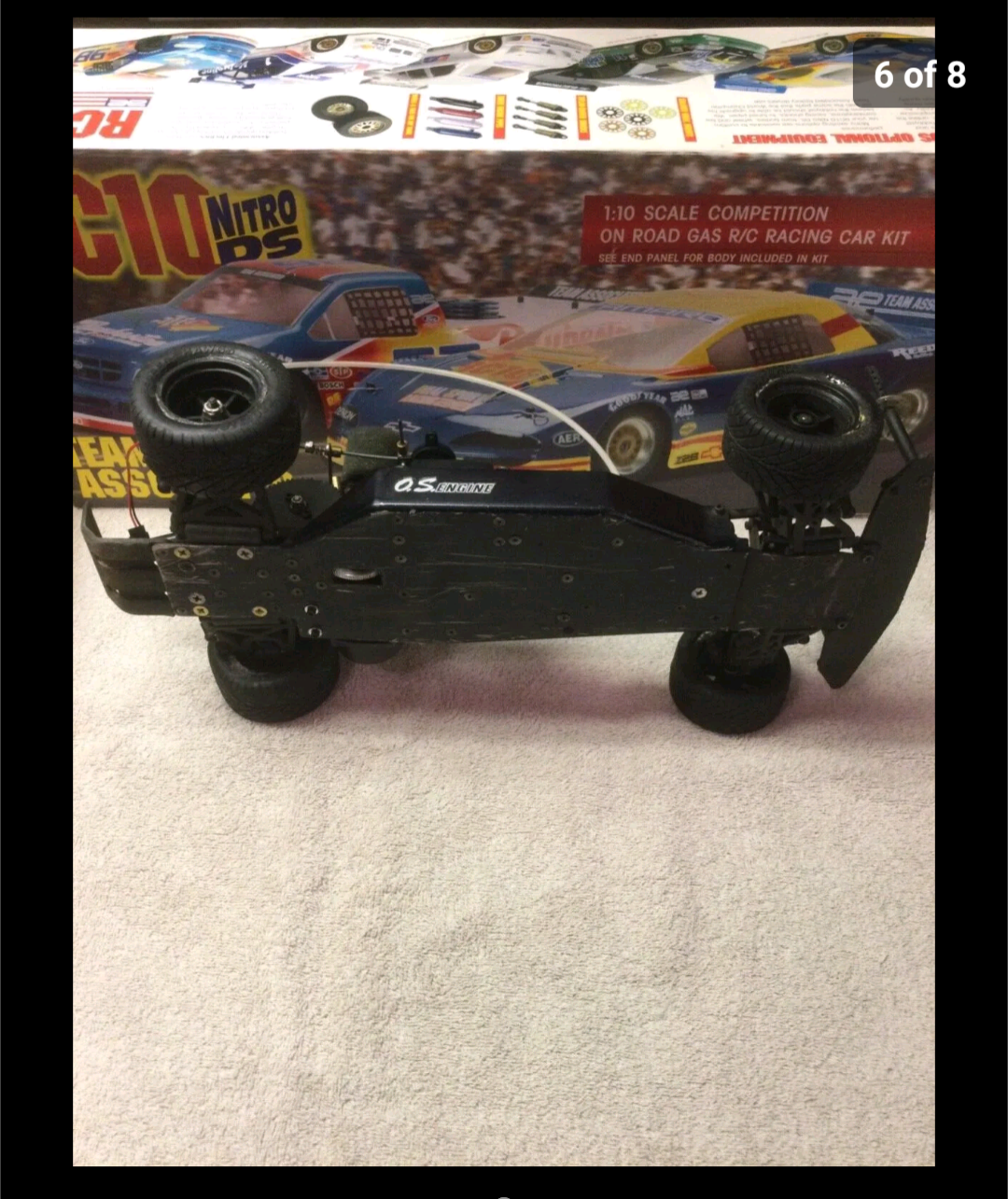

My search skills might be failing me, but what is involved in converting a nitro RC10DS into an electric DS?
Maybe need:
B or C stamp chassis
Buggy stealth gearbox
Motor plate
Rear shock tower
Rear bulkhead
battery cup
Anything else?
Maybe need:
Motor plate
Rear shock tower
Rear bulkhead
battery cup
Anything else?

Yeah, all you need is a motor plate for the GT.
The chassis is shorter than the GT though, so you may have some issues with getting the electronics/battery to look like they're meant to be there.

Chassis tub, rear bulkhead, rear tower, rear arm mounts, battery box, antenna mount, 2.25 trans w/motor plate, trans brace. Think that's it.
IDK if the rear body mounts are different at all.

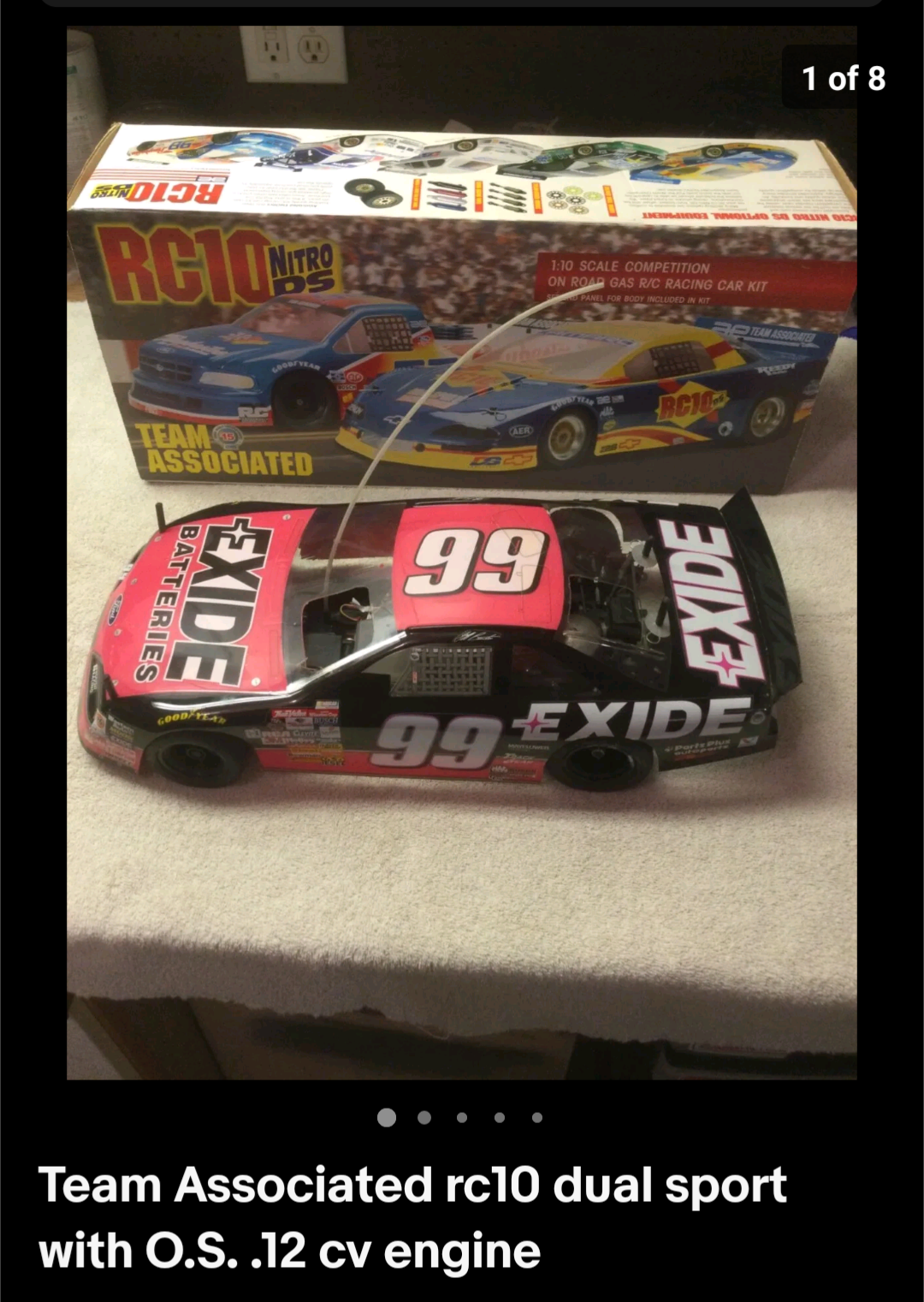

Moo ahh, ah ah ahhh.... The future electric DS has arrived. The Exide Batteries decals seem like fitting foreshadowing of the future.

It's not like I'll be cutting, grinding, etc, just part swapping. If I come across a good deal on an electric DS, then the nitro probably stays nitro. But that Exide body is kinda egging me on to electrify.
