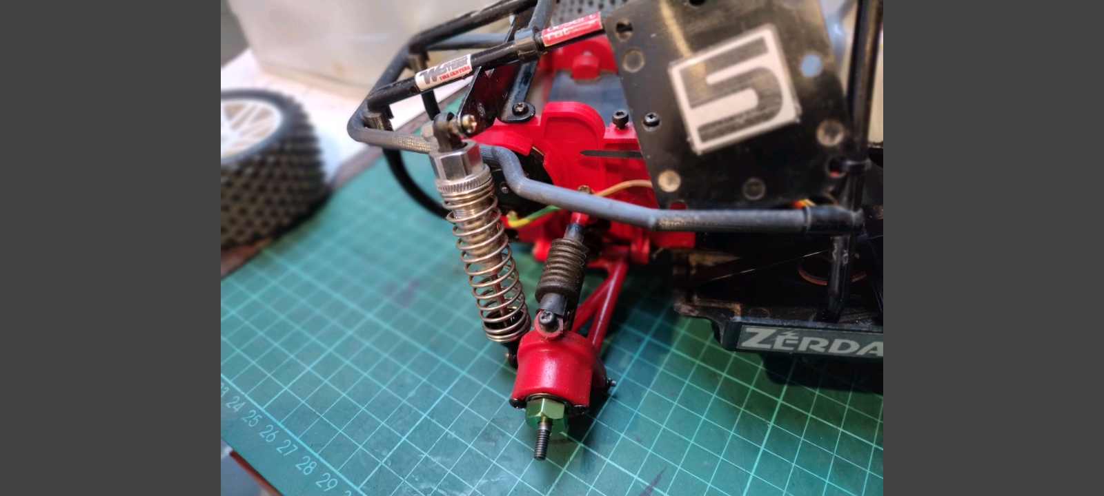

This shows front anchorages zerda and 44B
Rear zerda shock plate orientation allows cage around the shock.

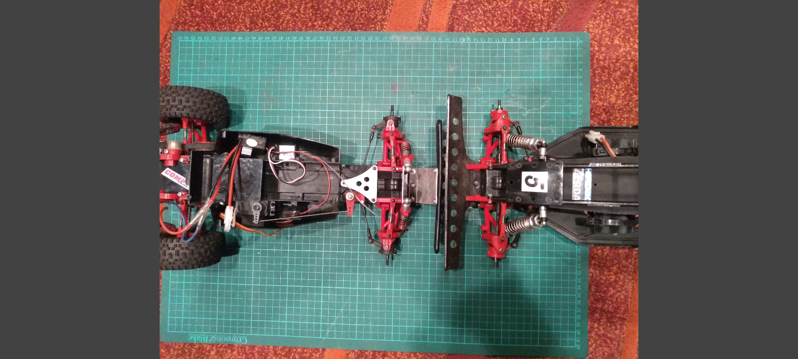

I did not touch Fusion 360 this afternoon. Deployed a table in the living room in order to deal with the tear down...
I decided to tear down the two cars.
This is the 44B-SWB in parts
At the end I separated the parts which require modeling for both Zerda and 44B chassis (or actually those which were not yet modeled). Here is essentially what is left on the plate at the end.
In terms of belt, for the motor end :
44B : MXL 91-6.4
Zerda : MXL 92-6.4
For the central belt :
44B-SWB : MXL 280-6.4
44B-LWB/Zerda : MXL 336-6.4
It seems the servo horn on the Zerda was fix to nothing. That explains a bit of things.
And it's not the sole issue of this car, unfortunately. The Zerda has lot more issues than what I could see initially. There will be much more work than expected.

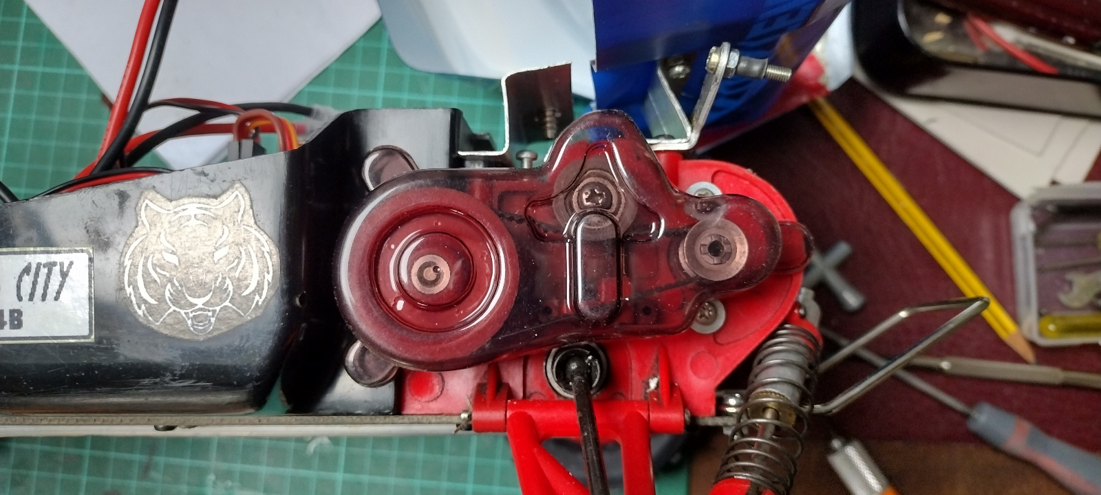

Some plusses and minuses. Zerda deck a bit butchered but you have parts which didn't survive on my two zerdas. Greater sense of achievement when you get it running. Will you be aiming for original electrics or modern ESC etc

Thanks for that picture, that confirms it is possible, like on the Zerda, and as well the explanation you gave on Facebook seems totally plausible... I asked many of my friends around, and no one have a 44B with a belt pulley cover...threesheds wrote: ↑Mon Nov 07, 2022 6:39 am CT90 belt cover offered up to 44b . Would fit with careful trimming
At the end, I found the reason, in the first Model Cars Monthly I scanned more than a year ago. Aprli 1984. There was a track test of the 44B rock'n city (you can find that track test review here : https://www.overrc.com/vintage/documentation/archives-de-mike/Hirobo%2044B%20Rock'n'City%20MC%20(1).pdf on overrc.com). In this magazine, the same month, few page before, I was able to find an advert that is actually explaining it completely.
CT-90 Belt Pulley Cover was an option, available when the rock'n city was released on the market. That explains the lack of hole on the bath tub, as well with the fact the cover was not trimmed and drilled out of the packet. This required some search and took a bit of my time today.
