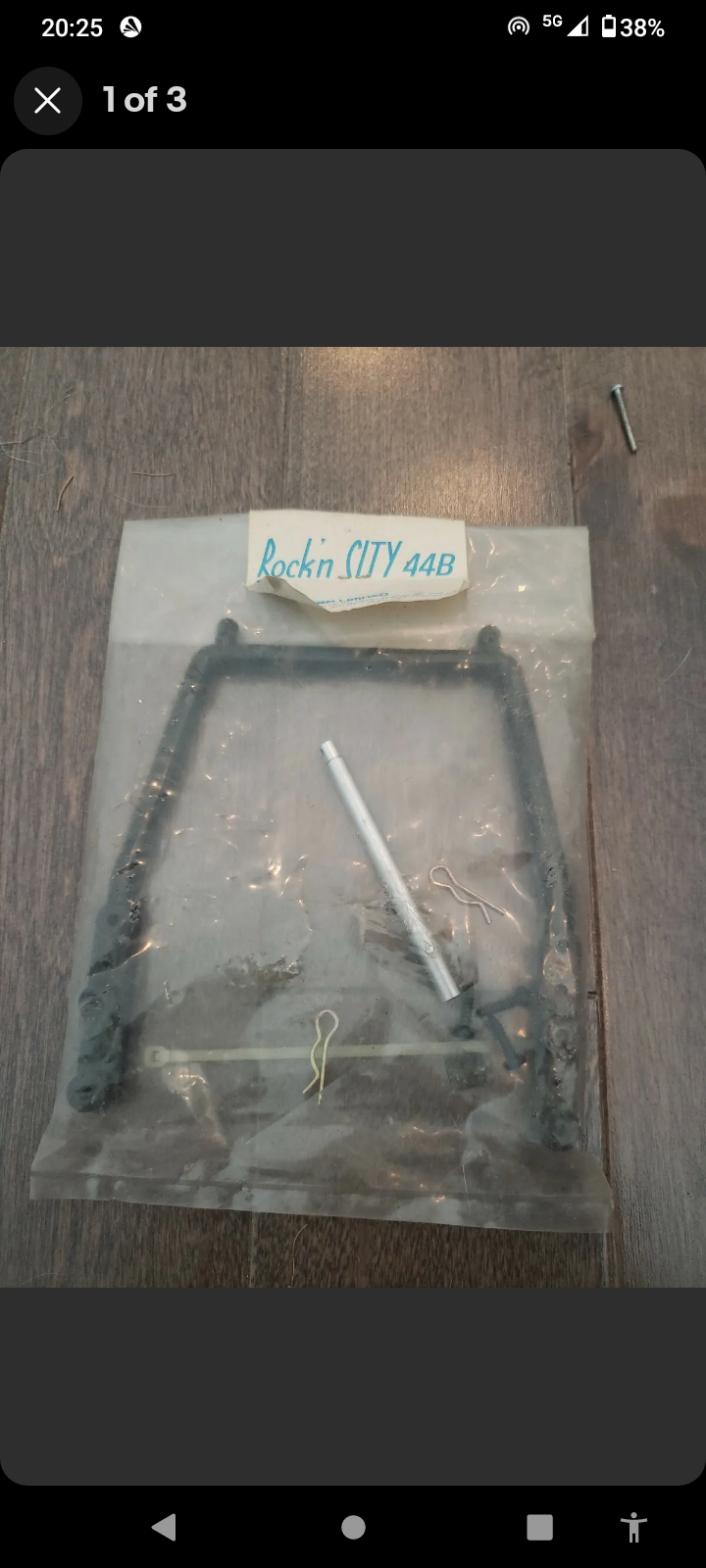

There's a roll bar/body support at the rear of the battery box and a support post goes on the centre bolt of the bumper fixing points.have you got them or do you want dimensions.
Also alternative body posts kit for other body options.

threesheds wrote: Thu Dec 01, 2022 3:27 pm There's a roll bar/body support at the rear of the battery box and a support post goes on the centre bolt of the bumper fixing points.have you got them or do you want dimensions.
I got a City roll bar, and one of my friends gave me the front body post dimensions for the City... It's in the model already :)
