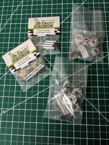

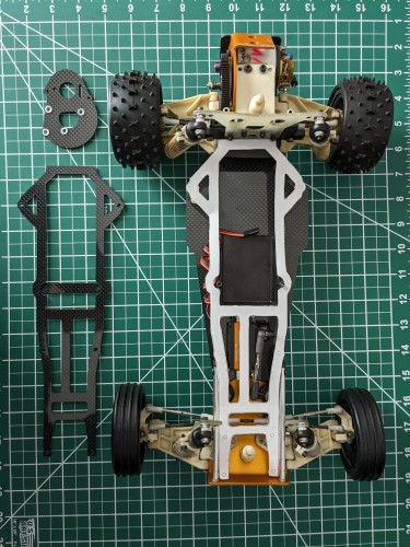

Parts arriving! Once I get the standoffs I can start work on the front end attachment blocks.

I was going to do exactly that but I've got some No Coast stand offs on the way. They have a nice flare on the ends. And I'm also an expert in breaking off taps in that tubing when I rush things too much. I've got some tap lube now and know I should back off to break the chips and periodically back out to clean out the flutes, yet sometimes I still get stupid.

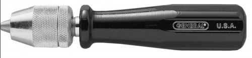

Open the tubing up with a 3/32 drill bit and hold the tap with something easier to control.
I use this.

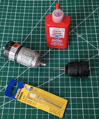

This is my current tap setup for the tubes. I possibly should look into higher quality taps, but with something as small as 4-40, if it gets rushed in aluminum it will start galling and load up the cutting teeth of any tap pretty quickly. If I did the tapping with everything submerged in ice water, maybe that would help...

I've been using Bosch taps lately. They seem a little better than Irwin. The pre-drilling to 3/32 makes a huge difference (a little larger than standard). Instead of cutting oil, I use Corrosion X.

McMaster Carr sells industrial quality tools. For a 4-40 tap, a 2 flute is best for aluminum and they are not terrible on price.
Use fingertip control for small taps...... Wd40 also works great for tapping aluminum.

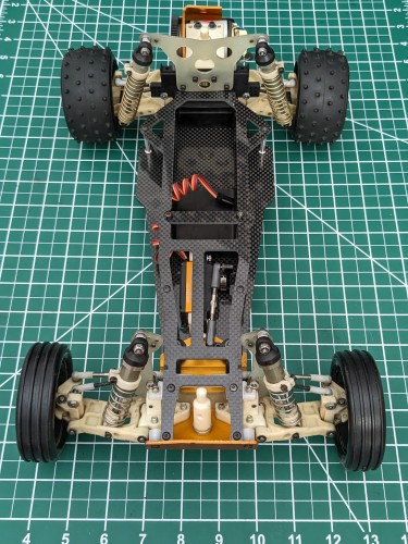

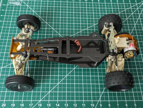

Upper deck is installed and I like how it turned out. Goodbye nose tubes, hello carbon fiber! I also put on some AE TQ tires in place of the Losi tires.

Looks pretty menacing, nicely done 8)

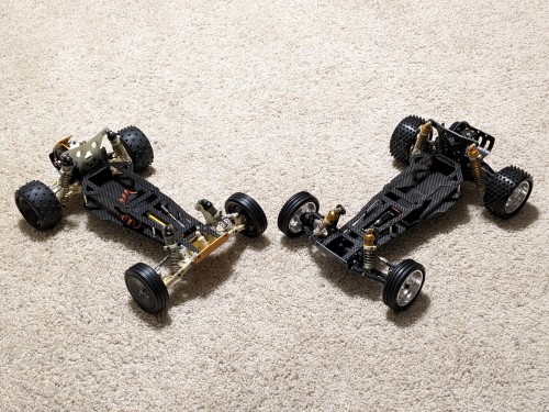

Re: Converting RC10 Graphite to RC10 Graphite Replica
An evil twin happened...
