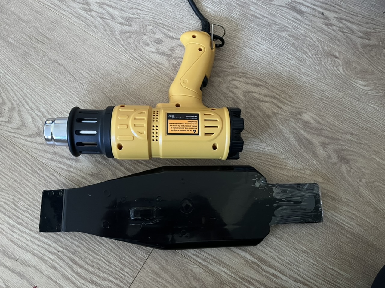

I am starting out by using glossy automotive wrap around the chassis. The wrap will protect the original plastic from chemicals and will release from the plastics. This will also give a scratch free surface for my molds.

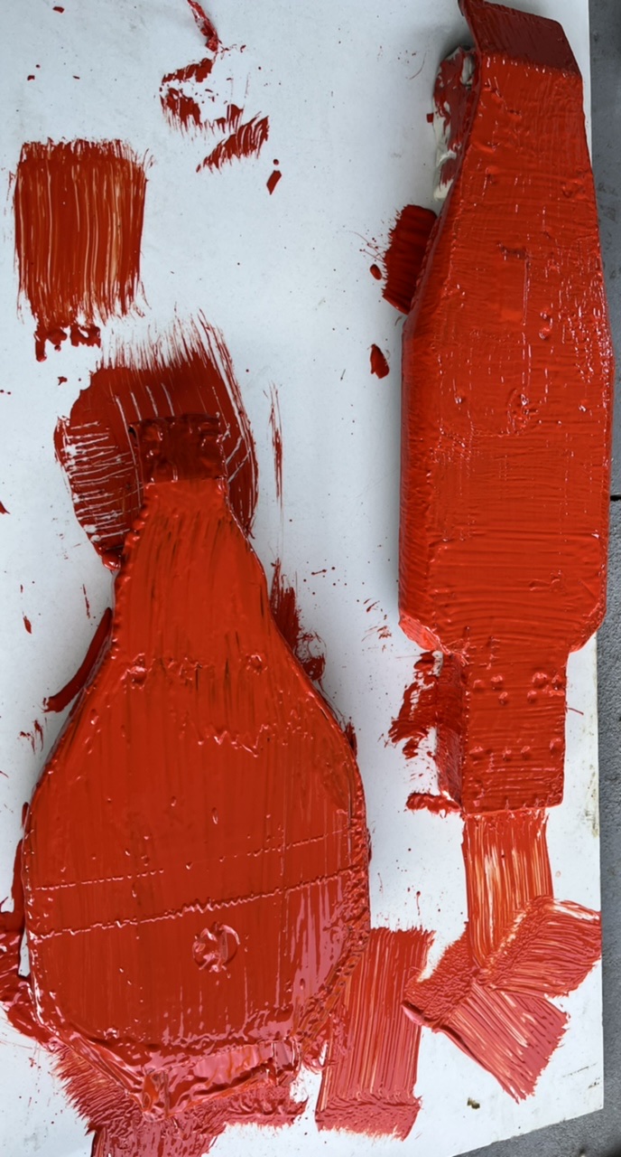

The main way I plan on improving the results is to make better molds for the process.
I am using an orange polyester tooling coat. This will be the surface of the mold. It picks up details on the surface very well and forms a hard surface that should stand up to making a number of pieces
I used a special chemical release agent and applied 4 thin coats of it.
Then I mixed up the gel coat making 1.5 oz of coat using 18drop of hardener. It smells like liquid bondo.
I painted up the piece and think it’s not correct. I used a chop brush and it didn’t lay down a smooth layer. I have heard that painting technique is critical. I’ll find out.
The orange on the board is so that when I check to see if it’s dry I don’t poke at the actual work piece.
So I’m going to have to do a lot of projects fast. The unopened can has a 3 month shelf life… so I’ll have to use all of the tooling gel and I figure in about a month. It’s a big change from epoxy that I kept for a decade.

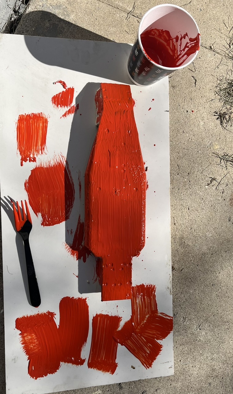

I got to take my first look at the orange tooling gel coat.
There was a sizable piece in the mixing cup that had cured overnight. The gel shows extremely fine details. It copied the matte texture of the cup. I have a feeling it will reproduce details an thin as finger prints. At this thickness it looks very smooth and continuous.
The side not facing the cup looks different. It is shiny and has numerous pinholes in the finish. There were none on the mold side, but I think I will need to look out for that.
The material is pretty flexible, not at all rigid. I expect it to get more rigid as it cures longer. It’s strong for it’s thickness but I was able to tear off the piece in the photo by hand.
The problem I was having with a smooth coat may not have been the brush. The chemical have a specific do not use below 70degrees F label. When I was mixing this up it was in the high 60’s at the most. It may flow nicer at a warmer temp.
It’s also highly flammable so I can at best keep it at temp in a water bath. The amount of flame warnings is making me think I can’t use my heat gun to work out pinholes from the finish like you can with epoxy.
The smell of this stuff is strong. Even when working outside in the clear open I think I need a respirator.

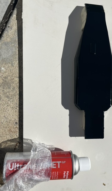

Finally warm enough outside to do a second gel coat on the 8090 and a first on the rc10t4.
I see why it’s recommended to use a contrasting color for the gel coat. I can easily see any area missed as the black shows through the orange
I see some wrinkles on the t4 gel coat and I think it’s due to the wrap underneath. I feel like the 8090 got a nice layer. Hopefully it stays warm enough that in an hour I can do another coat of gel on the t4 and a fiberglass layer on the other.I see why it’s recommended to use a contrasting color for the gel coat. I can easily see any area missed as the black shows through the orange

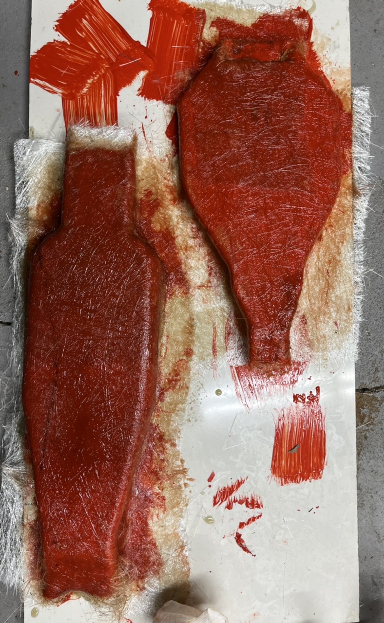

There is a non 0 chance that I have encased and rpm 8090 chassis and an excellent condition t4 carbon chassis in a block of polyester resin.
Once the gel coat layer is down the regular fiberglass resin can be used in lower temperatures.
The gel coat was slightly easier to apply than my first go around. I spent some time and heated up the can before I made my first application.
Supposedly you can use some acetone to thin polyester resin. I didn't do this for the inner gel coats because the tooling gelcoat contains other materials and I didn't want to risk the finish. Once the second gel coat was on the t4 I mixed the remaining gel coat with regular resin and a few drops of acetone to thin out the mixture. Hopefully this is fine because it is an intermediate layer.
Instead of using fabric I was using chopped fiberglass mat. This was easier to conform to shapes in the chassis than any fabric i have used. Once it get wetted its extremely pliable. I think I may have some air bubbles between layers. That may weaken the mold in spots when I try and use it. It also was able to wrap around the chassis edge a bit that may make it difficult to remove.
Overall this process was quicker and easier than my previous attempts.
Tomorrow will be exciting, or expensive.

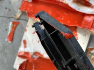

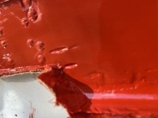

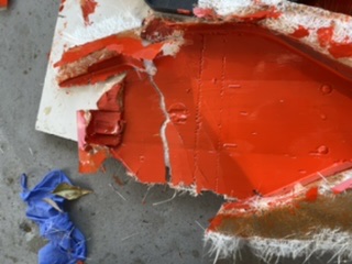

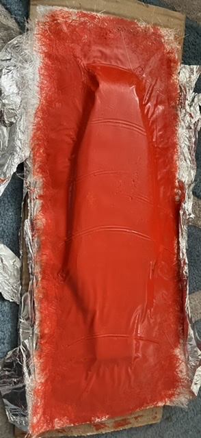

2 coats of release is insufficient.
The wrap adheres to the gel coat
Any gel coat wrapping edges makes removing the mold impossible without cracking the mold.
The graphite appears to adhere to the gel coat
- Posts: 1874
- Has thanked: 1243 times
- Been thanked: 639 times

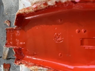

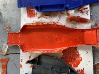

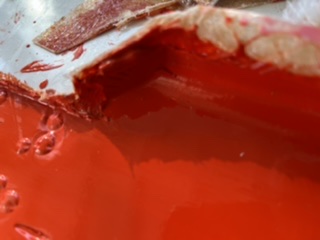

Re: Making a carbon fiber chassis the beginner way

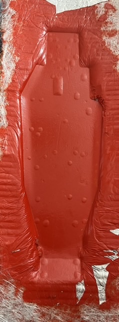

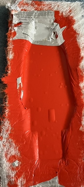

The t4 stuck was stuck to the gel coat and that is a what wrecked that mold. I had to shatter it places to get it off.
There was some obvious puckering of the wrap under that gel coat. When remolding the wrap pulled away from the chassis before it pulled from the gel coat.
There are some small bubbles in 8090 mold. Over all it looks good. Although it will need a lot of work. The corners aren’t well defined. There are some small bubbles in the surface that I can fill and with gel coat and polish up. I am most worried about the sides bring different heights.
I think I will start again on making the molds with much better flanges. And use some of the gel coat to try and fix the surface of the existing mold.
The clay I used seems to be reusable. So I can start there.
I am not sure if I want to use wrap again or just use the straight nylon chassis.

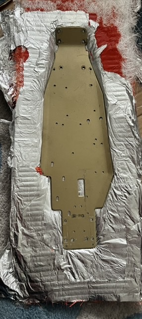

I went a step easier and went for a blue gt chassis. I ran out of regular wrap and switched up to aluminum foil. I sprayed it with some contact glue and glued it to the chassis and some cardboard backer. I did 2 layers of aluminum to smooth out some wrinkle. The final mold has some defects around the corner where the motor mounts.
I used 2 layers of fiber glass mat and vacuum bagged the piece for it to cure.
All in all this piece look like it should function. I need to polish the mold since the aluminum left lots of wrinkles but this looks completely useable.
I can actually start making chassis now.
