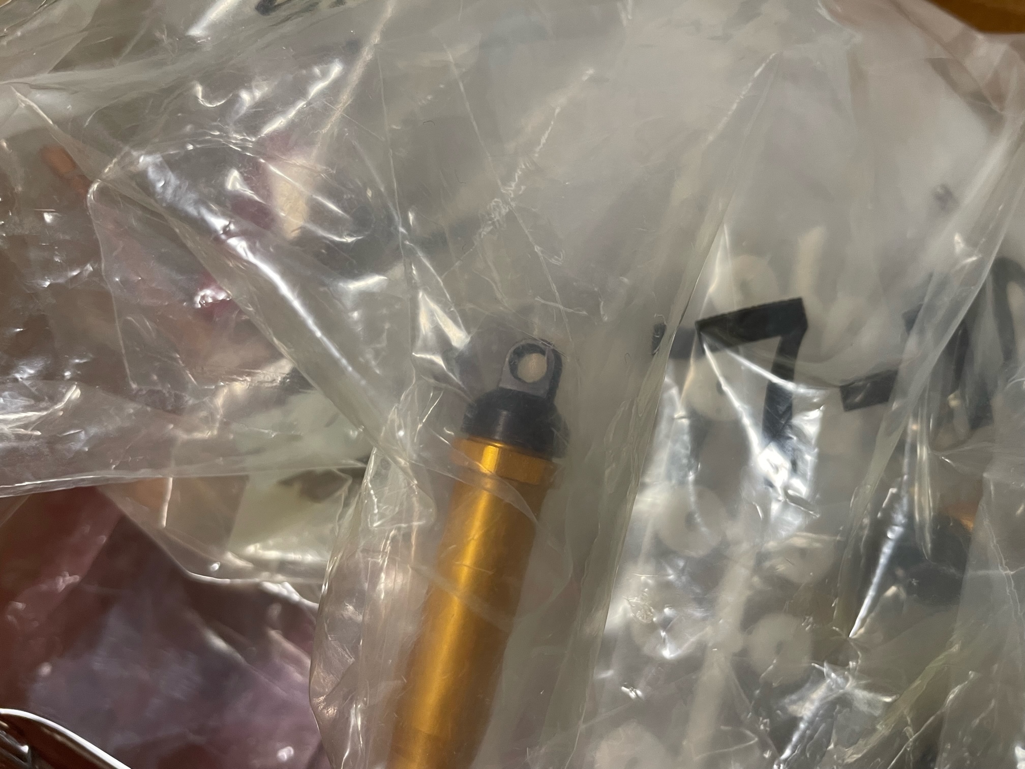

Attached are pictures for reference.

jcwrks
Posts: 674
Location: San Angelo, TX
Has thanked: 171 times
Been thanked: 393 times
Re: RC10T Team truck shock caps
Post by jcwrks »
marlo wrote: Wed Feb 15, 2023 5:54 am I believe all sport trucks had plastic caps, gold body's
Nib 7011 kit, sealed parts bag, with white plastics and black aluminum shock caps. It has a Reedy Outlaw stock motor as well.
