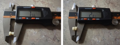

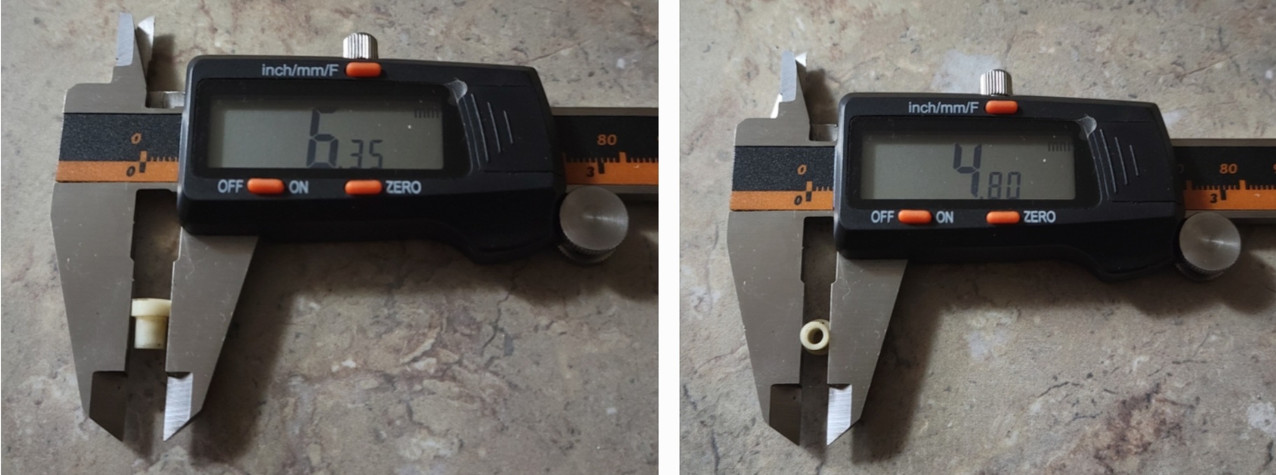

I'm looking for information on shock mounting bushing for gold pan rc10's.
It looks like at one point a common style nylon shoulder(plastic bush/step washer) washer was replaced with a custom molded part
Were these types of bushing actually used? The i/d should be .115" for a #4 screw. Does anyone know the overall length and OD and thickness of the flange.

Re: Shock Mounting bushing
Click on pics.
Post by JosephS »
juicedcoupe wrote: Mon Mar 13, 2023 3:50 pm Click on pics.
7.56mm =.297" Height (total length) ~19/64"
2.81mm = .110" Thick (flange thickness) ~1/8"
4.75mm= 3/16" shoulder length
6.35mm =.25 OD
4.8 mm= .188" Sleeve OD ~ 3/16"
Thanks. It looks like this may be the closest fit
https://www.mcmaster.com/91145A228/
https://www.mcmaster.com/91145A317/
https://www.grainger.com/product/GRAINGER-APPROVED-Shoulder-Washer-For-Screw-4DCL1
