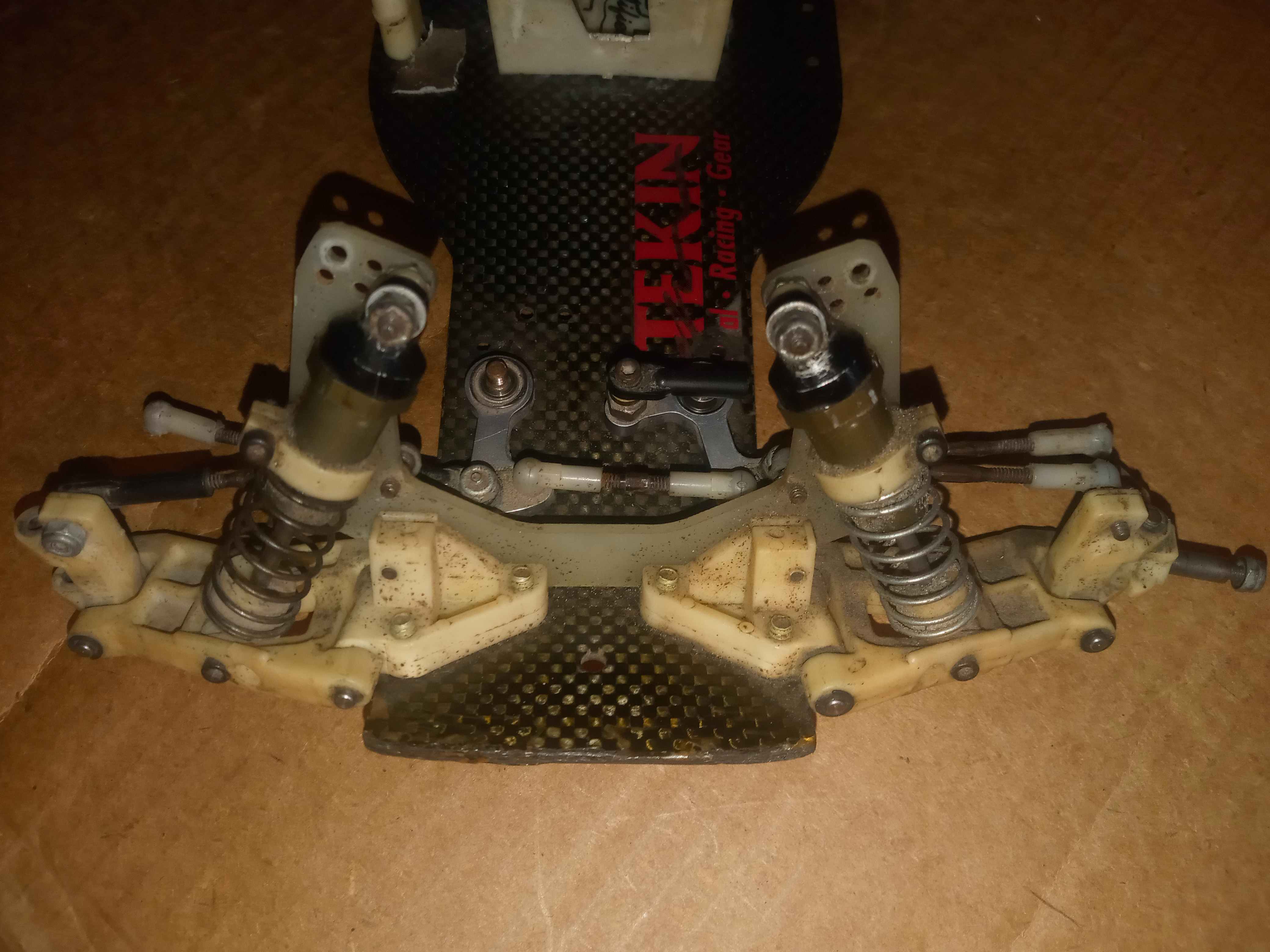

I'm rebuilding an RC10 Team Edition with a carbon chassis and I just discovered that one of the nylon internal split snap rings is missing from one of the rear shocks. Anyone have a source or something that interchanges? I see they are included in kit 6430. Are the ones included in kit 6440 compatible? Is there anything else that may work from Mcmaster-Carr or something? I've attached a pic of the style of shocks I'm dealing with. Thanks!

the 6440 are the newer versions, and although expensive now they will be easier to locate. I do not know of a part that would work in place, but someone may have a spare to offer up.

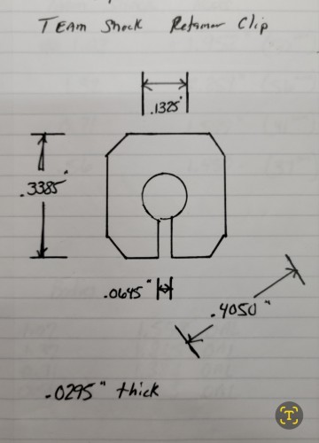

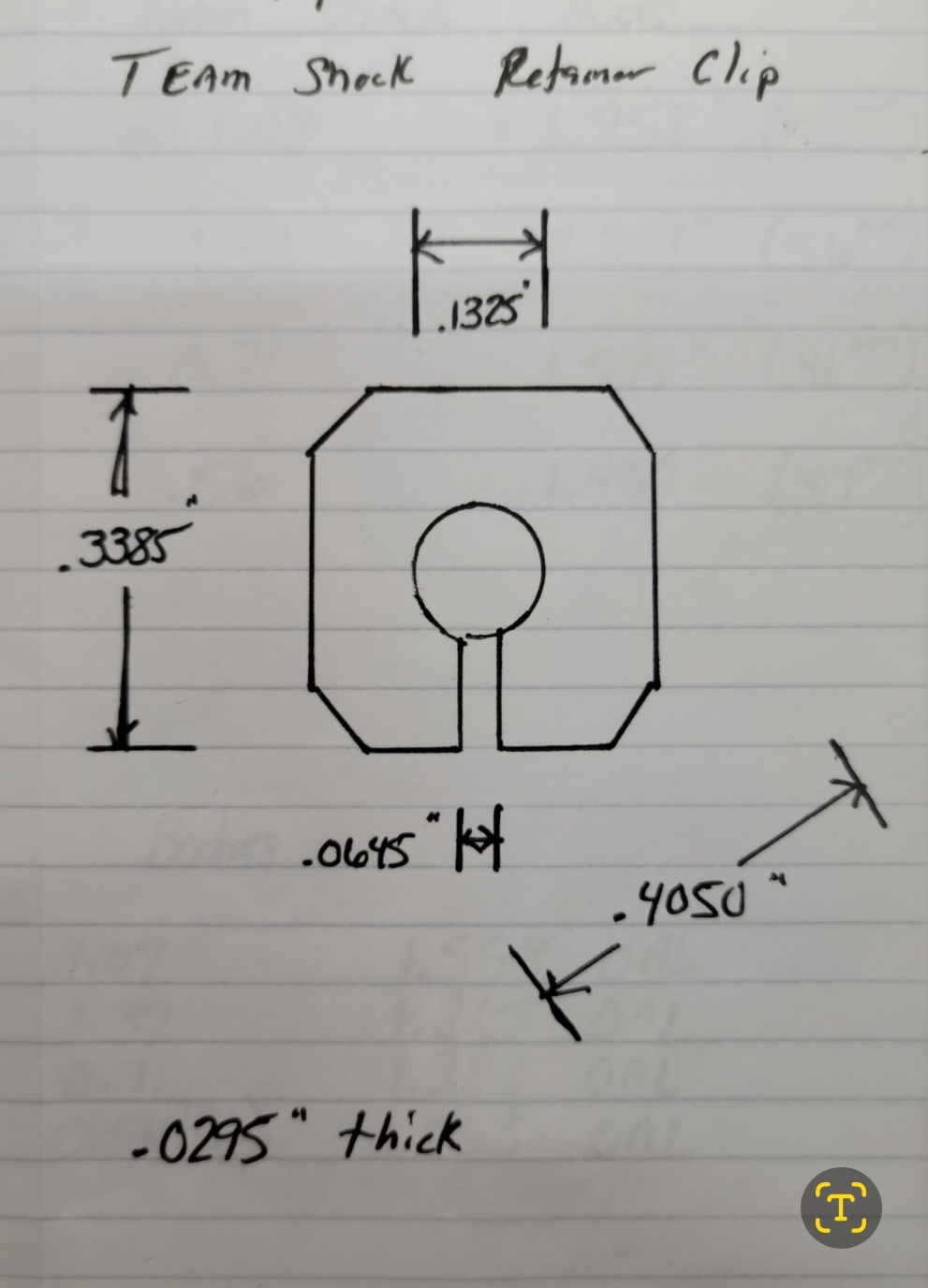

Here you go.
I took these measurements a few years ago. But then I came across a stash of shock parts.

juicedcoupe wrote: Thu Apr 06, 2023 8:27 pm Here you go.
Ya know, looking at that sketch, I'd probably draw them in CAD, print a paper template, stick that to a sheet of styrene of the correct thickness, drill the holes and cut them out using an exacto knife. I'd forgotten just how simple are those clips.
