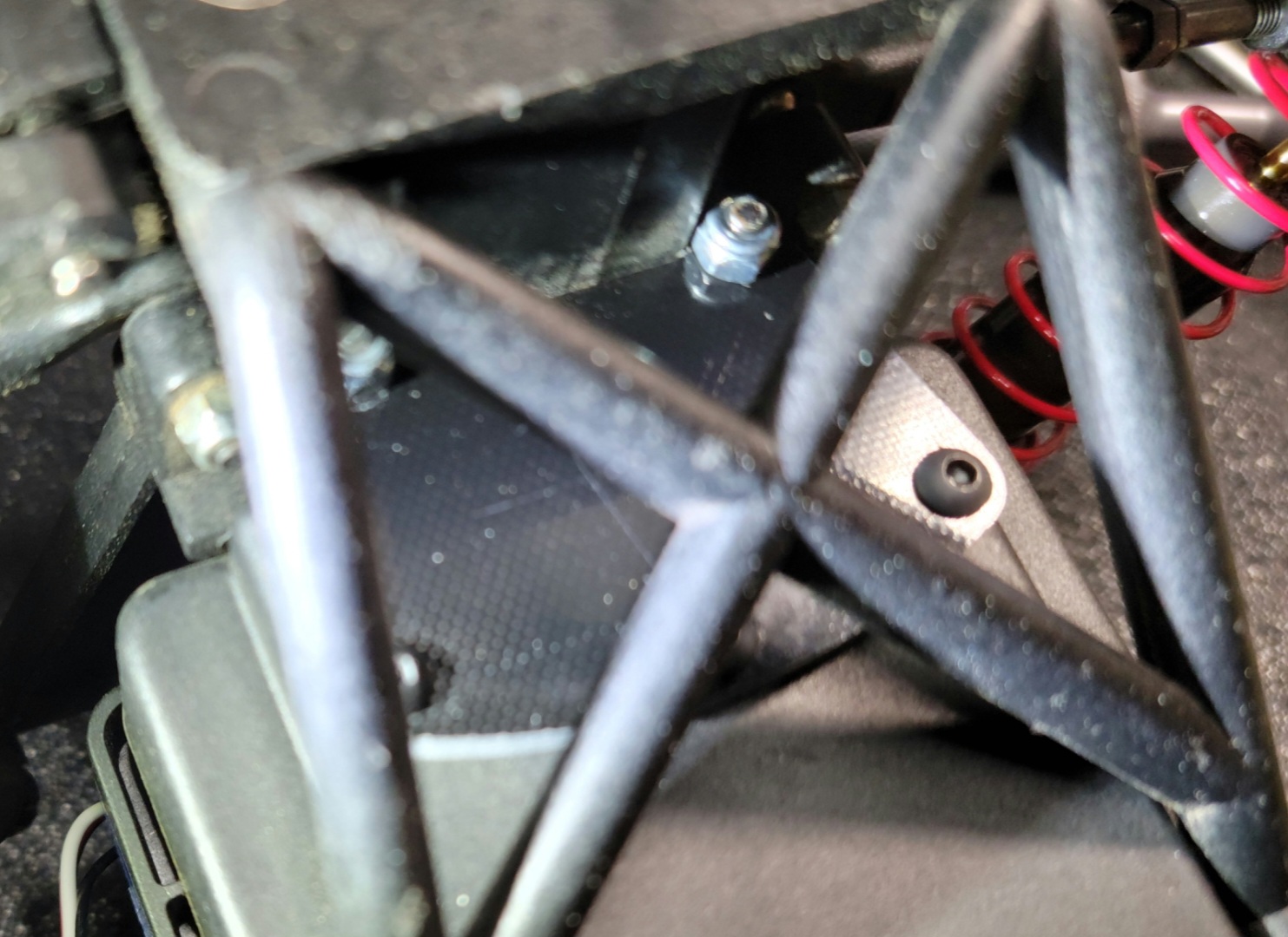

Made this shelf to mount the receiver inside the chassis and keep out some of the grass and sticks.
Made a bracket to attach the dust cover to the chassis, bracing the shock tower.

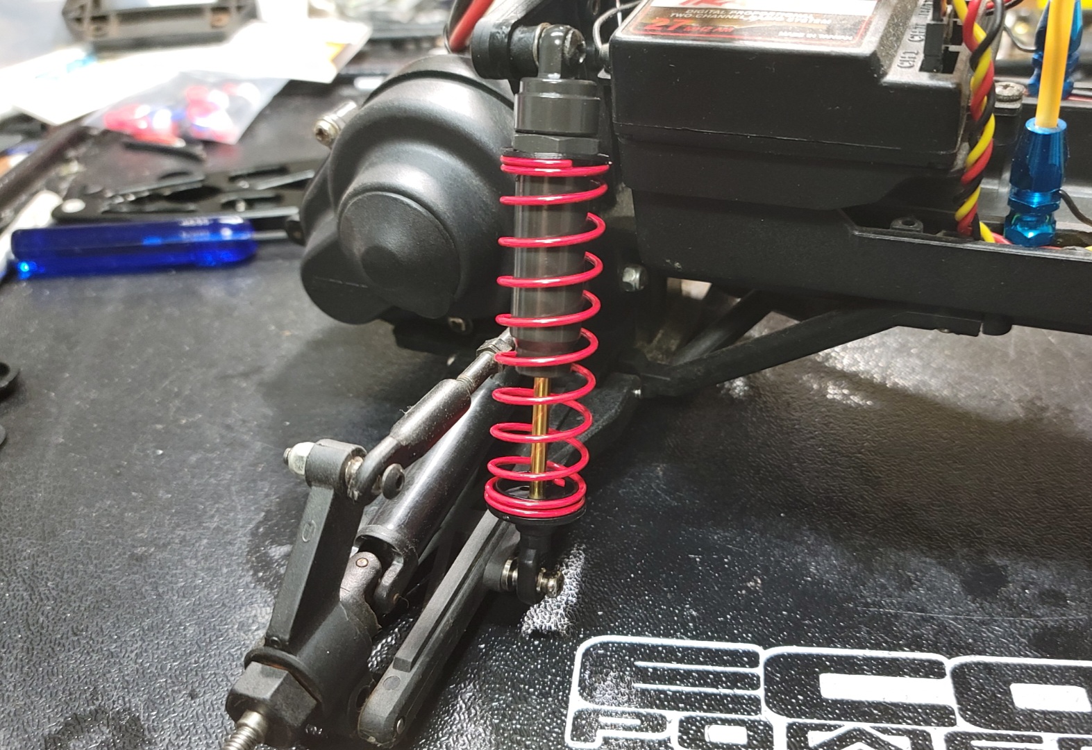

Dug out some spare clips and got the shocks built.
Rebuilt a set of Traxxas "Big Bore" shocks (not really, but that's what they call them). Used some 3D printed collars from Frankentruck to allow the use of larger (and much more common) Traxxas Ultra springs.
Then I installed them on my Stampede, with a Factory Works front tower (for long shocks). Also visible is the Pro-line wide front arms, carriers, and steering blocks.
Rear. Also visible are the Nitro Rustler rear carriers, which are more robust and have better geometry than electric versions.
Also added a Factory Works chassis brace.
