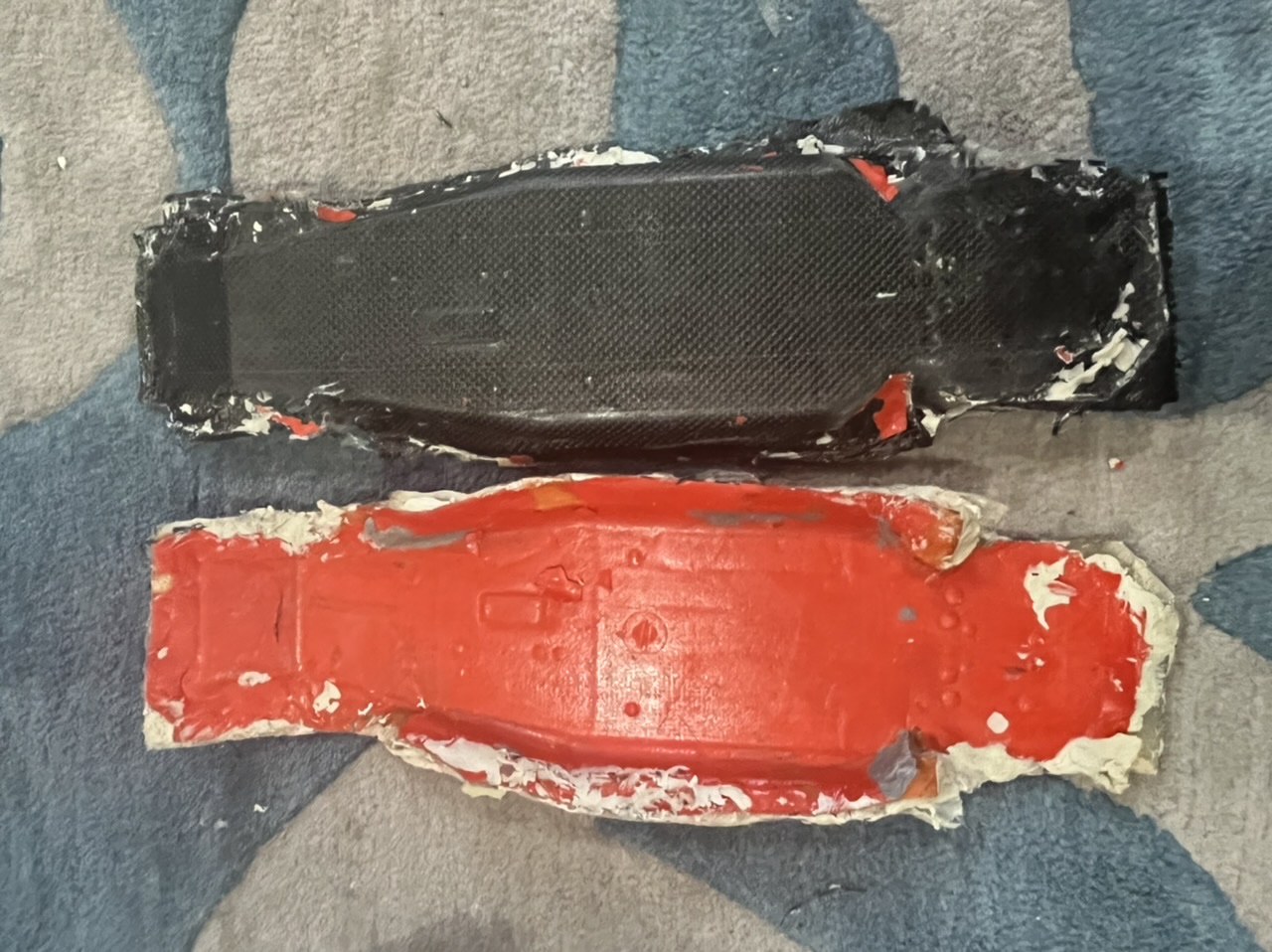

- Posts: 1874
- Has thanked: 1243 times
- Been thanked: 639 times
Re: Making a carbon fiber chassis the beginner way (part2)
Great result.

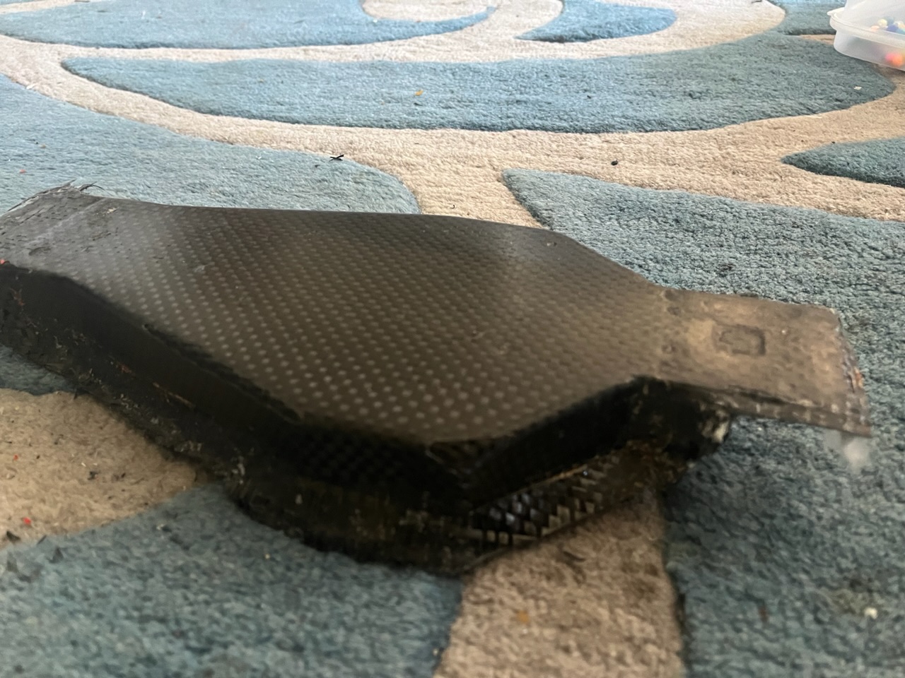

Notes:
This build hit 2.1mm. Target 3.0 mm for flat chassis. 2.1 for tub style chassis.
The resin saturation was good and very few pinholes
I wonder if I revered the resin to epoxy ratio in my notes.
Note: Having consistent resin issues.
Unbagged
The demolding was difficult. I need even more release than was used, some spots of the mold surface peeled off.
Attention needs to be paid to make sure things don’t wrap around edges. Made it harder to release
Note:
Release wax needed to be applied MUCH thicker. As pieces needed to be cut closer to size.
Trimmed a bit.
Looking at this compared to my effort a year ago this is much better. Nearly professional. The clay kept the interior corners smooth and perfect. I think the wrinkles in the interior surface will go away if I use a breather cloth above the release film.
I will see if I can rehabilitate the mold and make another one or two pieces.
The quality of the gel coat piece is excellent but I am not making robust molds. Ideally I would make 10-20 for the effort in making a single mold.
Note: Mold had issue on tooling gelcoat application. Was successful with 3 layers of gel coat.

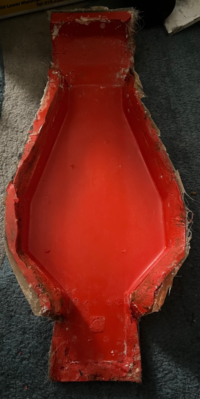

- Posts: 1874
Found someone to talk for help on molding parts. This was the shop decoration.

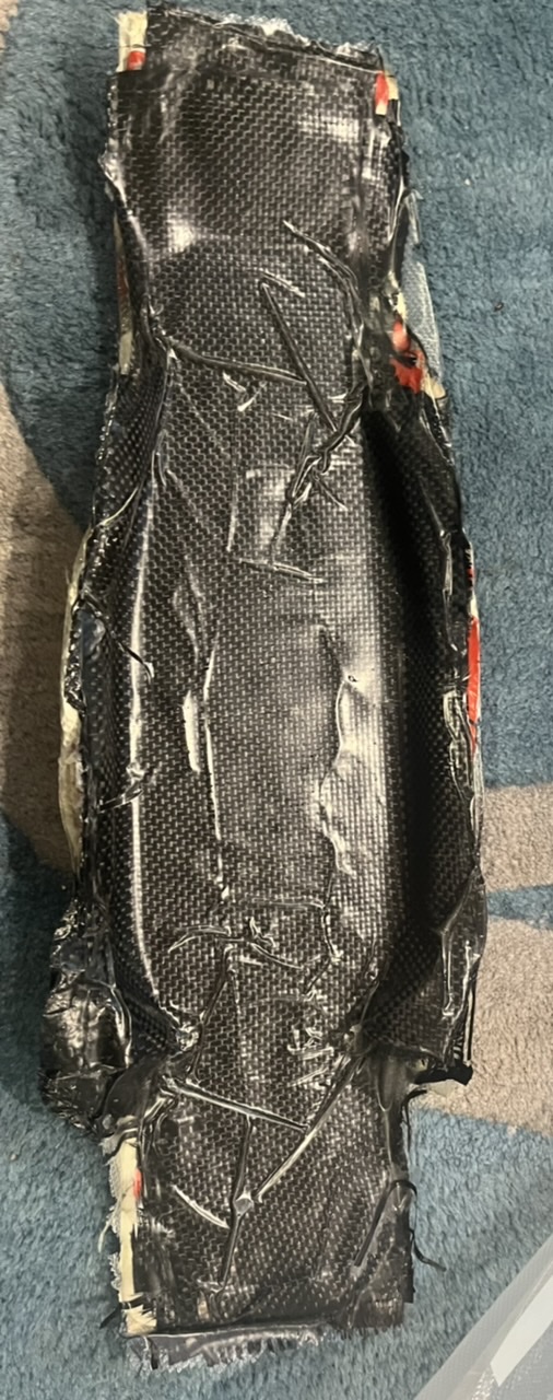

- Posts: 1874
Well that worked
Bottom
Inside The vacuum failed on readiest bag. I think the chemicals from the process make it impossible to reuse a bag.
The chassis is 2.4 mm thick. A bit dry on epoxy, but that was due to technique. I used a spreader to draw out epoxy. That was too aggressive.
I used 1 thick and unbuffed coat of paste wax,2 coats of man 2300 release and 1 coat of parafilm release.
I misplaced my shears and couldn’t cut the carbon to shape without them . So there are some distortions in the rear by the bulkhead support.
The mold is ready to go for the next one. I can just keep making these now.
I am going to surface finish out the 2 I made and see how well they get to the end of the process before I make more.
Full demold no damage

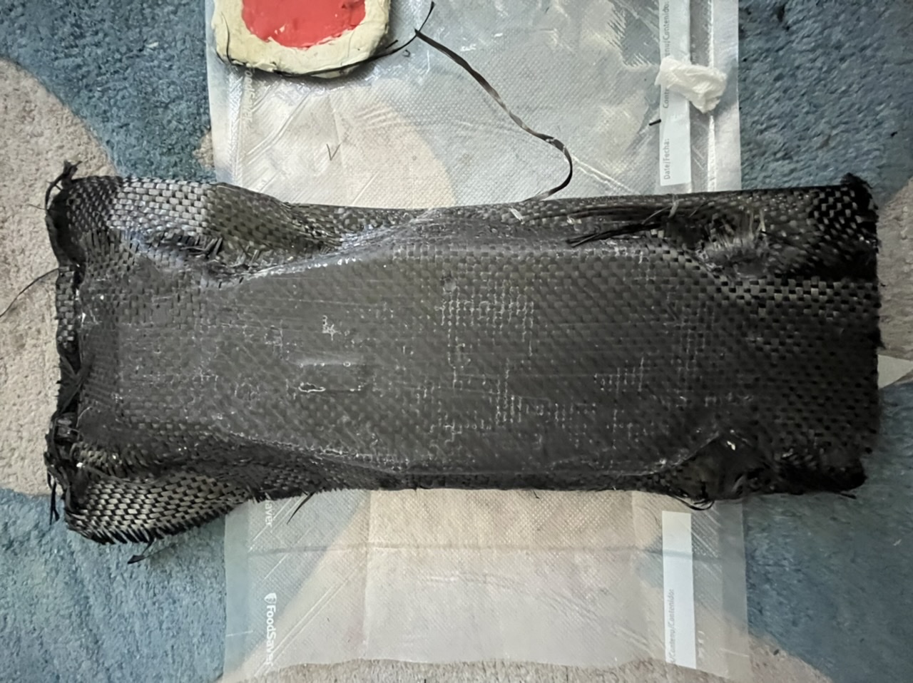

- Posts: 1874
Last attempt on this batch of material.
I went for the t2 I was successful with last year
This mold feels nice. I cast it directly on the chassis which is still scratchless.
I used 3.9 oz of fabric and made 4oz of resin, I think 3 still would have been in excess. I cut a pattern out and used that to cut each layer of material.
I think I would have needed 9 layers of the carbon fabric and I only had 5 so I used 5 additional layers of much thinner fiberglass at the core.
I added a layer of perforated release film backed with breather fabric . I also used some clay to get into the corners.
The vacuum pulled well with the single bag, but I added a second layer to make sure air leaks wouldn’t wreck it.
I can see that I didn’t use a large enough piece of release film and some of the chassis was in contact with the bag. Hopefully this was in the flange area and won’t be an issue.
- Posts: 1874
Fantastic results. With some room for improvement.
The parts need very little finishing on the outside surface. They have the look and feel of professional pieces.
As well the mold is ready for another piece with no repairs.
I am still having an issue with too much resin. I am using a perforated release film back with a breather, but the excess resin isn’t making its way into the breather. There is no fiber in the excess resin so it is easy to remove with sanding
I am finally at the point where parts are good. I see a few places to improve on this process.
Hopefully I can make a few pieces good enough to sell so I can buy more material.
The demold wasn’t to challenging even though I made some mistakes on the layup.
