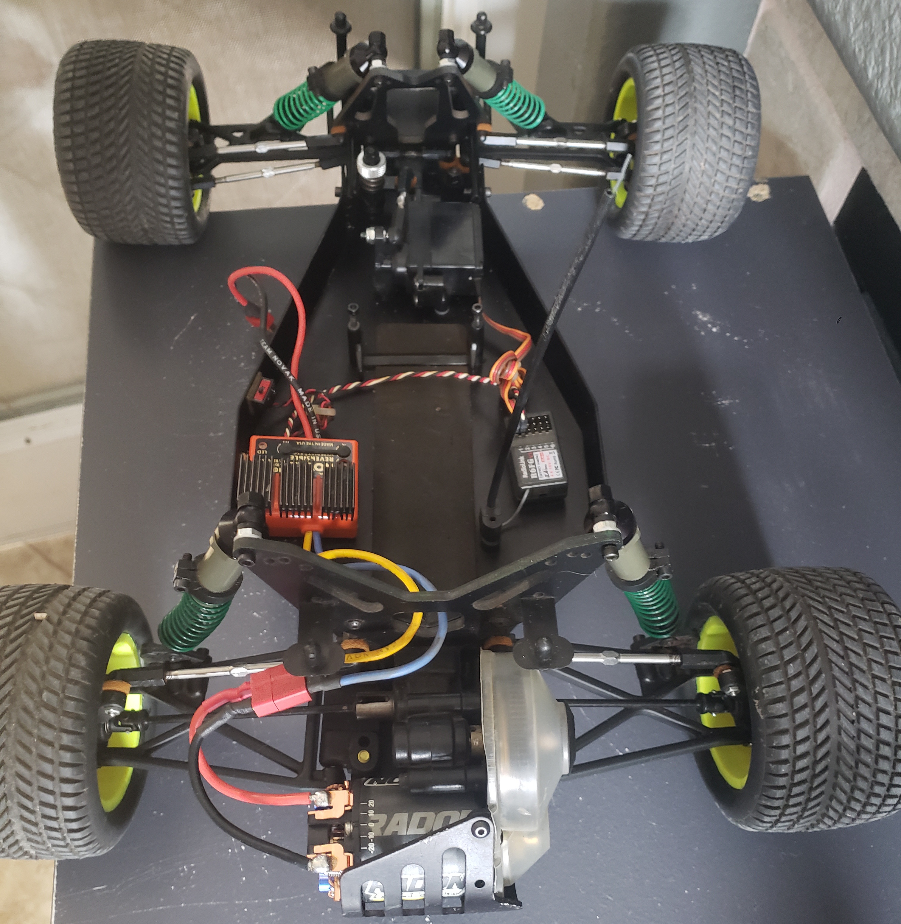

A coworker knowing I'm into rc gave me this T2. The receiver connected to my transmitter and it runs well. Can anyone give me some insight to this model such as is it stock, worked over? I know the motor is not stock and he gave me a Green Machine 2 and a Diamond 12 turn double 19.5 awg motor.
What would you all do with this, run it, shelf it. id like to run it and have a set of dirt tires and wheels also yellow, that he gave me as well.

Looks like maybe Lunsford titanium turnbuckles. The shocks and universal joint rear axles look like they could be the Team truck parts. Looks like you might need a battery retainer strap.
What sort of battery, speed control, and motor setup are you thinking? Any plans to disassemble and hydrate the nylon parts?

I have the battery strap its just not in the picture. Was thinking of running as is. can the transmission handle 2s lipo? Brushless? If not I'd run it on Nimh and keep it brushed and possibly replace the esc with something more modern.

I think it would do fine with 2s and brushless.
If you run NiMh, the Novak ESC would do fine. It's spec'd for 6 to 10 cells of NiCd cells (lower mAh than NiMh). I wouldn't run the brushed motor for more that 5 to 7 min at a time or the brushed motor will get overheated.

That is an excellent looking t2. It appears very well put together. Grab a new Nimh battery and run this. The t2 uses lots of gt parts and it is easier to get spares for than the regular t.
The transmission would absolutely handle a lipo , as would the esc The older brushed motors can have trouble with the long run times that lipos make. From my own experiences, If you want to go to lipo I recommend brush-less. I had this exact problem with a T2 I had.
For bashing in dirt you can get 2.2" traxxas tires on the cheap and a nimh battery of about 3000 mah will be about $25.

That motor is a current Reedy Radon. They are available in 15, 17, and 19 turn. They are Chinese made and bear a strong resemblance to older Integy motors. Probably better than the $15-20 motors on Amazon and Ebay but not as good as the vintage stuff was.
The shocks, universals, and wheels do point to a Team Truck, which means that it should have 3/16" axles. That means that you can get cheap JConcepts wheels. I'd check before buying.
While that old Novak 610 is a good esc, I wouldn't keep it in a runner. A Hobbywing 1060 (~$20) or programmable 1080 (~$40) are better suited. And both have lipo cutoff.

Very nice T2. Depending on how much you want to run it, I'd consider planning on a brushless setup after that Radon motor comes to an end, especially if you'd like extended run times obviously. Even though I'd have a very hard time pulling out that Novak 610.
