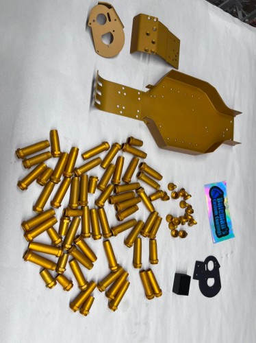

I believe you would need to remove the anodizing and clean them up prior to sending them off. Here's an example of his work.

In some cases yes. When I sent off parts to have them re anodized to Colors Inc they stripped them for me. The process was very simple. Send them pics of the parts. They sent me the quote. I shipped the parts to them. They worked their magic and sent them back.
