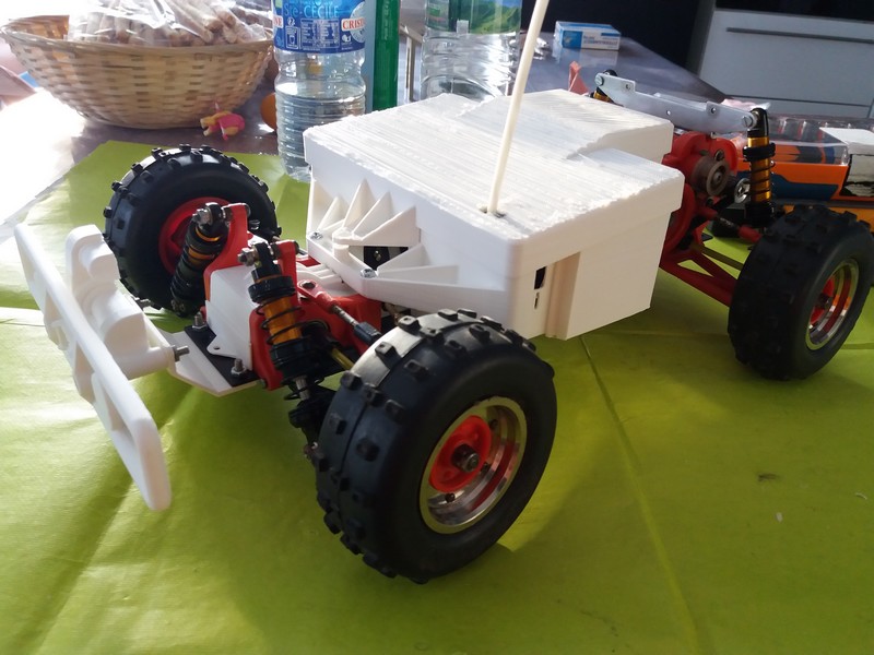

After the nozzle change, the quality of the prints is back to usual... Printed a 44B Hilux Bumper and its winch...
Aso printed a part to lock the steering servo in place, which makes the direction more precise. As matter of fact, fixing servo with double face adhesive tape is so 1983-1984 I needed to do something (if I provide this part, it will have to be a step file, so peple can modify it to suit any servo)...
Had to put the bodyshell on the chassis to see...

Re: Hirobo 44Bs and Zerda :)
I'm missing an upper arm for the 44B Long Wheel base chassis... As far as I know, there is only one piece missing for the Zerda and it is the 18T MXL pulley.
I have one in aluminium, but I believe it is to soft, as I can mark the surface easily with a screwdriver. In the meantime, that should allow me to complete the Zerda, at least, awaiting I find one of proper quality to do the job...
Beside the front gearbox wall, the build is quite similar to a 44B build...
With the same complexity for the belt path than the 44B, with a little twist...
The twist is that the chassis is so flexible than pushing down on the pulley that acts for the tension of the belt make the nose of the chassis going up...
And the fact of having the pulley cover in place doesn't really change anything to this... I put the motor which was in the car initially as a placeholder. The overall intention is to run this car, and I may put a different motor than this one... No clue yet.
The rear belt cover works also on the Zerda, and I found back an original part, so it won't be used for this car...
The overal target was to have one single picture for a publication later on cults3D... The pulley belt cover is in place with the rubber boot on the upper arm (reused the one that came with the car)...
All arms are in place... There is very little room for the front split pins...
Added the shock towers, and the bumper. I will need to find a servo for this car in my parts bin...
Basically, it misses a few things :
- steering servo and servo saver, and for this I need to keep in mind that the servo may collide with the radio plate, which is not going to ease my life...
- definitive motor and esc
- radio plate - which is theorically supposed to offer more rigidity to the chassis, but I have my doubts
- shocks - I've not decided what I do for this. I have 2 set of rear 44B original shocks in new state, some damaged zerda shocks, but I may opt for some Kyosho shocks (which may require me to work out some limiter for the range)...
- roll cage it will be black, although I would have prefered a red one...
- wheels : I have some tamiya tires that should work with the Zerda original rims (but I also have the intention to print Zerda tires at some point )
Had to clear the table for some other activities, and therefore stopped at this stage... Lot of activities ongoing, and I also need to work on the Hilux bodyshell
