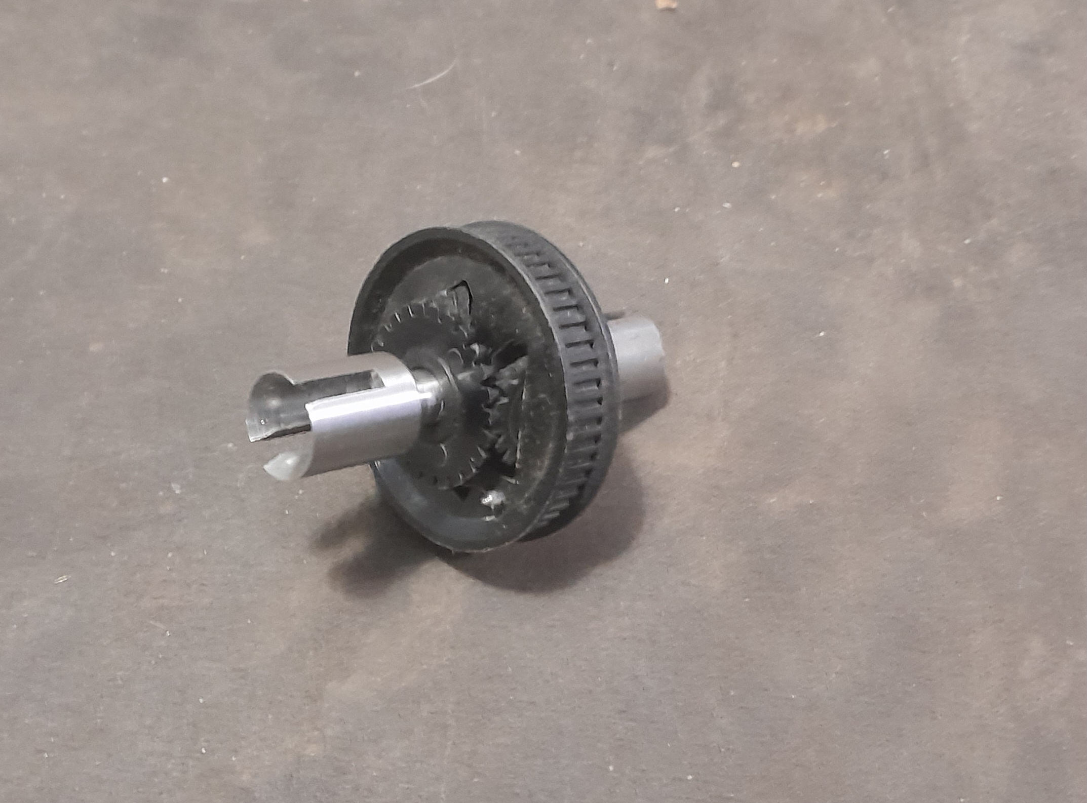

I spent a ludicrous amount of time today making one piece of rocking horse manure , I'm missing one diff outdrive for a mini Mustang so I copied one on the mill and lath in O1 tool steel , I still need to harden it but I wanted to test fit it first , its an exact copy except instead of using an 8BA screw it's an M2 instead . Genuine one on the left .

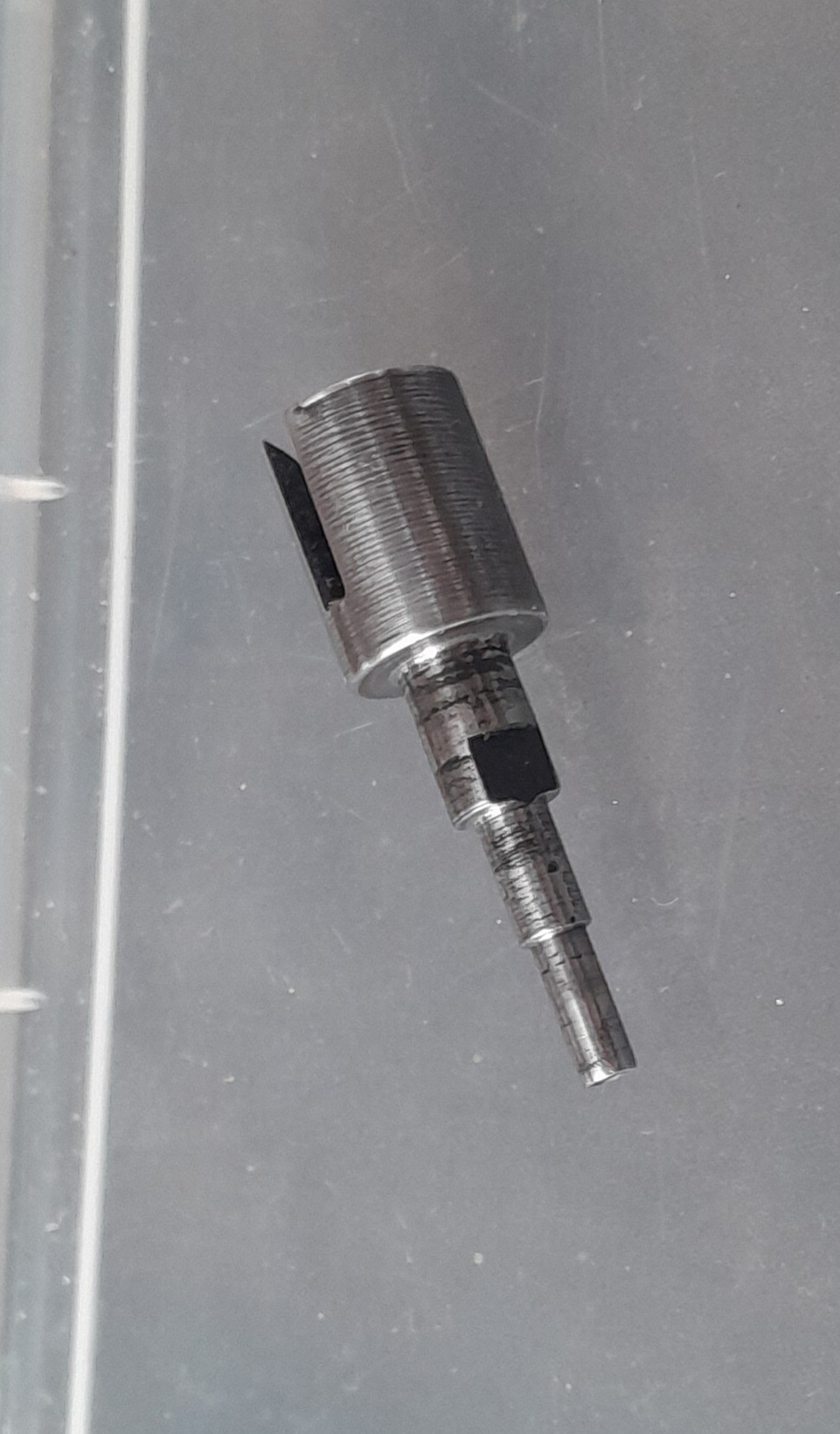

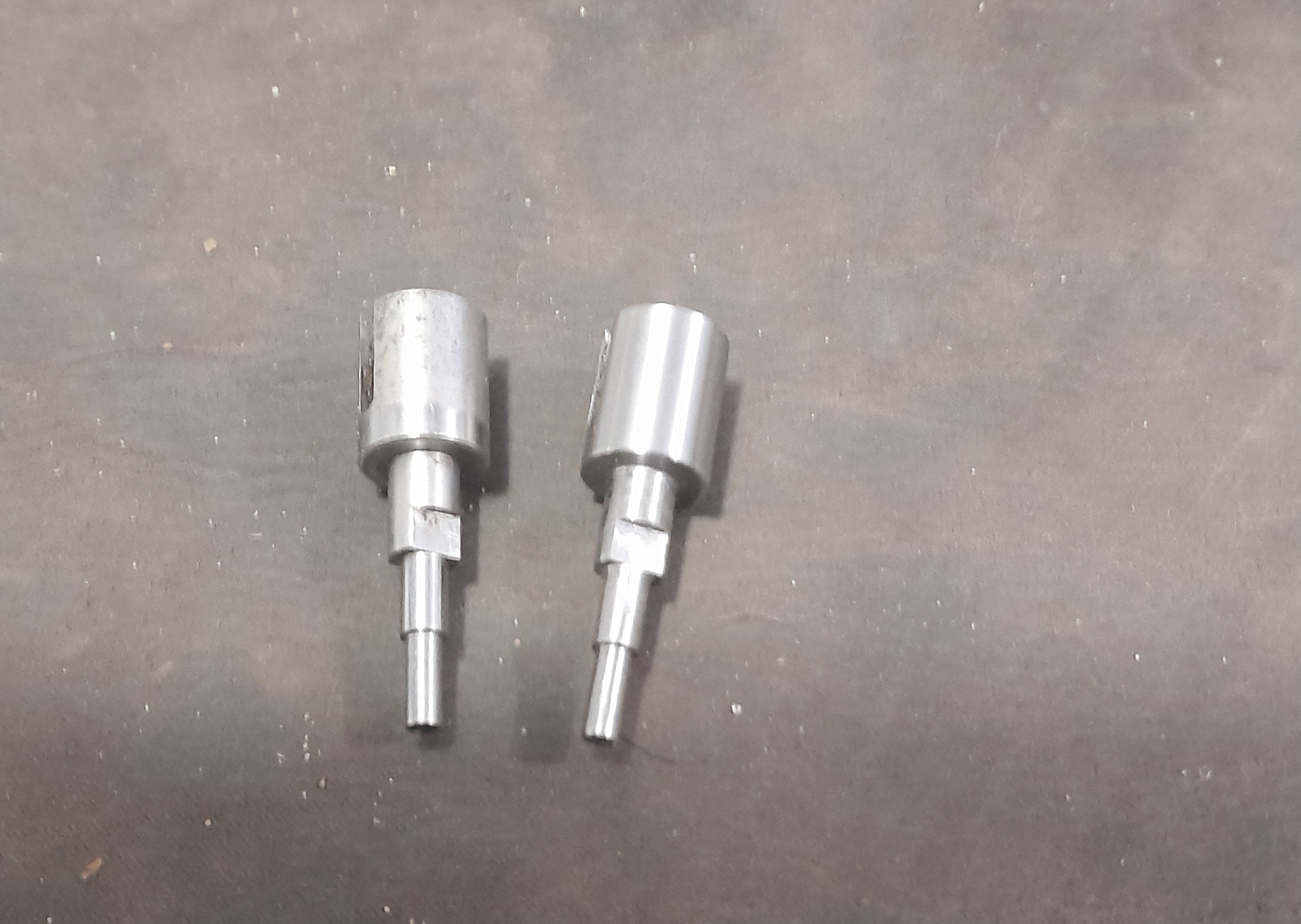

Now heat treated to harden , I was tempted to leave it in oil blued condition to stop it rusting but then I thought no I'm going for authenticity

No toaster oven but I've got a big soldering iron , its in a vice right now point up with the outdrive on the end , by my IR thermometer it's hovering just under the 400°C mark , it's a very cheap IR thermometer so who knows ?

Nearer 360°C if I'm honest

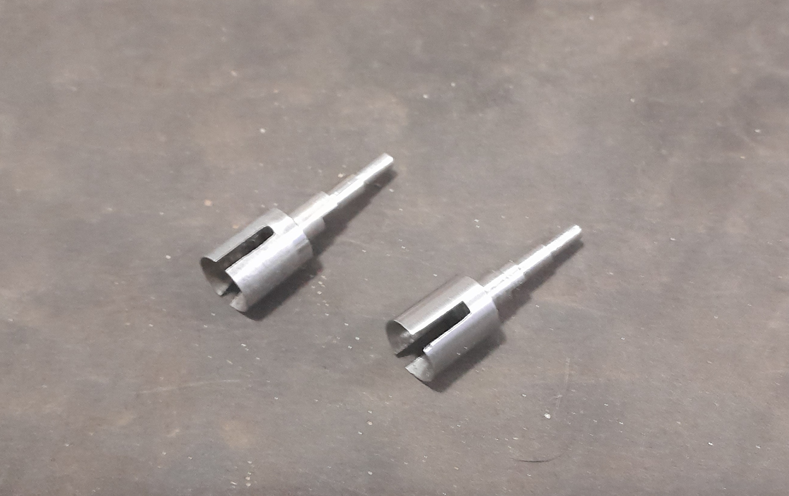

All cooled , cleaned and now assembled , should be good enough I hope .
