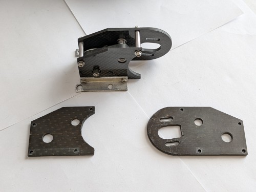

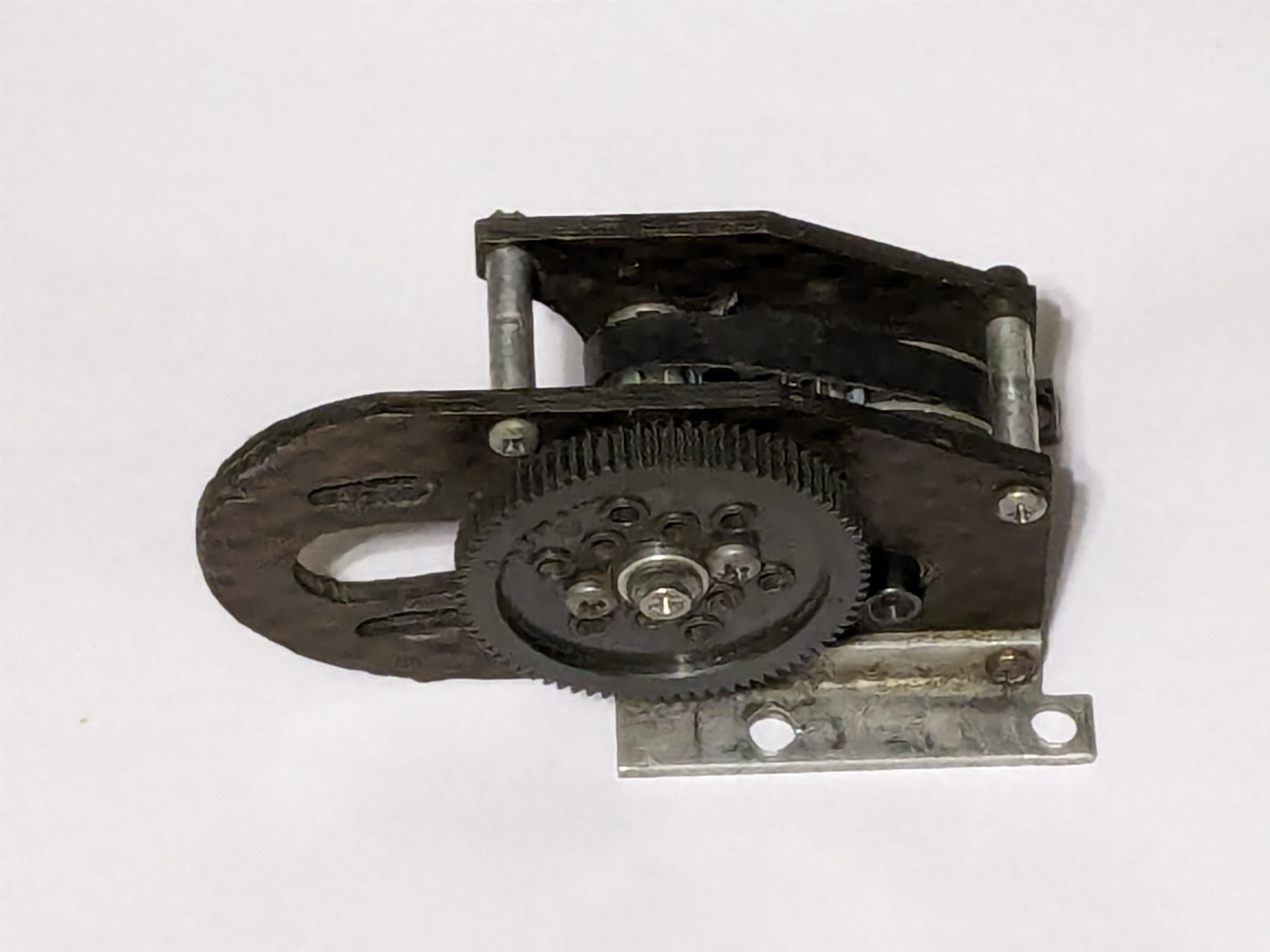

I haven't tried fitting outdrives yet, but I took care of replacing the banged up side plates with some freshly cut Factory Works parts. Thanks again Jeff!

The bearing holes needed to be opened up a few thousandths. Same with the screw holes for the spacers. But that's better than starting with oversized holes.

The G10 plates you ordered look nice! I considered that option too.

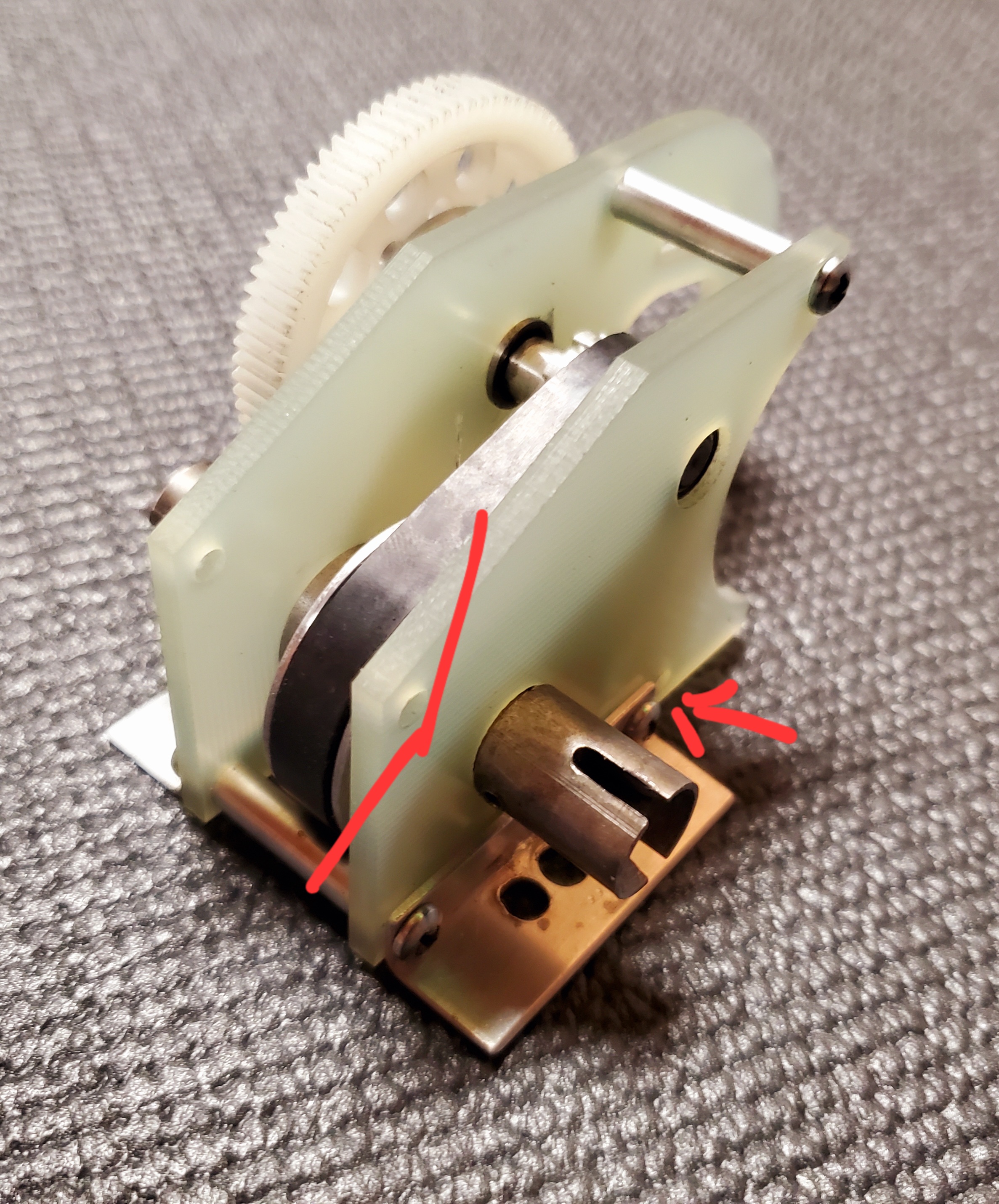

Thanks, I did have to move that hole where arrow is at bottom, and shave of that part at top cause it was hitting the bulkhead, but the bearings dropped right in perfectly!....with a few tweaks, he can put it on the market!

I'm sure it's a little different shape for Ultima vs RC10 but overall probably very similar.

coxbros1 wrote: Thu Aug 29, 2024 5:00 pm but the bearings dropped right in perfectly!
After the feedback I adjusted the holes to the sizes I typically use. I don't like to modify customer files when supplied but once I sell to others I definitely try to add my $.02 haha
