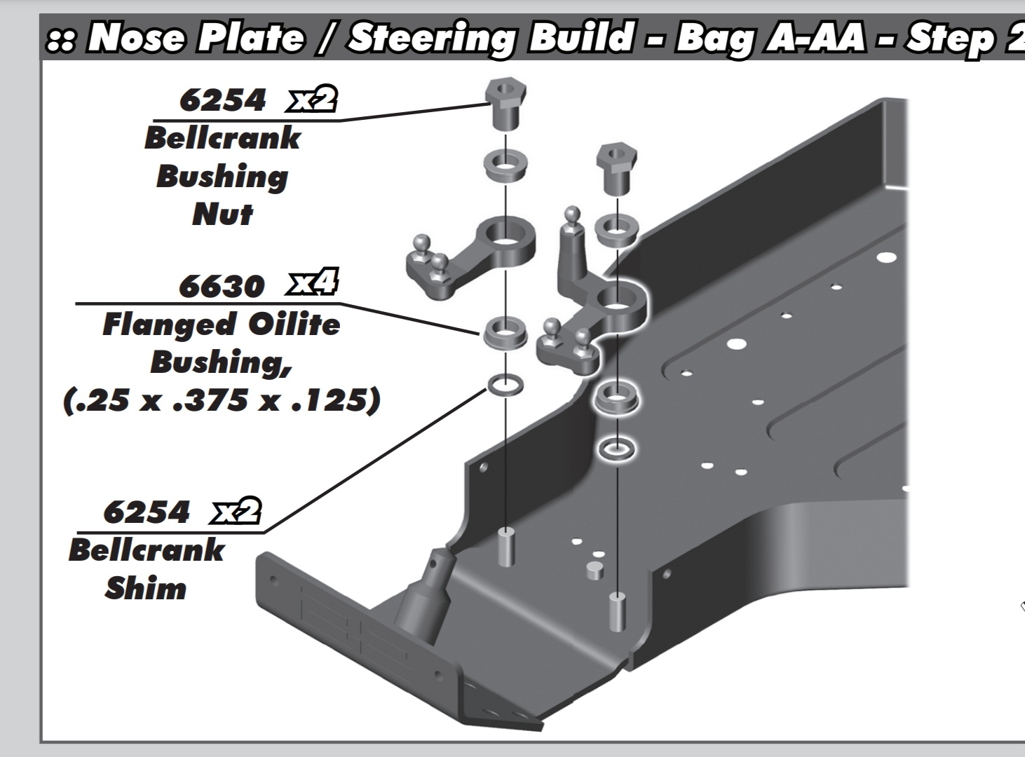

Re: Fan RC FR-01
I just started building my kit. Gonna be a long build because I don't get a lot of time to spend on it right now. I literally got hung up on step 2. The steering bellcrank did not turn out as good as I hoped. The plastic bushings don't offer enough bite into the screws to inspire confidence in their ability to hold over time. And also they rub on the chassis as they turn. Probably just need a spacer... there are 4 nylon spacer looking things in "bag A" so I might try them and hope they aren't called for down the road in the assembly.

Re: Fan RC FR-01
With my graphite cars, I shortened the threads on the ball studs for the bellcranks.Rc10812 wrote: ↑Sat Aug 03, 2024 8:11 pm The steering bellcrank did not turn out as good as I hoped. The plastic bushings don't offer enough bite into the screws to inspire confidence in their ability to hold over time. And also they rub on the chassis as they turn. Probably just need a spacer... there are 4 nylon spacer looking things in "bag A" so I might try them and hope they aren't called for down the road in the assembly.

Re: Fan RC FR-01
You just need to raise the bellcrank. You can't assemble it like you would on a tub chassis because the graphite chassis doesn't drop down like the nose plate.
