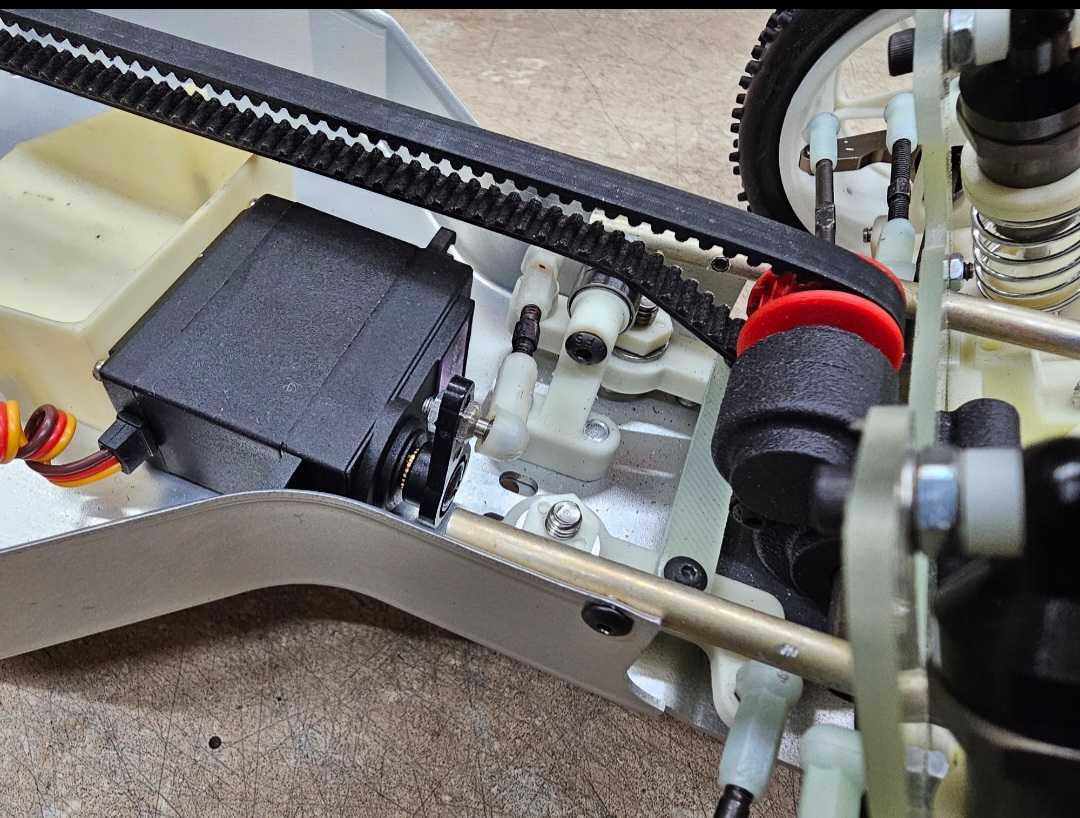

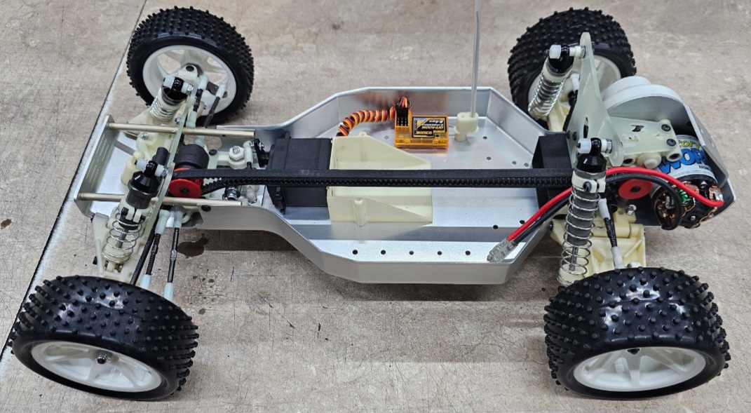

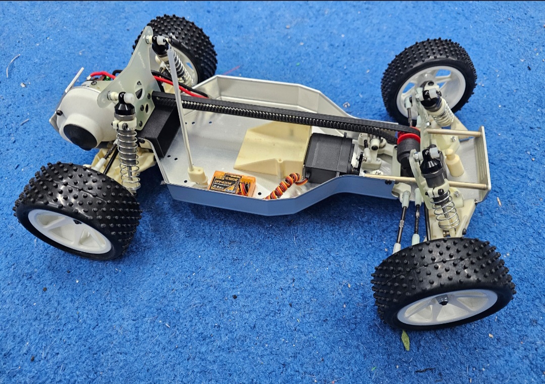

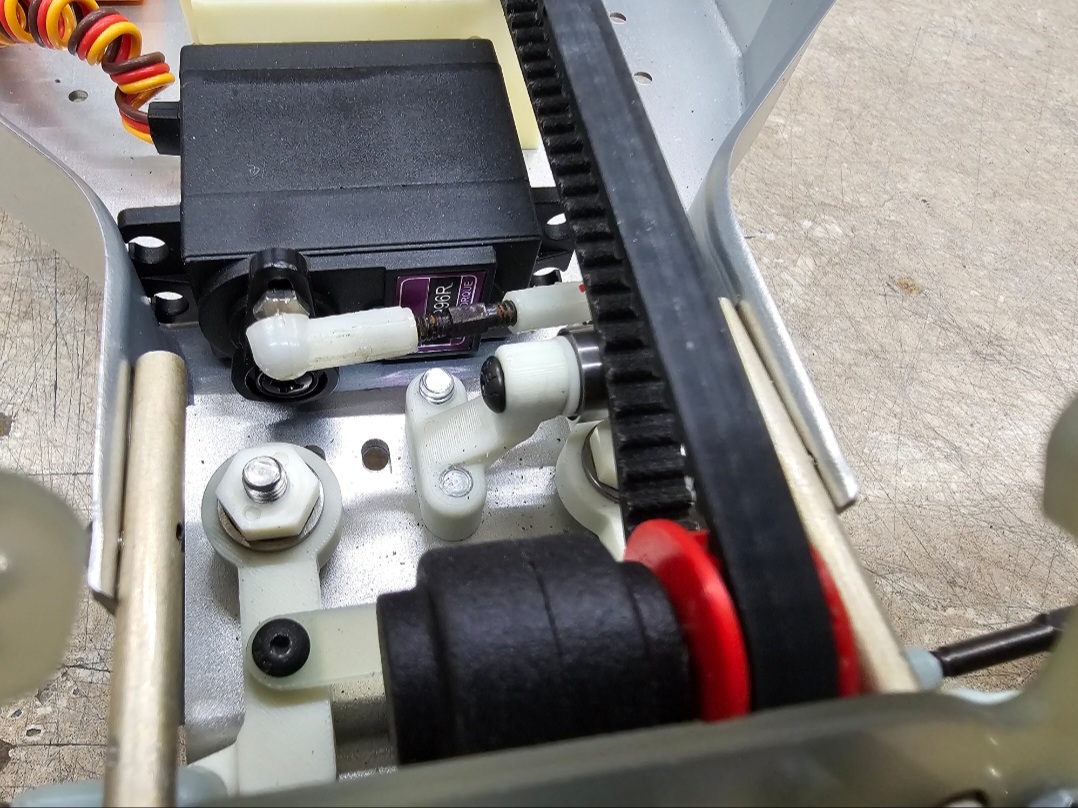

Got a little further tonight.
Redesigned the steering cranks for some extra throw, and designed a new belt tensioner that should be a lot easier to use. The final piece will be machined aluminum. The slotted portion retains a nut so to adjust you just loosen the screw slightly and you don't have to fuss with the rest of it.
I also installed the tallest servo I have to make sure it fits, and it fits no problem. A shorty will be sweet. Lock to lock and clearance everywhere.
So the one thing that always bothered me about the Ten4 and the MIP as well is that the belt is so close to itself that on a hard landing I could definitely see it touching teeth. I'm thinking a thin piece of lexan might be in order. I'll have to get with Boki, maybe we can make something custom that is simple but effective.
Btw, man these new chassis are cheese. The flex is unreal. I'm thinking we might need to highly recommend our braces if using a rere. It's bad.
