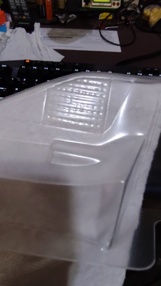

Overall thoughts on the kit, with some tips
Aside from the previously mentions Bellcrank an Diff issues everything fits very nicely together in the kit. That said like most kits of old, you may have to do some filing/sanding to fit parts together properly. I prefer this over newer kits with looser tolerances and you can get a much nicer build out of it with less slop without having to use 20 packs of shims. (don't get me started on how sloppy new Schumacher kits are) .
Both the 4-40 cap screws and 8-32 flat head screws use a 3/32 hex driver. Pretty cool IMHO as I can work on the car with 1 less driver. The 8-32 hardware is the proper 100degree version as well.
The plastics are great quality and the finish on the Carbon parts looks amazing.
The included ball bearings seem to be pretty good quality as well.
The inclusion of both white and black arms is a nice addition.
You may need to adjust the amount of shims needed for the rear axles. Mine only required 2 shims per side. Glad to see they included the anti crush spacers so you can tighten your rear wheel nuts with reckless abandon without binding up the drivetrain.
The body and wing are OK although the window nets aren't well defined and would have preferred if they just left the window plain. Also there's no markers for the body posts, this isn't a big deal for me but some people really like them. Funny enough the Wing tubes are marked on it though. The ballcups seem to work better than their AE counterparts and doesn't require you to have the Might of Hercules to screw them on.
The turnbuckles seem well made, just keep in mind the rear ones are made to use the innermost hole and will not work on the any of the locations in the 3x3 section unless you want positive camber for some wild reason.
Rear Bulkhead is the same type as the Rere World's car. I opted to cut the outer 2 columns of camber link holes off and then used the part that I cut off as a drill guide and drilled another column of holes in between the remaining column and the innermost hole so I could somewhat replicate Craig Drescher's setup (https://site.petitrc.com/setup/associated/setuprc10/RC10W_CraigDrescher_Dortmund2013041314/) These positions work with the supplied turnbuckles as well.
Don't forget to CA the rear wing tubes in, unless you like them popping out every time you pull the wing off.
As stated by others you may need more internal spacers in the rear shocks if you're not using the outer holes on the arms to avoid having the half shafts collide with the arms. At least they used the shorter version of the shock shafts so it's not as bad as the Classic and 40th where the instructions are wrong and no fuel tubing is supplied to make it right.

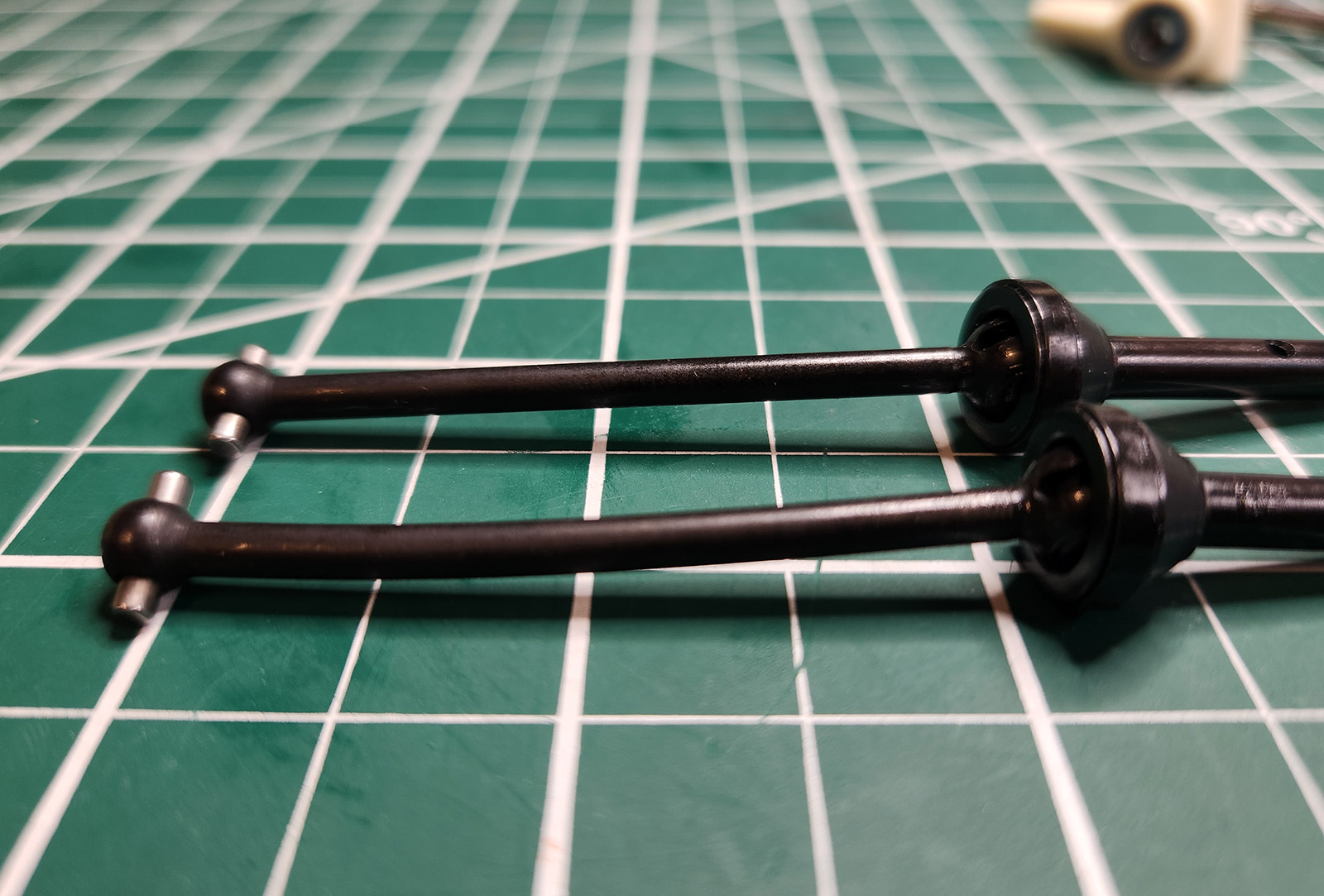

Ran into a couple of issues quickly as I got into this evening's work on the FR01.
1) Bent CVA. Given that FanRC isn't in the CVA manufacturing business, I am guessing these were outsourced. I stated earlier about my kit, and this was typical of many of the first kits, that the CVA barrels were not shipped in the original kits. I am guessing this is an issue with the CVA manufacturer / source. I am guessing this bent shaft is the fault of the same source.
2) I may be me missing something here, which is often the case. I have the rear links twisted all the way in, and am in the inner hole on the bulkhead, but still just a bit of positive camber???
