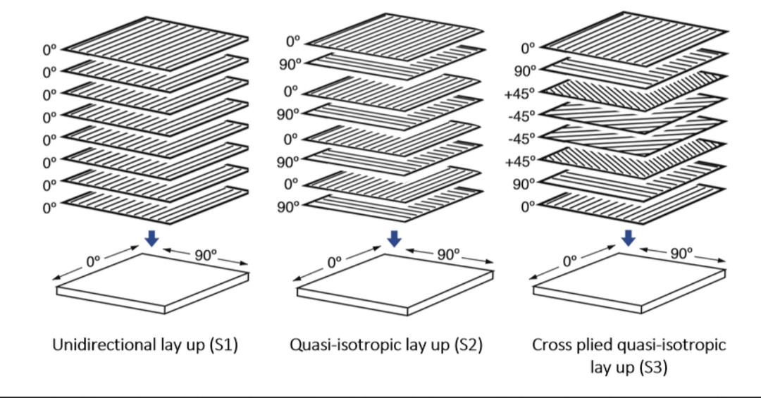

I know I have seen CC t-bars listed as 45 degree, but I have no clue what that means. I would be interested in learning myself.

The cuts on the material are made at 45⁰. The layup of g10 is 0⁰ or sometimes 0⁰ 90⁰ so by cutting it from the material at a 45⁰ angle you are changing the way the material flexes.

GoMachV wrote: Tue Aug 20, 2024 9:22 pm The cuts on the material are made at 45⁰. The layup of g10 is 0⁰ or sometimes 0⁰ 90⁰ so by cutting it from the material at a 45⁰ angle you are changing the way the material flexes.
Ah.. solved. thanks. makes sense it would be stronger as the thing is springing along in mostly one direction. If used a lot maybe less likely to fatigue if fibers are at 45 degrees.
