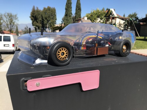

The lights look awesome! I was a little worried that a single LED in each taillight wouldn't illuminate the entire panel evenly but yours looks great -- probably due to the chrome paint you applied. I reckon you installed a red 3mm LED?

Thanks! The Tamiya TLU-01 controller comes with 5mm LED's, and they are really bright. The LED's being sealed in the reflective buckets, does seem to focus the beams well.

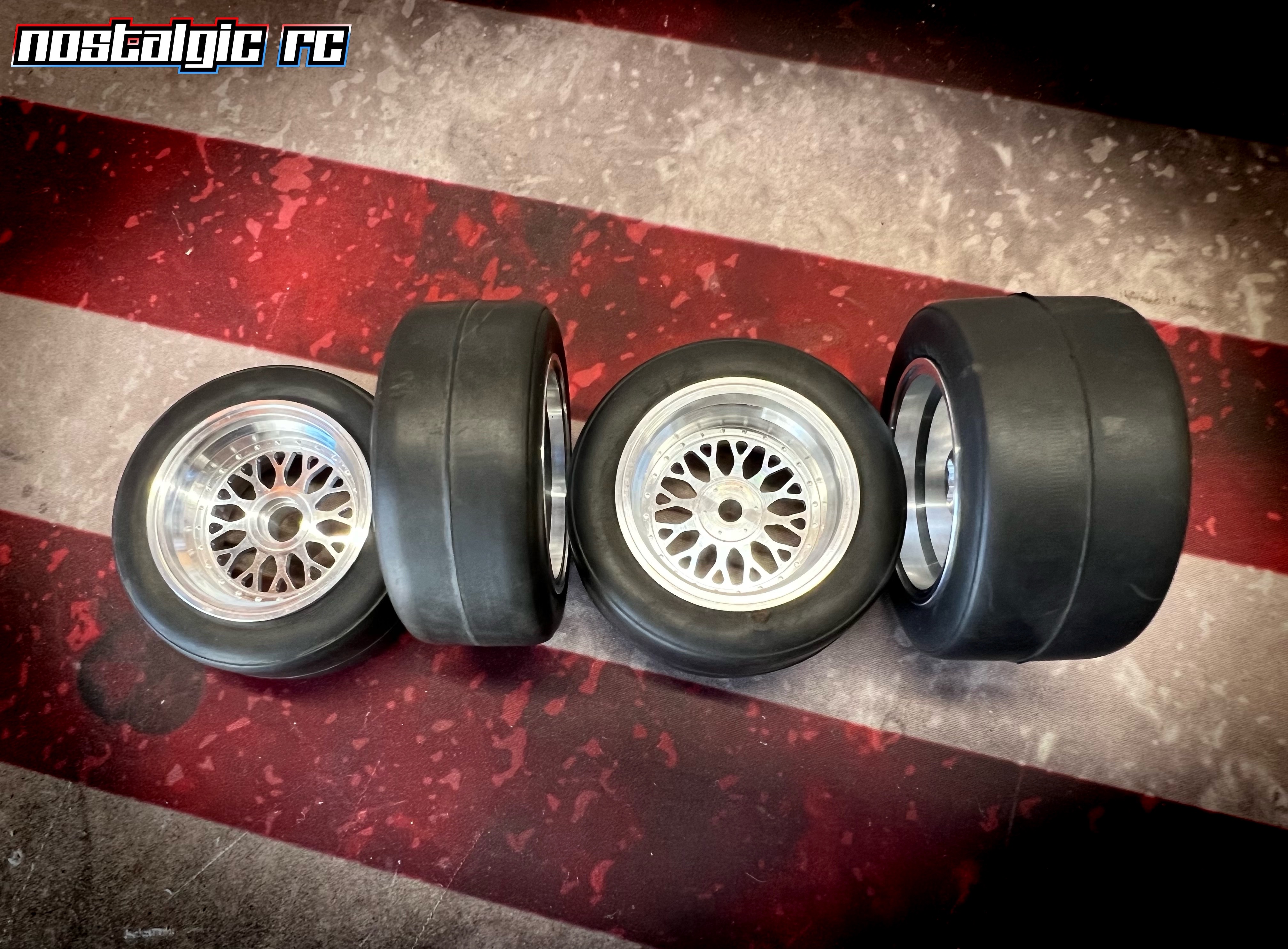

Turns out there is one very solid choice available still.
Front
https://www.ebay.com/itm/276591716120
Rear
https://www.ebay.com/itm/115337033911
Picked up a set of each.
I have a decent collection of spare donuts and a truer now, should be able to re-skin these wheels as they wear out. Foam wheels will also make it easier to fit the aftermarket bodies, if I can shape them. Revell Chrome Spray should clean them up a bit too.

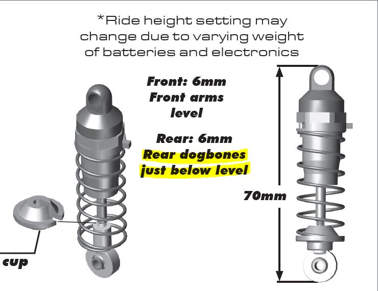

Have you set ride height yet? I've installed my rear shocks and at full droop, the arms are level which seems wrong. The design intent is for the arms to be level at ride height with a few mm's droop when the suspension is unloaded. My rear shocks are assembled with the 1/32 internal spacers and they are too short to allow for any droop. The front shocks are also assembled with spacers but their length allows for some droop.
BTW, what does "Rear dogbones just below level" mean?
Are there front dogbones?? :lol:
Are they saying the trans end should be lower or higher than the axle end? The original manual doesn't include this note but there are ride height recommendations near the end of the manual (page 49).

I think they mean trans outdrives lower than stub axles "just below level". But I don't know why I think that. :lol:

I had good luck with all of the stock ballcups (the 40th was a different story), no popping off or slipping with the little AE wrench; once the turnbuckle rod had been threaded fully and backed out a bit, the stock cups adjusted very easily for me.
I re-read that ride height section of the new manual a few times last night, when they went from imperial to metric it threw me off the track entirely, I just gave up and set the ride height to nearly the top. I intend to drive this on unswept asphalt, so I need some ground clearance.
