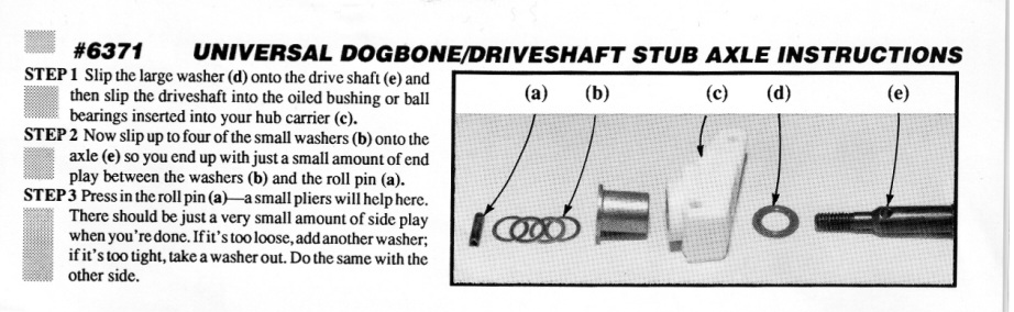

I'm looking to assemble a 6037 worlds car.
looking at the manual Dogbones are installed with the 1/4" stubs.
On the 25 years of rc10 thread the 1/4" universal shafts are used
Was the kit ever shipped with dogbones?

6037 only came with the 1/4" universals, no dogbones axles.
Posts: 12335
Been thanked: 3917 times
Re: 6037 worlds car manual vs kit
No, always universals. The manual pics show a rc10t rear carrier and 1/4" stub axle and then a rc10 stub axle and carrier but they did try to crop one of the pics a little lol. Not sure why they didn't just take new pics but no, they never came with dog bones.
I'm pretty sure there was a supplement for the universals that showed installing the shims as well.
Edit, there was. And it showed bushings :lol: 🤦‍♂️

GoMachV wrote: Thu Oct 10, 2024 1:22 pm No, always universals. The manual pics show a rc10t rear carrier and 1/4" stub axle and then a rc10 stub axle and carrier but they did try to crop one of the pics a little lol. Not sure why they didn't just take new pics but no, they never came with dog bones.
It's the pictured Attached here that made me ask. This is clearly the stub axle

Posts: 12335
Correct. And the pic above that one shows a 10t carrier.
