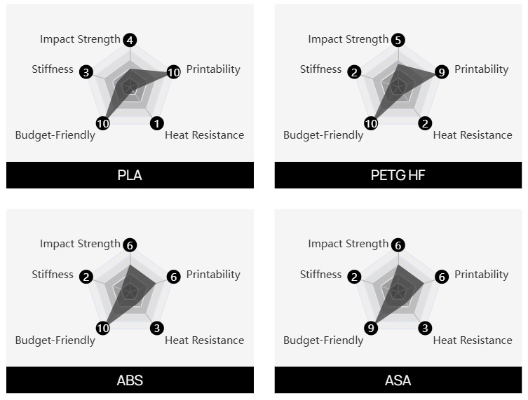

I'm about to order filament and I'm looking for some advice.
Are we selecting PTEG over say ABS for its improved printability?
According to these graphs, ABS is stronger and more heat resistant than PTEG. Maybe it's all about the "pungent odors"??
I was considering using PLA for test prints but since it's priced the same as ABS and PTEG yet it has less strength and heat resistant, why would I ever consider buying PLA? My printer has an enclosure so not limited to printing PLA which doesn't require an enclosure.

PLA for dimensionnal testing is just perfect as it doesn't warp...XLR8 wrote: ↑Tue Nov 05, 2024 8:45 am Your parts are looking great!
ABS is more heat resistant than PETG for sure... But strength is another story : depends what you want to do with it. ABS is prone to degrade with UV (not the case for PETG). I found PETG is a little bit more flexible than ABS, and once ABS is bent, the breaking point is not far... I tend to prefer PETG over ABS for RC because of the added flexibility and the better printability.
And overall, PETG gaves me very good results on the 44B Hilux, and even resisted quite a good number of high jumps (and it is not broken yet)...

Thanks!!silvertriple wrote: ↑Tue Nov 05, 2024 8:57 amPLA for dimensionnal testing is just perfect as it doesn't warp...XLR8 wrote: ↑Tue Nov 05, 2024 8:45 am Your parts are looking great!
I'm leaning toward ABS for printing bodies that will painted so UV exposure won't be a problem. How does PTEG sand and does it accept lacquer based primer and paint? Also, what is the best method to bond PTEG? Thanks for your reply.

That's the biggest advantage of ABS : it's probably the easiest material to post process, either with sanding paper, either with vapor smoothing (Acetone)...
