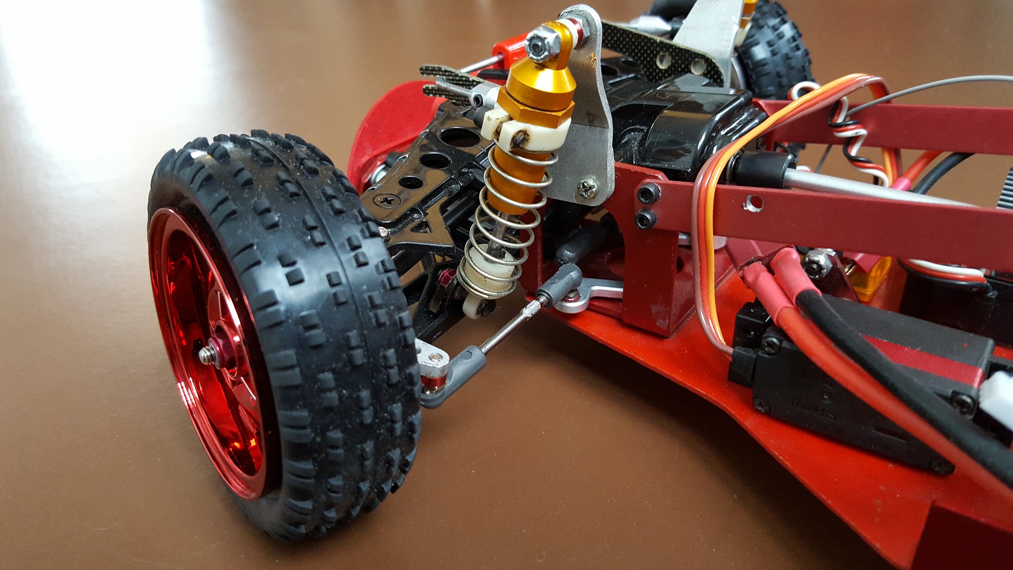

Here are some grey Schumacher ball cups on a Hotshot. They replaced the ae ones I used previously.
Along with juicedcoupe I also have very good experience with Schumacher ball cups - I use them on several platforms.

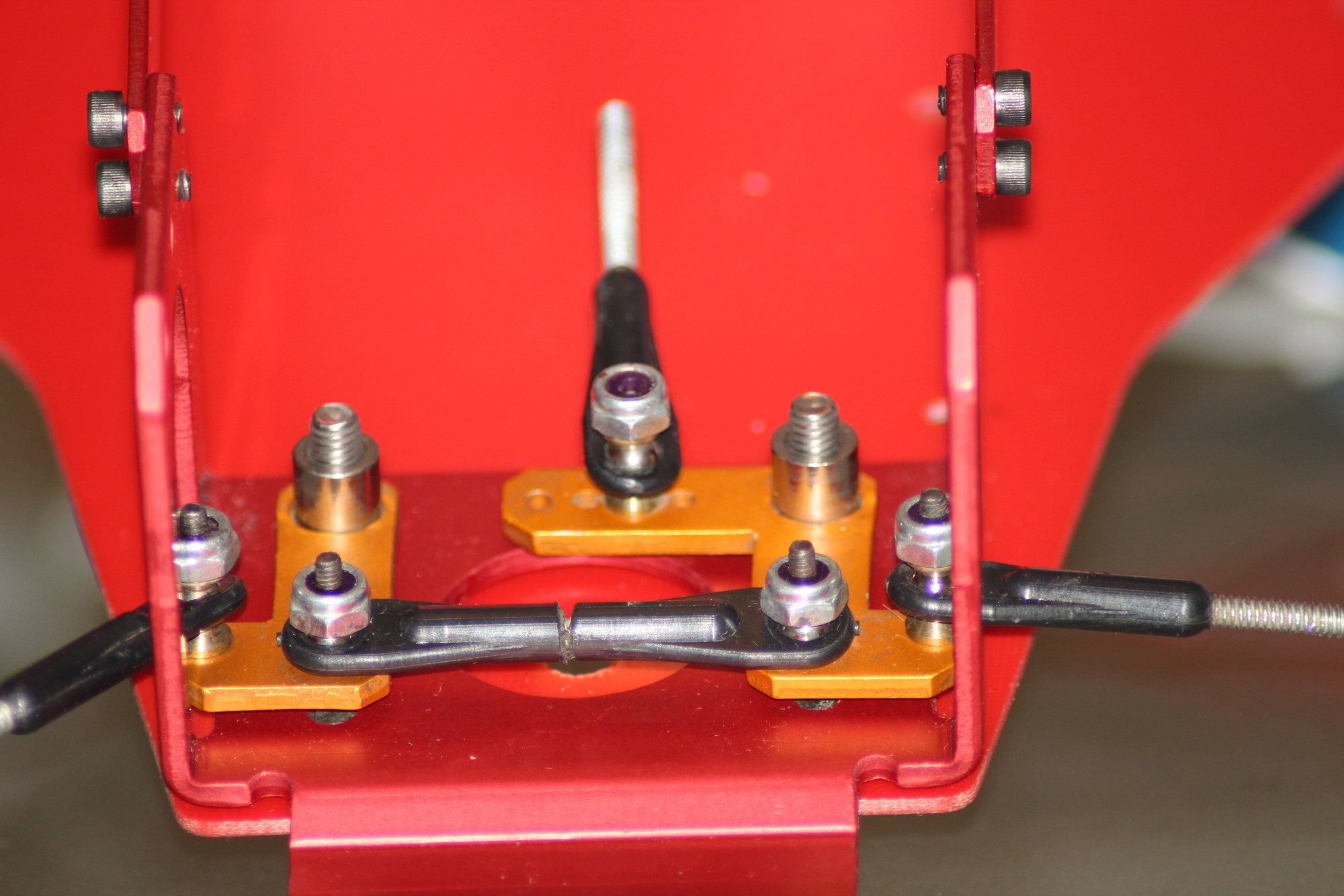

Here is another setup with captured ball joints where cone spacers are used on the ones with vertical articulation.
The bell crank link joints are only fitted on a small washer.
