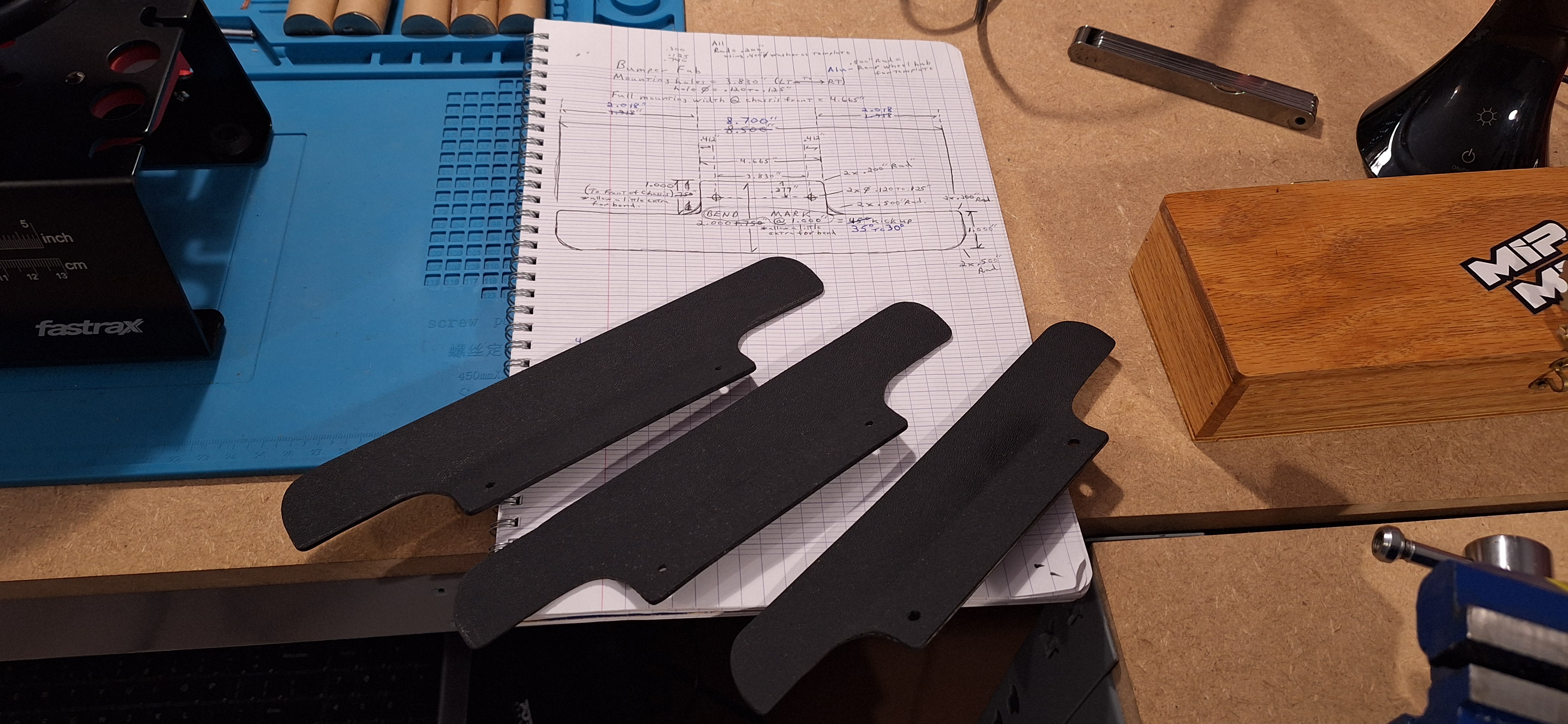

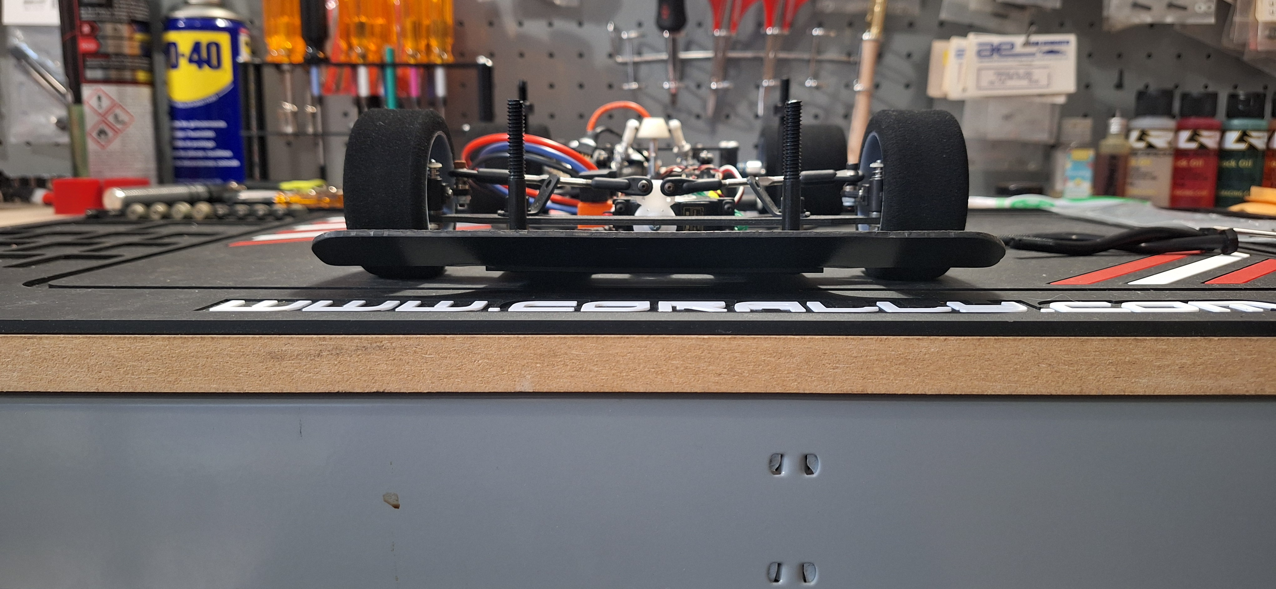

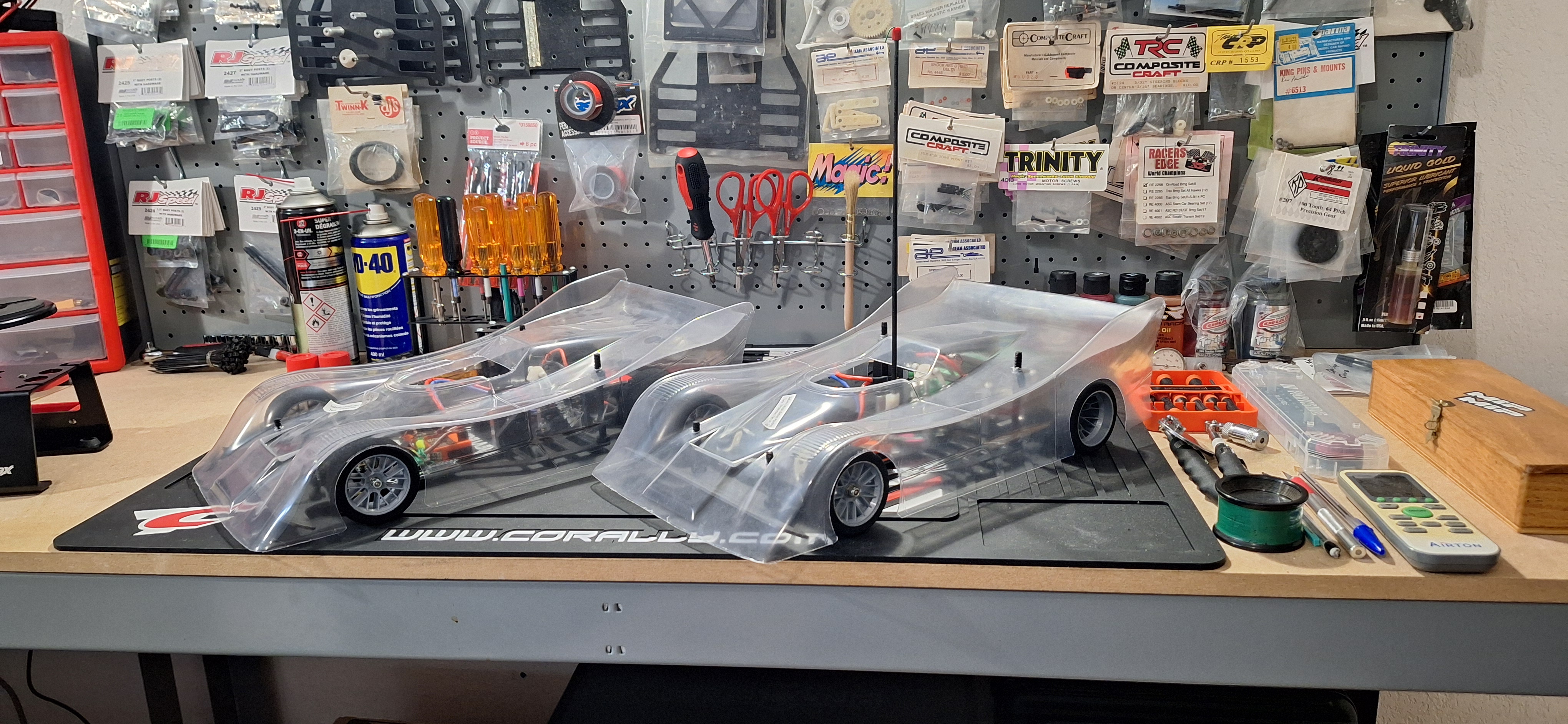

Made two new bumpers.....wasn't happy with the width on the first one I made a while back. The added width covers both front tires and should help protect the kingpin/graphite crossbar weak spots a bit better. For what it's worth, my chicken scratch/drawing is in the photo if anybody is interested. The TOJ body rests perfectly on the bumper when all mounted up.

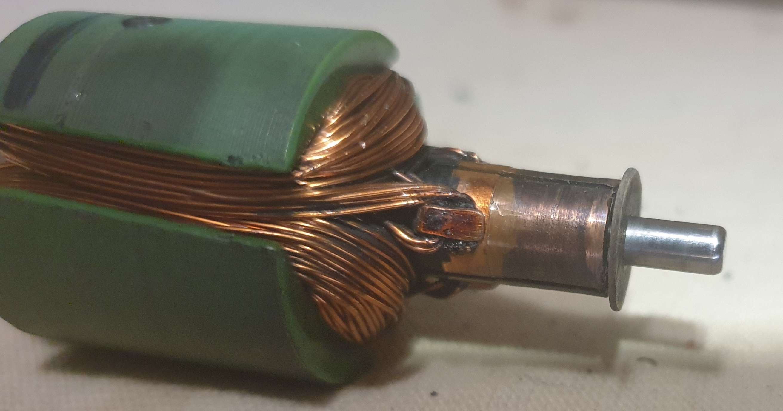

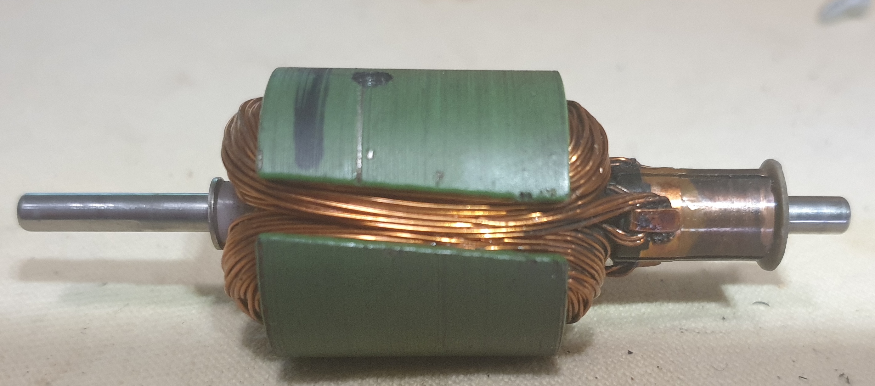

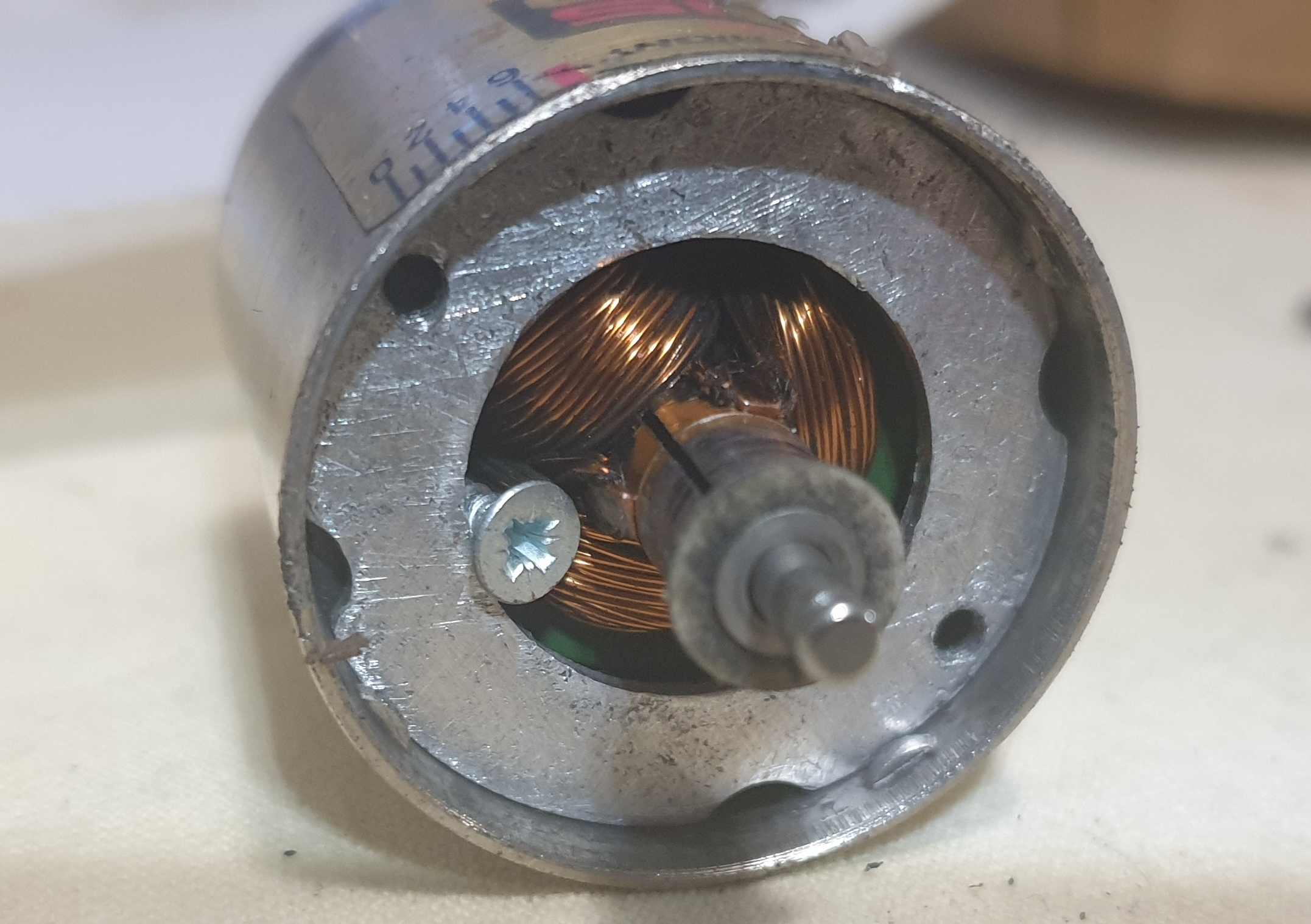

Had a few minutes spare time, so got the (new to me) Kyosho 480 Gold on to the bench and gave it an internal cavity search. \
Glad I did..... that doesn't look right!
Comm looks in pretty good condition...

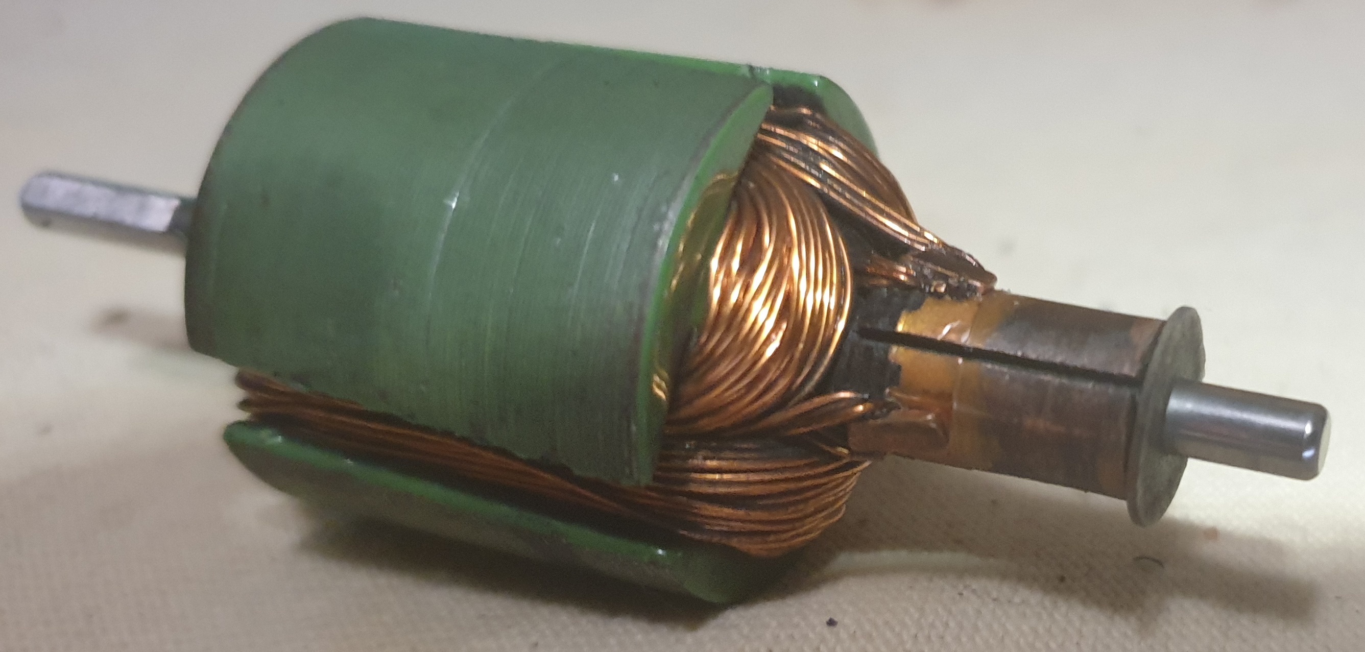

Not sure the whole thing is meant to look this 'twisted' though.....
No matter, put it all back together again, remembering this time to put all the shims and washers back in their correct places
Spun it up on my Duratrax ICE's motor break-in setting (7.4v, 10 seconds), and it sounded pretty strong, although only drew 1.2A.
If I did comm skimming, I'd get this cut, and it would be as good as new (for a twisty Kyosho).... but I don't cut comms, so will instead find a comm stick, give it a quick clean, and that's job done.

That's about the only way a 25T quad is gonna happen.Incredible_Serious wrote: ↑Wed Jan 22, 2025 3:58 pm Not sure the whole thing is meant to look this 'twisted' though.....

Well, that's good news..... thanks mate. For me, motor maintenance usually involves grabbing another one from the pile, and seeing if it worksjuicedcoupe wrote: ↑Wed Jan 22, 2025 4:09 pmThat's about the only way a 25T quad is gonna happen.Incredible_Serious wrote: ↑Wed Jan 22, 2025 3:58 pm Not sure the whole thing is meant to look this 'twisted' though.....

Oh, my bad. I thought you were talking about the windings. After rubbing my eyes and looking at it again, I see what you are talking about.
There is such a thing as a skewed armature, but I doubt that's the case.

The skewed/slanted armature slots are correct.Incredible_Serious wrote: ↑Wed Jan 22, 2025 3:58 pm Not sure the whole thing is meant to look this 'twisted' though.....

Cheers @R6cowboy, thanks for that! Will feel happier when I put it up for grabsR6cowboy wrote: ↑Wed Jan 22, 2025 8:17 pmThe skewed/slanted armature slots are correct.Incredible_Serious wrote: ↑Wed Jan 22, 2025 3:58 pm Not sure the whole thing is meant to look this 'twisted' though.....

If you have a mic, see if ya can grab one wire to see if it measures right about 0.4mm thick.Incredible_Serious wrote: ↑Wed Jan 22, 2025 8:35 pmCheers @R6cowboy, thanks for that! Will feel happier when I put it up for grabsR6cowboy wrote: ↑Wed Jan 22, 2025 8:17 pmThe skewed/slanted armature slots are correct.Incredible_Serious wrote: ↑Wed Jan 22, 2025 3:58 pm Not sure the whole thing is meant to look this 'twisted' though.....

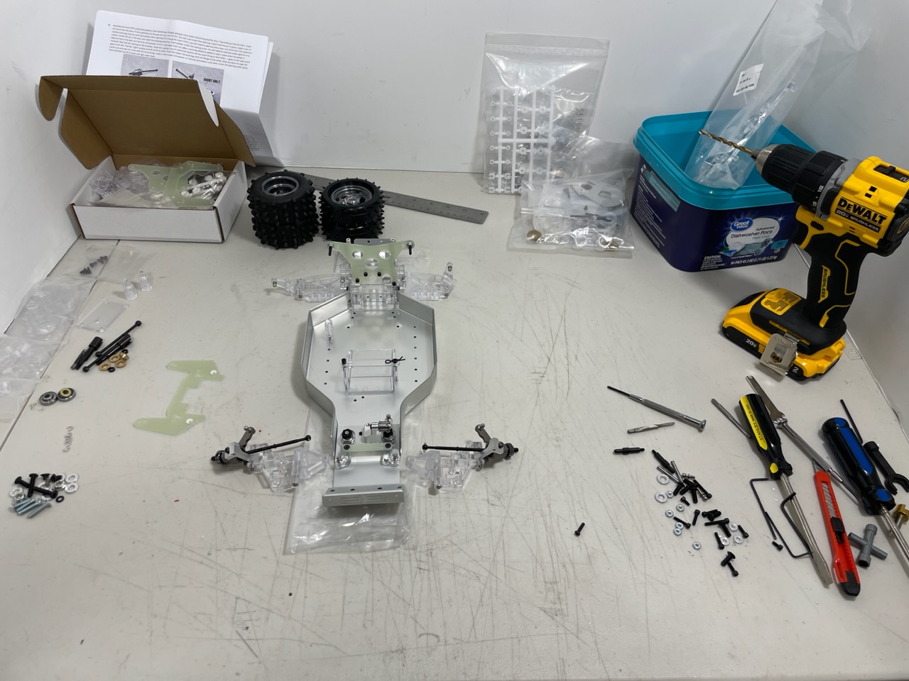

Slowly piecing the chassis together. Need to figure out the plan for the front and rear axles.

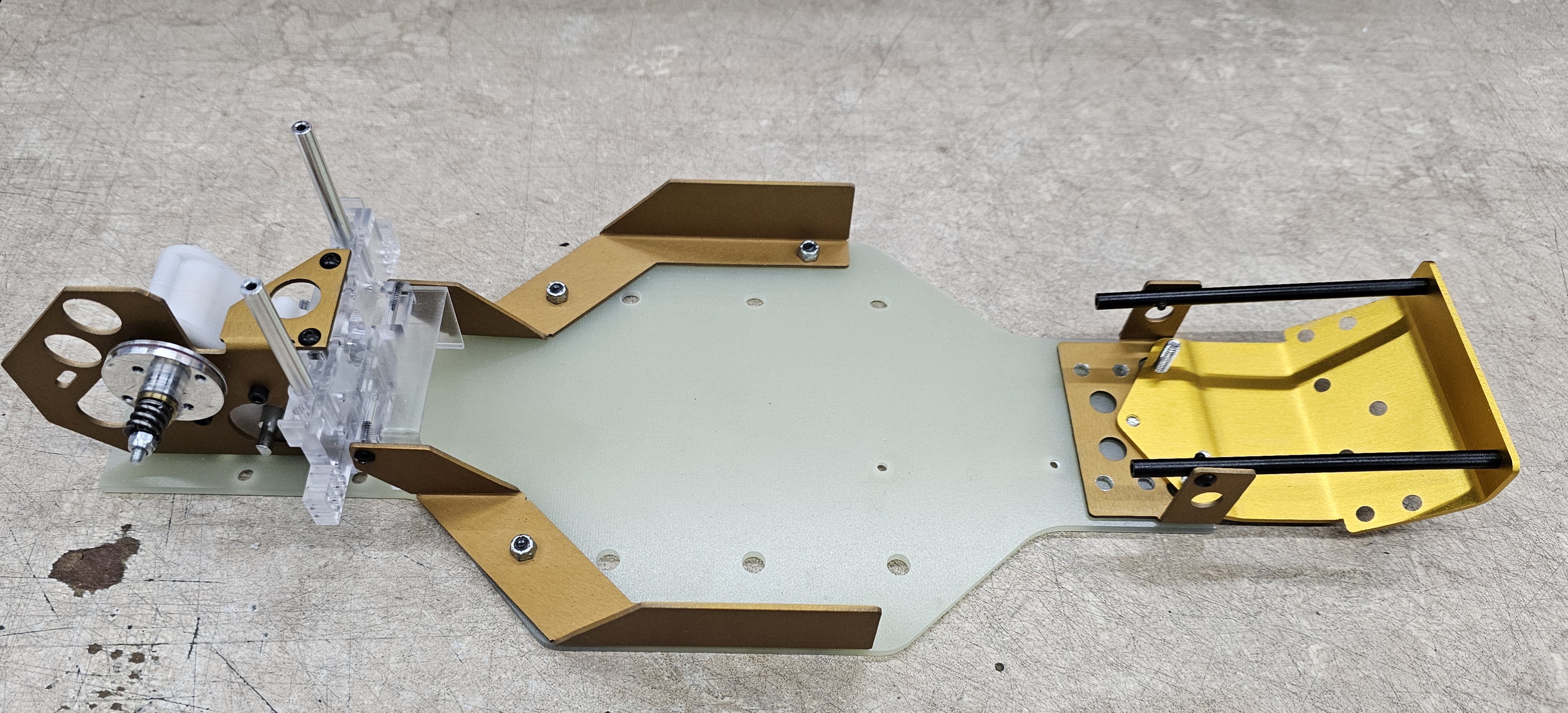

Some Hot Trick (style) stuff
Ignore the clear bulkhead, I keep stuff like that around for mock up

That’s pretty ibteresting! Was that a lemans thing?R6cowboy wrote: ↑Wed Jan 22, 2025 8:17 pmThe skewed/slanted armature slots are correct.Incredible_Serious wrote: ↑Wed Jan 22, 2025 3:58 pm Not sure the whole thing is meant to look this 'twisted' though.....

Not just LeMans, a couple Trinity Monster Horsepower modifieds I have also have them.treystoys wrote: ↑Thu Jan 23, 2025 7:19 pmThat’s pretty ibteresting! Was that a lemans thing?R6cowboy wrote: ↑Wed Jan 22, 2025 8:17 pmThe skewed/slanted armature slots are correct.Incredible_Serious wrote: ↑Wed Jan 22, 2025 3:58 pm Not sure the whole thing is meant to look this 'twisted' though.....

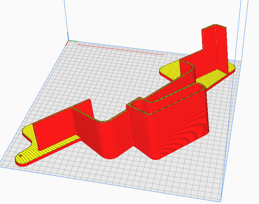

I finally got an early concept for a car wall holder working. It's huge and i"m going to have to iterate a few times to keep cars from dropping on my head.
