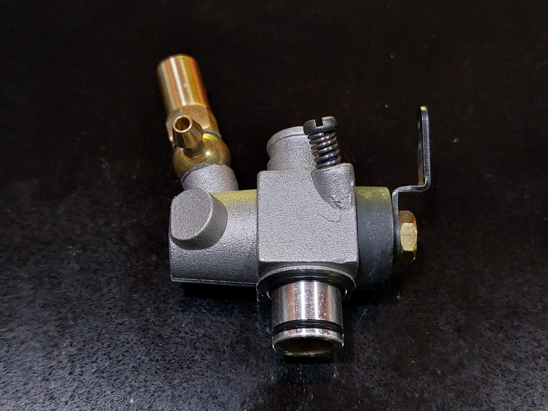

The carb seems well made except for the rubber boot which looks and feels a little cheap. Two o-rings seal the carb to the engine case, another nice feature.

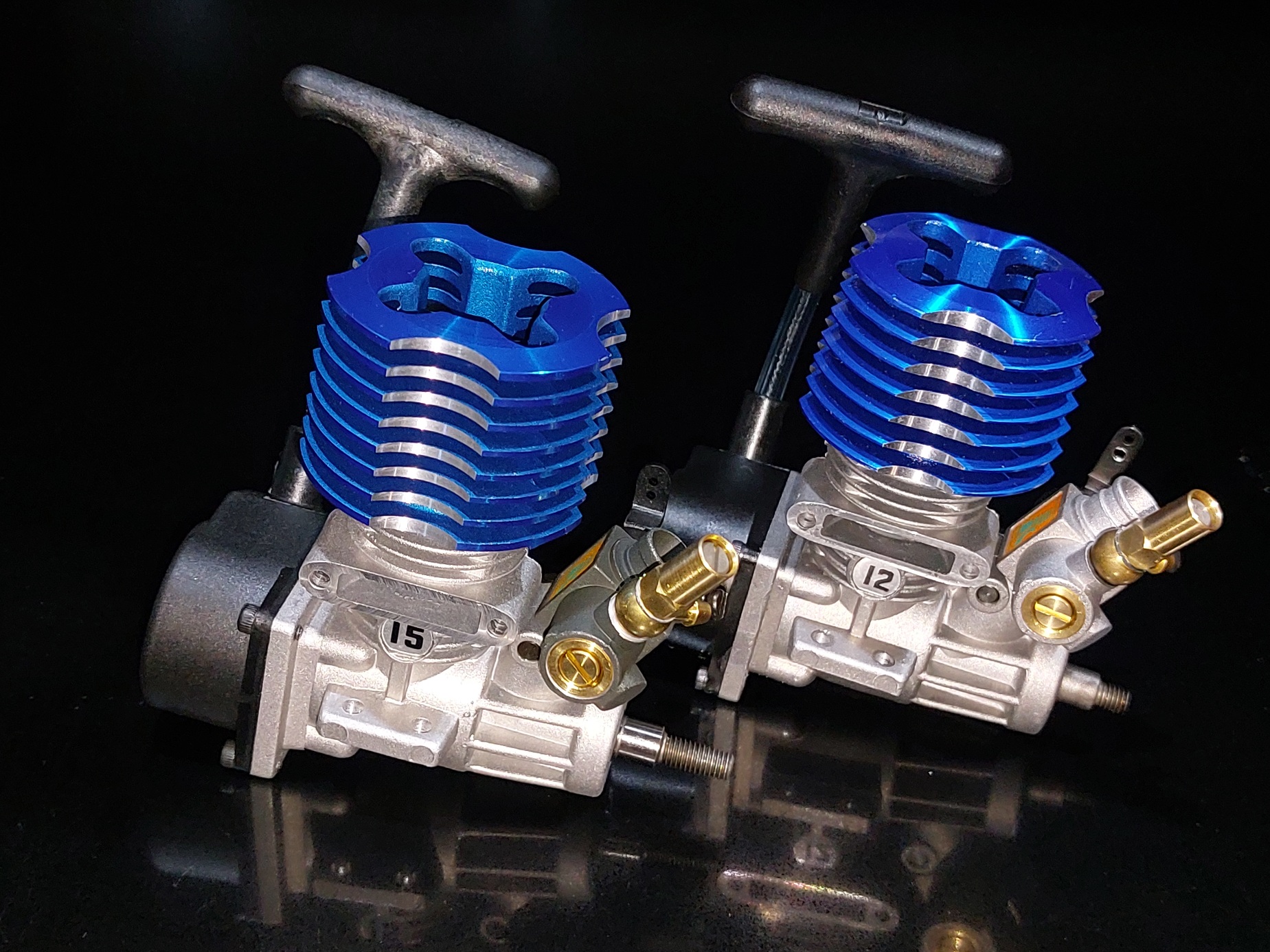

Same same but different....
The most interesting thing is the carb throat is slightly smaller. Hopefully this means the engine is a raging fire breathing beast and needs the smaller carb to tame it down :lol: :roll:
There are some slight differences but nothing anyone would care about :wink: I still need to cut the crank then it can go in the truck
