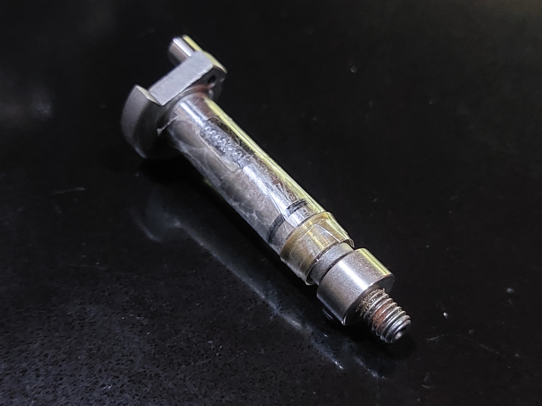

The internals look nicely made. The crank is fairly basic and looks very similar to the OS crank. It also has an o-ring seal which seals against the front bearing. The sleeve is ABC construction and features 3 ports. The piston and rod look well constructed. Funnily enough it looks a lot like a smaller version of the Force .21 engines. It should be a pretty good performer.

Normally you'd cut the crank with a sandwich bag while the engine is assembled but I decided to cut it while out. I have a few Associated cut off nuts somewhere but do you think I could find them? I ended up using a dubro collar that fit quite well. To be honest you don't need a cut-off nut if you know what you're doing, just be careful you don't cut it too short.
I put tape around it just to protect it, I always touch up the cut end with a linishing belt to make it appear a little nicer.

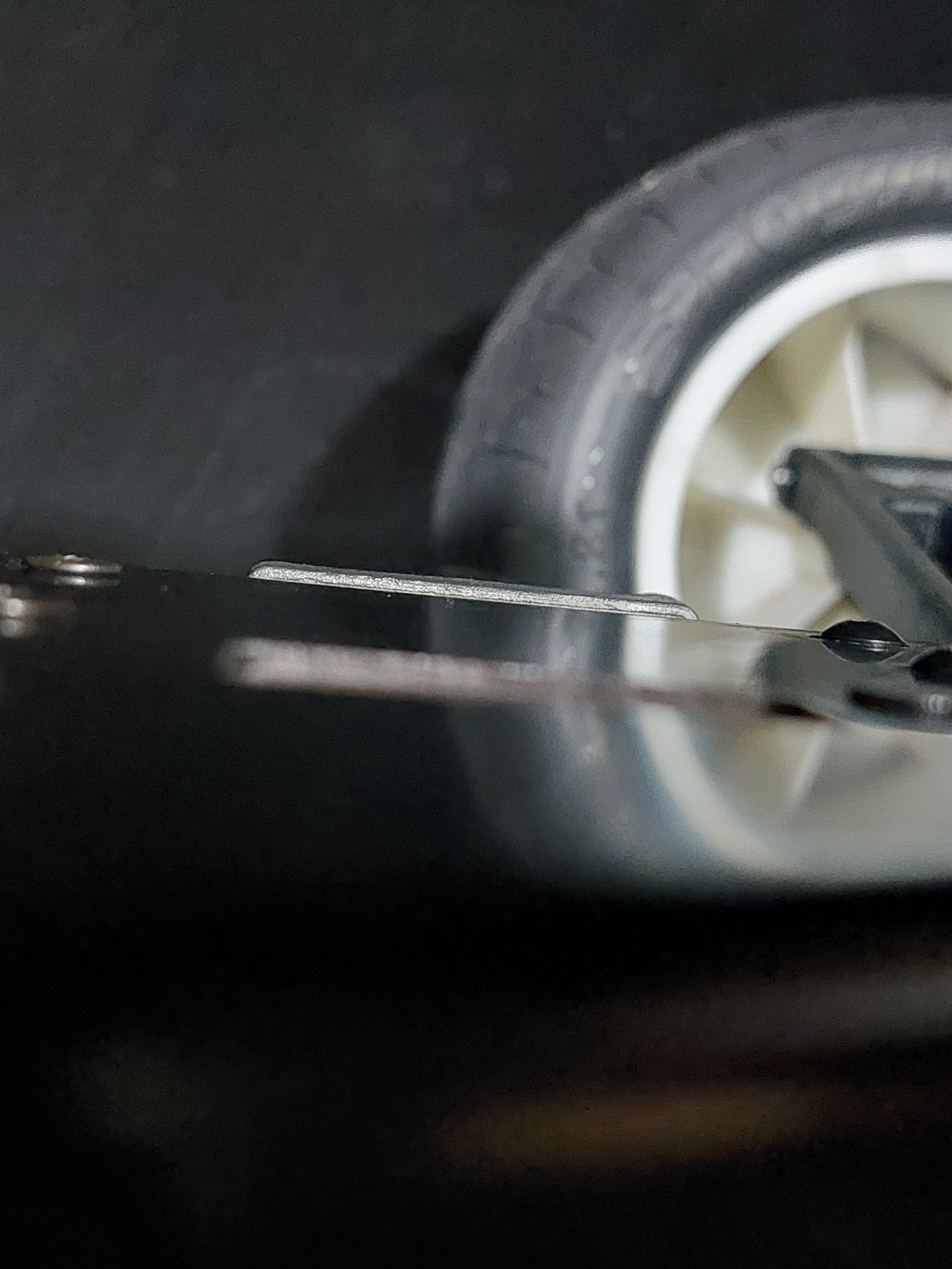

This has non pull engine mounts, non pull flywheel and a pullstart header. This pullstart is much smaller than the OS so it's way more compact. I may still buy a non pull back plate to replace the pull start.

As you can see even with non pull start mounts the pullstart hangs down minimally (<1mm), quite acceptable in my opinion.
