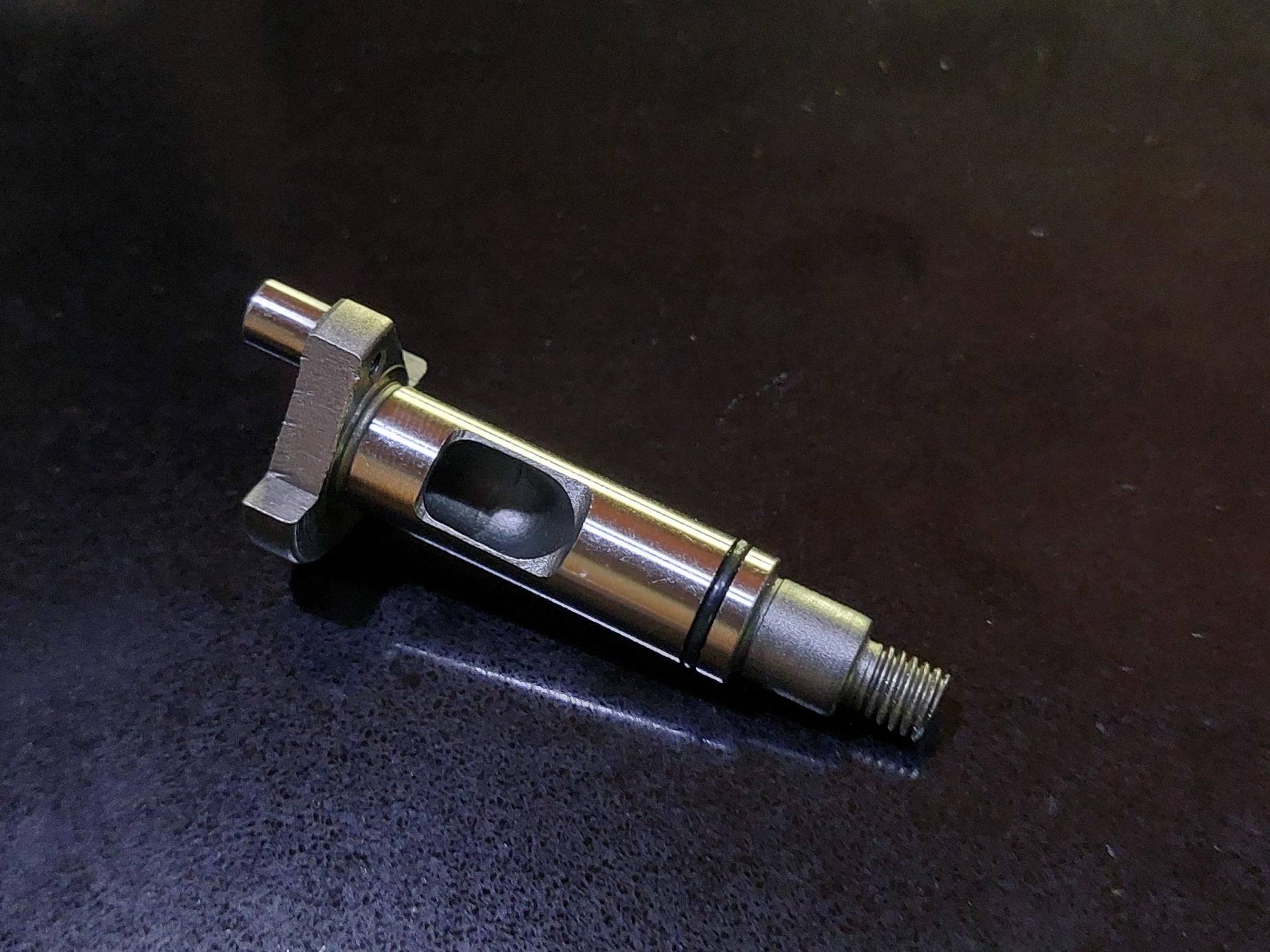

The internals look nicely made. The crank is fairly basic and looks very similar to the OS crank. It also has an o-ring seal which seals against the front bearing. The sleeve is ABC construction and features 3 ports. The piston and rod look well constructed. Funnily enough it looks a lot like a smaller version of the Force .21 engines. It should be a pretty good performer.

Normally you'd cut the crank with a sandwich bag while the engine is assembled but I decided to cut it while out. I have a few Associated cut off nuts somewhere but do you think I could find them? I ended up using a dubro collar that fit quite well. To be honest you don't need a cut-off nut if you know what you're doing, just be careful you don't cut it too short.
I put tape around it just to protect it, I always touch up the cut end with a linishing belt to make it appear a little nicer.
