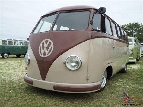

If current scanning technology isn't yet good enough to go directly to the printer, might it be good enough to provide lines, control points, contours, etc. necessary to CAD model for instance, the cab portion of this VW bus from the 1950's?
Is it possible to import the scan into say Fusion360 and use it like a buck to create a reasonably accurate surface model?
I have no experience with the process so I'm asking.

Yes it is possible to import scans directly in Fusion360... but it's clearly difficult to deal with them : a mesh resulting of a scan is a set of unorganized polygons and it is very heavy to use. Just to give you some idea of what it represent, take a stl of a part defined in parametric and import the mesh in Fusion360 : it is way more difficult than to work with a step (and as opposed to a scan result it is relatively organized).
You maybe able to use the scan to create a set of reference points on different plans (I did it with the Manx TT 1/8 bodyshell), but it was painfull and long.
Another thing I did was to use a scan to print a driver figure. In resin print, as you move the printed part out of the build plate and support, it mostly work. Saddly, to original plan surface is not plan on the scan, and it results in some adhesion difficulties to print it on a FDM printer (and yes, you can always do a cut to get it print, but that says long about scan precision).
Ultimately, Fusion360 is not suitable to work with mesh, and it's probably better to work with Blender or some other tools in this case, but the assembly with a parametric object will be the issue...
So theorically you think about something simple, but it's not that simple yet. And as precision of scans increase, it also increase the number of polygons you get from the scan... making it even more difficult to manage.
At end :
- for anything geometric : eyes + caliper + brain/knowledge and parametric remains the way to go
- for anything organic, maybe of use, but may require quite a good knowledge to be able to work it
Additional note : on Tamiyabase, there is one guy who is former game developer, and he did some bodyshells based on original 3D models used in games (and some of them are available out there). That might be something to research about, because most of the modelisation is already done in this case...
