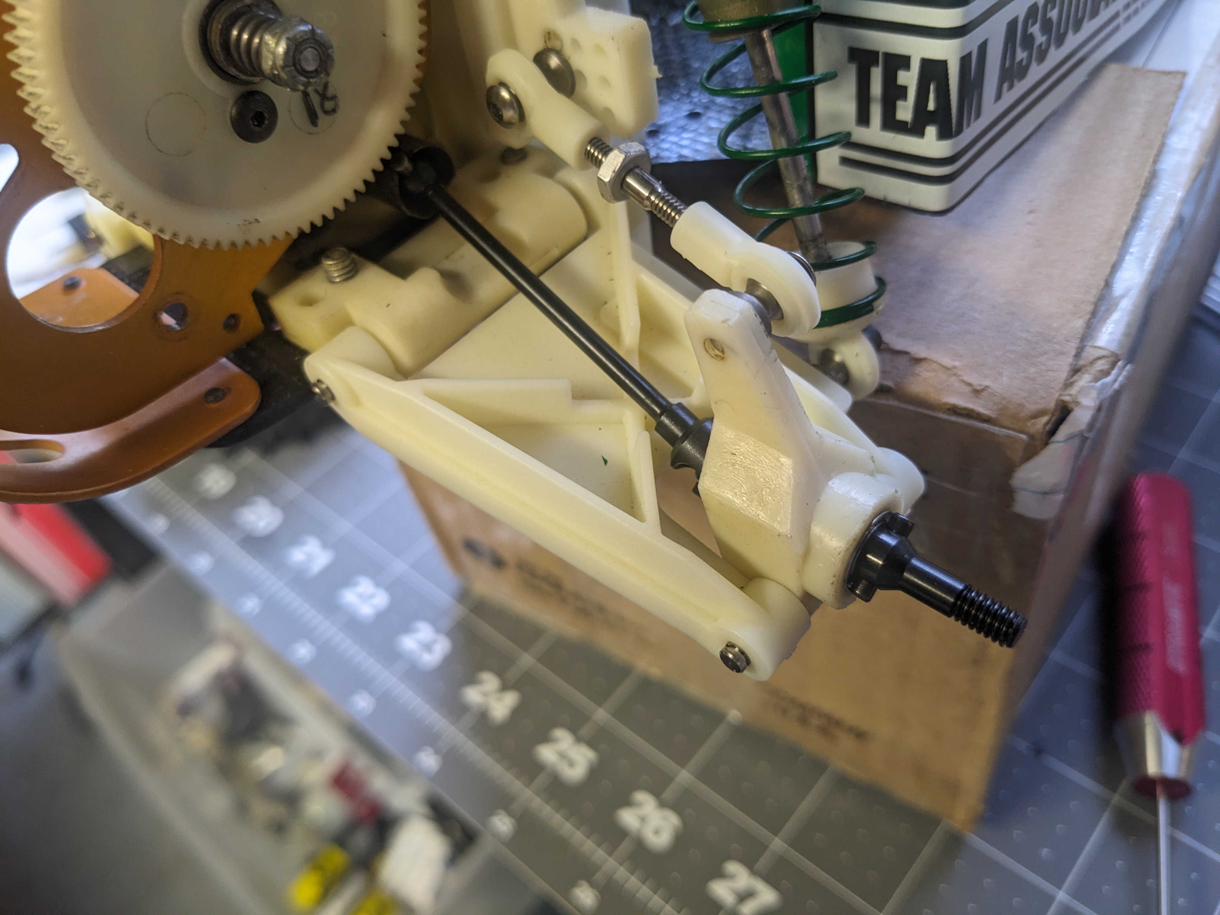

I have heard there is an issue with the rear drive axles popping out on the Team, T, and other reissues.
Is there a good fix for this? I know some will say AE needs to replace some things or make available stuff but I am probably going to start working on the 4wd kit this week and the Team and T kits shortly after and would like to have a fix in hand while building these kits.

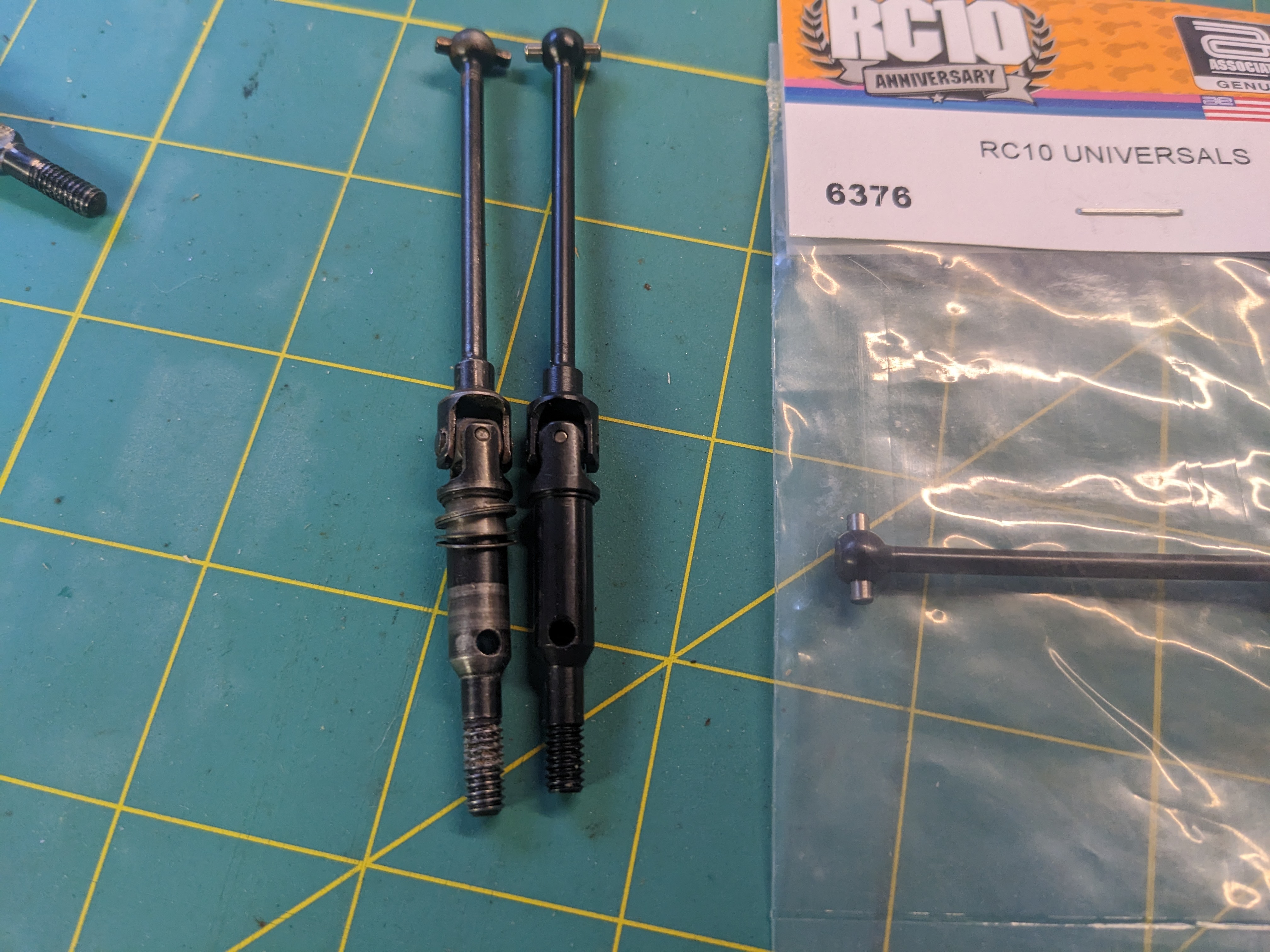

I decided to look at my only 1/4" axle universal equipped RC10 OG graphite and compare to the new universals offered by AE. AS you can see in the pics, the location of the drive pin is shorter than the OG dogbone length and where it would ride against inner bearing is the same. Putting it on the RC10 Masami Graphite, I used non flanged outer, with keeping the flanged bearing on inner. Normally its flanged inner and outer, using 5 shims on inside.
My shocks are 1.32, although I dont know/remember if I used 1.02 shafts. (more than likely I did as that was the setup)

Ronbo wrote: Mon Mar 17, 2025 6:00 pm I decided to look at my only 1/4" axle universal equipped RC10 OG graphite and compare to the new universals offered by AE. AS you can see in the pics, the location of the drive pin is shorter than the OG dogbone length and where it would ride against inner bearing is the same. Putting it on the RC10 Masami Graphite, I used non flanged outer, with keeping the flanged bearing on inner. Normally its flanged inner and outer, using 5 shims on inside.
Would you happen to have a set of the new MIP CVD’s to compare to the other two you posted?

I wish I did, but since they are out of stock, same with FAN RC, I cannot right now. All I have currently is new MIP RC10T and DS NIP. As well as only 1 set of shiny CVD in my Re RE RC10T. The rest are for B3/4 and OG RC10s are dogbones.

To update my previous finding, this setup would appear to only work on the OG rear carriers. The inside is chamfered/narrowed on inside, thus only letting the unflanged bearing go so far into the carrier. The new black NIP AE carriers I have are not chamfered/narrowed on inside, thus allowing the bearing to push in. The new style RC10T carriers have a step to contain flanged/non flanged bearing and would probably be a better setup to use in order to use the bearings to shim... my opinion only
