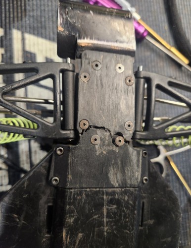

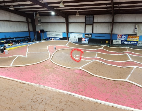

Well...the car was good while it was in one piece. This new track layout is all tight corners and doubles, it's flowy once you get the rhythm. Tried to land a little closer to the inside of the middle corner and dropped the left rear into a weird outcropping of pipe and, just that sound. So.....and few new parts are required, sadly and I just raced my sons T2.4 in the stadium truck class for the rest of the day-

Man that's a tough break. Might be time for this https://www.dragonpunchrc.com/product-page/losi-xx-xxcr-xxt-rear-pivot-plate

I ordered two PA66 versions from the track lol. Fortunately it was rhe case that came with the buggy that already had spme cracks

The familiar sound of snapped plastic...
Let us know how the Dragonpunch parts work out.

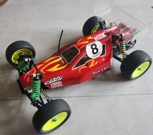

Rattle canned a new shell, want to see if there is any handling difference on track between the standard CR shell and the Xxellerator shell. Came out pretty good

Great looking paint scheme 8)

Charlie don't surf wrote: Sat Apr 19, 2025 7:34 pm Rattle canned a new shell, want to see if there is any handling difference on track between the standard CR shell and the Xxellerator shell. Came out pretty good
looks really good especially for rattle cans!

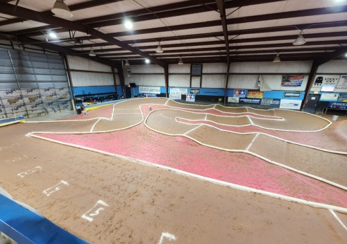

Track day report-
Buggy wasn't bad, had some issues with the 25* castor blocks making the car tight in the center of the corners and slow to release the rear end so I could square up for the 3 sets of doubles. I would normally increase the rear tie rod length to get more rotation, but I'm limited by the 2 hole CR hub carriers. Swapped to 30* castor and added a front wing and it improved.
The B2 was 12.4 sec laps, the XX was 12.9...so I still have work to do lol. The B2 has more low speed steering right now, and the XX is way more high speed steering.
