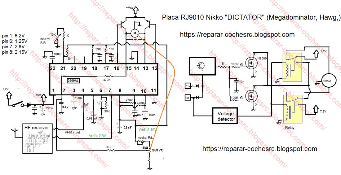

I am going to guess that it is the motor driving circuit.
I found this excellent Spanish language website
https://reparar-cochesrc.blogspot.com/p/averias-y-preguntas-frecuentes.html
This page is devoted to older toy grade RC and how each component works. I found this schematic on the page
I was going to guess that the relay was bad, they seems to be working, switching between forward and reverse. So maybe the circuit that drives the relay in having this issue?
The circuit was also shown this way( or this may be from a different board)
the relay is described as
On the electronic plate of the Dictator, the two relays are type H500S03-2-C or MR301-3HS with 3 volt coil and resistance of 25 ohms. The coils are in parallel, so if we measure on the plate it would be about 12.5 ohms. There is a transient suppression diode in parallel with the coils.

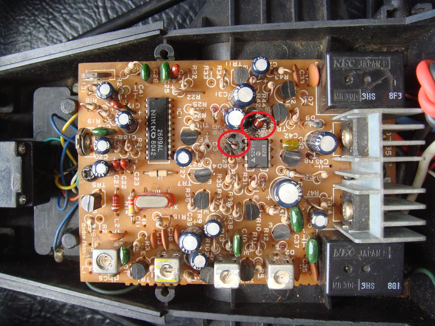

I found an image online of a golder arrow receiver board
showing the NEC MR301-3HS relay.

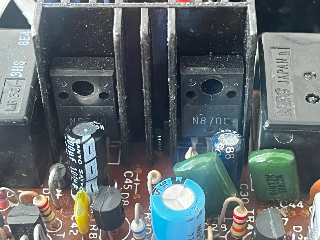

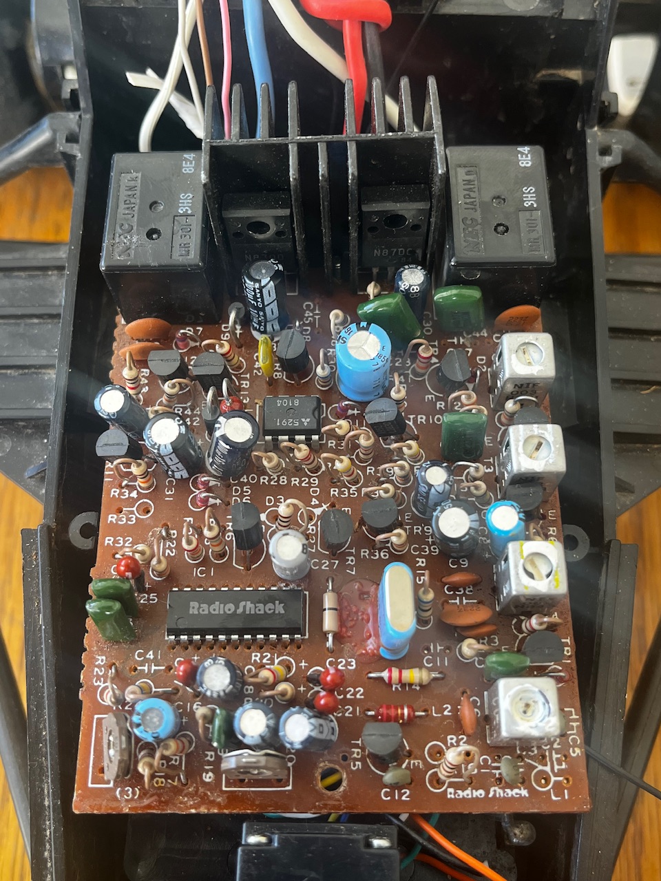

Thought I would see if I can make this work.
I think the buz11a fets I got for my Novak repairs might work to replace the ones on the board. I also found some cheap relays that look like that may work.

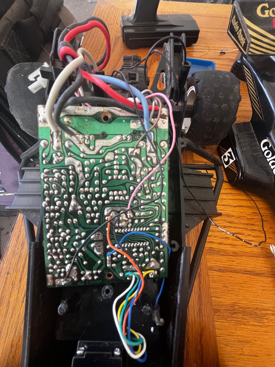

I’m taking some photos in case I break a wire off the board
Wire
Black - antenna
Pink -power switch
Brown- power switch
Orange- servo
Black - servo
White- aa battery box to power switch
Blue- aa battery box to board
Green -servo
White -servo
Blue-servo
Yellow- servo
Thick
Blue-motor
White-motor
Black -battery
Black-shunt wire between relays
Red battery

Someone on the internet had the same trouble as me on
https://forum.digikey.com/t/nec-n8700-to-220-transistor-cross/7978/6
They used this one and reported getting the device to work.
I’ll see how much that overlaps with the devices I have.
First going to test the device again before I tear it down and make sure it’s not working

Looking at the bottom of the circuit board there is an obviously broken trace near the motor white wire on the board
TRX-1-3
Posts: 2079
Has thanked: 2090 times
Been thanked: 1005 times
Re: Joe's Broken Golden Arrow
Post by TRX-1-3 »
JosephS wrote: Wed May 07, 2025 7:09 pm Looking at the bottom of the circuit board there is an obviously broken trace near the motor white wire on the board
Can broken traces be repaired?
Posts: 3825
Has thanked: 2620 times
Been thanked: 2990 times
TRX-1-3 wrote: Fri May 09, 2025 8:50 am
A wire could be soldered to each side as a jumper to bridge offer the damaged area.
1911Colt
Posts: 1299
Has thanked: 1791 times
Been thanked: 868 times
Post by 1911Colt »
I would cut away the bits of trace that have lifted off the board, and run a wire from the solder connections on either side of the break.

1911Colt wrote: Fri May 09, 2025 10:22 am I would cut away the bits of trace that have lifted off the board, and run a wire from the solder connections on either side of the break.
I just found 2 components that were on the trace a a soldered a small wire between them.
That didn’t work. I pulled the board from the car and will replace with some general purpose hobby gear.
