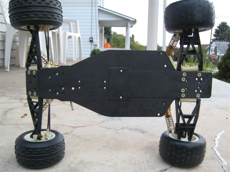

oh lord... forgive me for taking thy dremel to thy brand new andy's molded truck chassis. :lol:

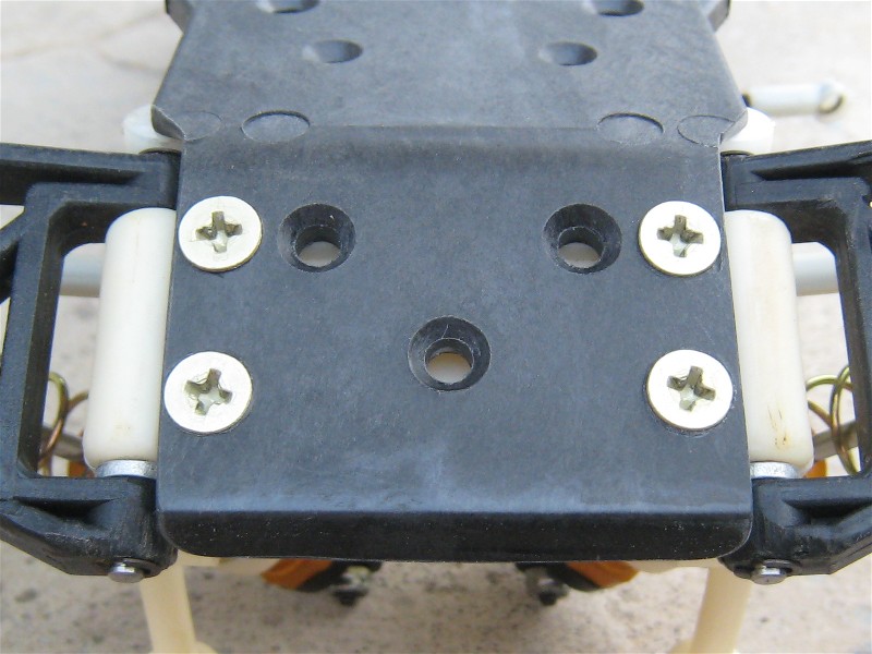

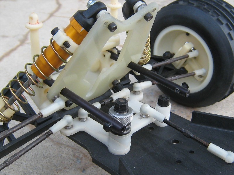

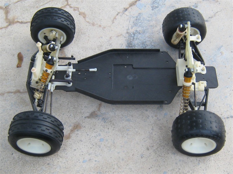

i was staring at it last night and thought, ya know what? this could make a cool rc10t chassis. the length is already there (actually a tad TOO long). so i cut, drilled, and countersunk the front kickup to 10t/worlds status. i also had to drill and countersink the holes for the steering bellcrank further to the rear, since the provided holes are for either the andy's slider bellcrank, or any designed to fit the rc10 buggy. and while i was at it, it drilled it for a stealth trans, too. eventually when i get them, i want to put the older gt cast nose brace tube mounts on it, and i also need to get a set of c.c. 10t bellcranks, since the stock ones don't work right using this chassis.
i kinda think this is gonna be 2009 V-nats truck class entry when it's all done. :)

sweet, i always wanted to do that if i ever found one. i was worried about how rigid the rear half of the chasis is just behind the spot where the side ribs stop. does it flex at all around that area with all that truck suspension hanging on it ? now get out the 3m panelbond and fill in thoes 3 unsightly holes under the front bulkhead.

the chassis does flex, but it's not horrible. once the trans is in as well as the trans brace it'll be better. i don't know if you've ever seen one in person, but these chassis' are pretty thick.... which helps.

MikeyD wrote:Are these the bellcranks you need?
yep, those are the ones. when i have the extra cash, i'll be picking up a set. the stock bellcranks don't work because there's no noseplate for the factory screws to tighten to, and the chassis is too thick to be able to use a nut. so, the ones from c.c. are pretty much my only option.

How do you get all the screw holes for the front nose right?

i just use a 10t noseplate/bulkhead as a template.

What about using thin nuts like these:
http://www.rcplanet.com/Associated_Plain_Nuts_p/asc8182.htm
They are not much thicker than the thick aluminum washers used under the stock bellcranks. I've used thise on cars where the noseplate treads are stripped and it seems to work fine clearance wise.

the 10t nosplate screws are only threaded enough to catch the noseplate. the rest of it is smooth, except for the very top. that has a 4-40 thread for the nut to hold the bellcranks on. with how thick these chassis' are, the 8-32 threads don't even come out of the chassis. i'd have to drill about 1/2 of the chassis' thickness away, then countersink the hole for it to possibly work with the stock 10t bellcrank.
see what i mean with screws........... http://www3.towerhobbies.com/cgi-bin/wti0001p?&I=LX2928&P=SM

:oops: Forgot about that part. It uses the same system as the GT. You could always get a long 8-32 screw and chuck it in a lathe to turn it down to fit the steering arms with a longer amount of threads remaining at the bottom, but that would probably be more work than just buying the CC setup.

just for the aftermarket flavor, i'm gonna go with the c.c. setup when i do the "real build-up". i just ripped apart my original 10t for now just to kinda mock it up. i want to put my original back together. this andy's chassis will most likely end up with all black parts..... rpm arms, 2.65 trans conversion, rpm 10t rear bulkhead. and some c.c. shock towers to go along with the c.c. bellcrank.
