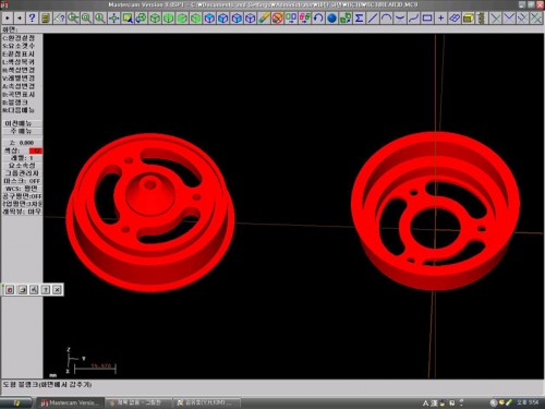

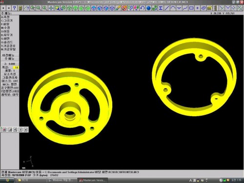

3D design finished.
went to almost complete jelly bean wheels except the plastic rings. 2-piece 2.1" front wheels need the plastic rings from #6854. the tape trick from yokomo would be useful for 2.2" tires. I tried old 2.1" and recent 2.2" tires. and, got no issue. :D
the rear wheels are 2.2". found right material samples to be milled, chopped and turn to be the rings holding tires. I didn't make a same choice on the front ones to save time and money.
rear
rear
front
front

I don't have any 2.2" buggy tires to look at myself, but before you go ahead with making these wheels I would suggest you look at some tires first to make sure they will work with the inner rings.
The reason I say this is I tried to put 2.2" Truck tires on an old set of 3-piece wheels and they would not fit. The truck tires I wanted to use (j-concepts, and panther brands) did not have a squared transition/lip from the bead to the sidewall, there were ribs running radially for reinforcement. If the 2.2" buggy tires have the same ribs it is unlikely that they will fit onto 3-piece wheels as there is no place for the rings to seat.
Bugle
Posts: 465
Joined: Fri Aug 24, 2007 11:40 pm
Location: Sydney Australia
Re: making alloy rims - need opinions - Pics UPDATE
Post by Bugle »
If the ring doesn't work with some tyres you could just glue it taking care to sit the tyre bead right to the outsides of the rim.
What grade alloy were the optima ones? I used 2011-T3, it's slightly stronger than 6061-T6 but doesn't anodise as well.. 7075-T6 would be overkill but could make it a bit lighter, hate to think how much that would cost!

Bugle wrote:If the ring doesn't work with some tyres you could just glue it taking care to sit the tyre bead right to the outsides of the rim.
7075 for this project. it's pricy here too. and 7075 for optima wheels he said. I just made a phone call and got this answer. I had worng information on optima's.
